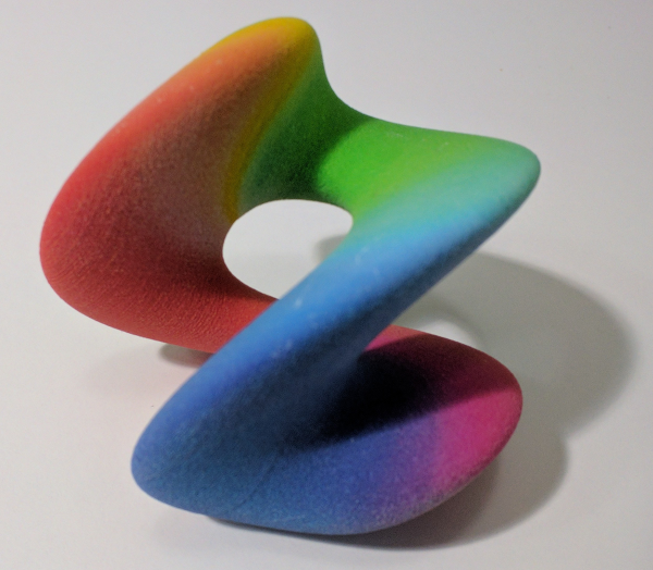

Colour or Support only makes sense for a multi head 3D printer.
I think you are talking about consumer grade FDM printers, which do
multi-colour prints by switching between different coloured filaments. But
if you use a service provider like ShapeWays for printing, then there are
multiple technologies for full colour printing, where you have full CMYK
control over the colour at each print position.
I dunno, maybe this is considered out of scope for OpenSCAD. One of the
reasons I created my own OpenSCAD-like language was to do full colour
printing like this. For output, I use file formats that support vertex
colouring (where you specify a separate colour for each vertex in the
model). 3MF is one of the file formats that supports vertex colouring.
Here's an example of a print that I created using Curv, exported as
coloured vertexes, and printed using Shapeways:
