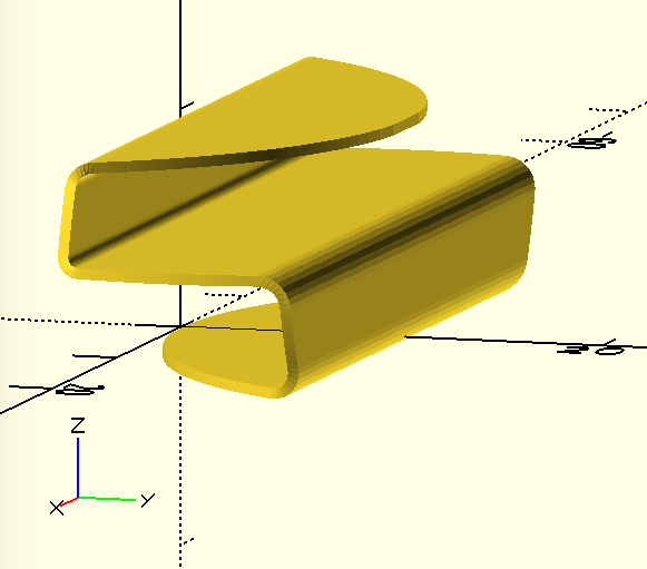

Here's the basic building block that I would start with:
// Folds along the Y axis, leaving stuff in -X on the XY plane
// and folding stuff in +X up.
// Object to be folded must fit inside a "big" cube centered at the origin.
module foldy(angle, big=[1000,1000,10]) {
        translate([-big.x/2, -big.y/2, -big.z/2])
            cube([big.x/2, big.y, big.z]);
    rotate([0,-angle,0]) intersection() {
        translate([0, -big.y/2, -big.z/2])
foldy(30) {
    cube([20,20,1], center=true);
That folds along one specific line - the Y axis - but can be generalized
by translating and rotating the object into place, and then rotating and
translating it back to its original location.
translate([5,5,0]) rotate(45) {
    foldy(30) {
        rotate(-45) translate([-5,-5,0])
But, as nophead points out, you probably really want some kind of
radiusing at the corner, and that makes it significantly more
complicated to do in a general way.

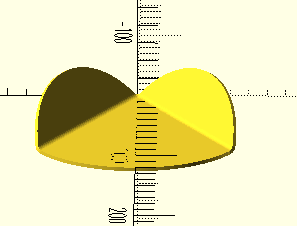

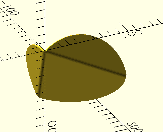

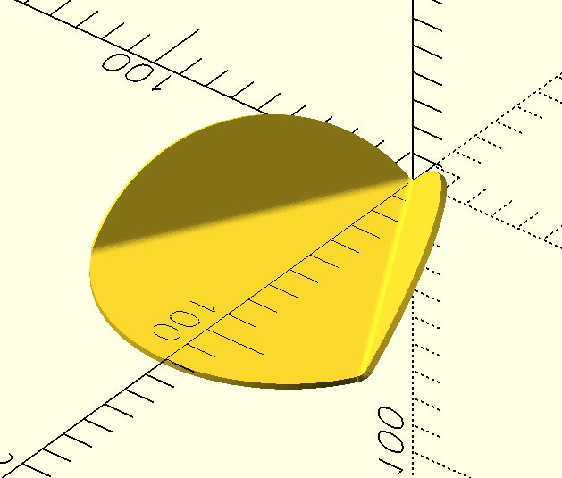

Thu, Nov 27, 2025 2:04 AM
Is this what you want to do?
[image: Screenshot 2025-11-27 at 7.30.59 AM.png]
[image: Screenshot 2025-11-27 at 7.31.35 AM.png]
[image: Screenshot 2025-11-27 at 7.32.10 AM.png]

Jordan:
Thanks for helping me think about this.
Once I sent the "2D" message, I realized that I really wanted to do it
with 3D objects, but thin ones.  Conceptually 2D, but actually 3D.
This is what I came up with to make the fold.  Crude and ugly, but my
customer needs glasses, so all is good.
I can imagine a general library to do things like this, but I am sure
that there are people on this list who are more sophisticated than I am
eps = 0.01;
slop = 0.2;
$fa = 3;
$fs = 0.2;
inches = 25.4;
// ball diameters
bd25 = 25.3 + slop;
an  = 27;                // angle from vertical to surface of bowl
ct  = 4;        // circle thickness
cd  = 130 - 6;    // circle diameter
cr  = cd/2;        // circle radius
cwa = 52;        // fold angle for circle wings
ca  = 67;        // angle between the wings
ca2 = ca/2;        // half angle between wings
module Circle(d2Fac)
// d2Fac is 1 for regular cylinder, 0.8 for sharp edges for the wings
cylinder(h = ct, d1 = cd, d2 = d2Fac*cd);
module Vee() {
// the vee
// the circle
translate([0, cr, 0])
Circle(1);
// trim off where the wings will be
translate([0, 0, -eps])
rotate([0, 0, -ca2])
cube([200, 200, ct + 2eps]);
rotate([0, 0, 90 + ca2])
eps]);
// flap
// rotated back into place
// rotated up in the air
rotate([0, -cwa, 0])
// rotated so fold is along Y axis
rotate([0, 0, ca2])
// the flap
Circle(0.8);
cube([200, 200, ct + 2*eps]);
Vee();

OK just in case you want to download the model i made:
Here is the python code:
from openscad4 import *
a=translate_2d([0,60.01],circle(60,s=300))
a1=h_lines_sec(a,200)
a1=[ equidistant_path(p,200) for p in a1]
l1=rot2d(60,[[0,0],[150,0]])
p0=[0,60]
p1=line_section_ip(flip(l1),a)[0]
d=vsint1(l1,p0)
l2=cr3dt([[0,0,0],[0,90,0,3],rot('x60',[0,100,0])],10)
b=[wrap_around(p,l2) for p in a1]
b1=axis_rot_1(c23(b),[0,0,1],c23(p1),-60)
b2=[wrap_around(p,l2) for p in b1]
s1=axis_rot_1(b2,[0,0,1],c23(p1),60)
s1=axis_rot_1(s1,line_as_axis(c23(l1)),[0,0,0],-60)
s2=surface_offset(s1,2)
sol=solid_from_2surfaces(s1,s2)
sol1=axis_rot_1(sol,[0,0,1],c23(p0),-120)
fo(f'''
{swp(sol1)}
download the scad file from here:
https://github.com/sprabhakar2006/openSCAD/blob/main/fold_ex.scad

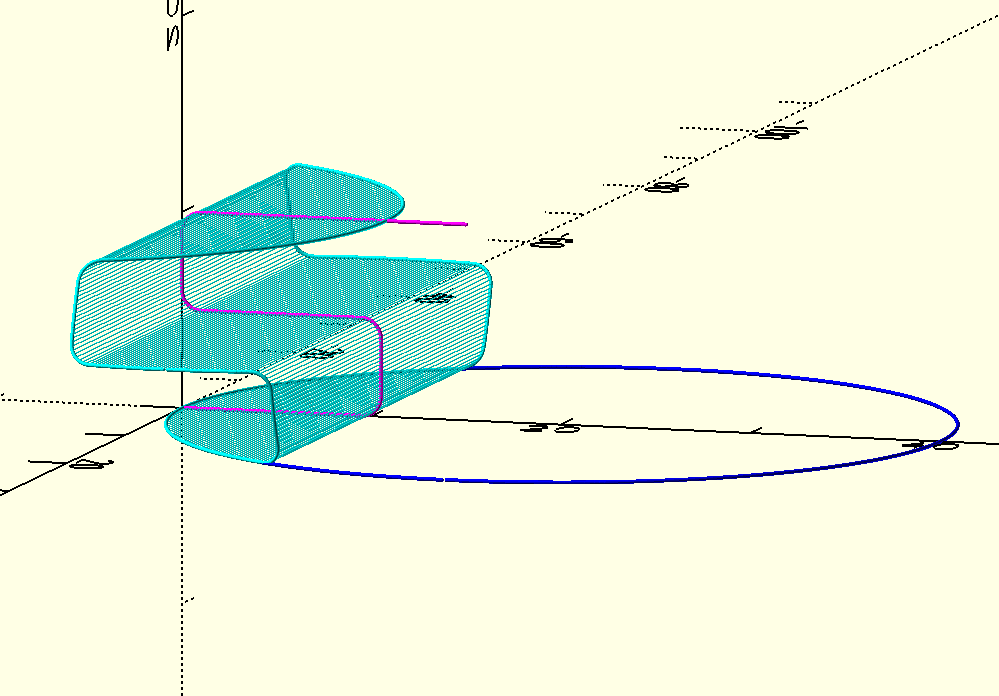

I have created a small video to show how the wrap_around function works.
Maybe of some interest to few here
https://youtu.be/u6sR2XT00i8?si=nouTHK2pWwhjt_VI

This example is slightly more interesting:
[image: Screenshot 2025-11-29 at 6.43.56 AM.png]
[image: Screenshot 2025-11-29 at 6.44.51 AM.png]
