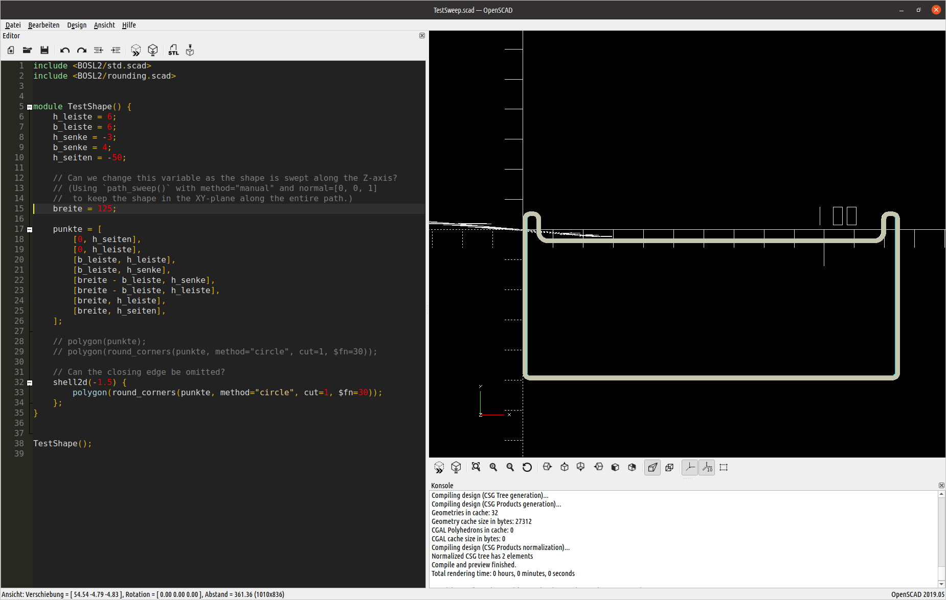

What I would like to do is extrude a 2D shape along the Z axis, as with linear_extrude() keeping the shape always parallel to the XY plane, but also change its shape and move it along a smoothed path.
Please consider this example code, which can also be seen in the attached screenshot:

I think that I can move the shape along a smoothed path using path_sweep() with method="manual" and normal=[0, 0, 1], but how can I change it (i.e. the number breite in the code) as it is extruded?
Also, please see the question about the closing edge in the comment above. Using stroke() comes into mind, but it doesn't seem to the be right solution to me, as I need an inside shell rather than a stroked polygon.

In order to extrude a shape that changes arbitrarily you must use skin(). It
takes a list of shapes and links them together. To do this you need to keep
your shape as a list of points rather than turning it into geometry, so
shell2d and polygon won't work here. Stroke is actually the right way to do
what you want in 2d, but I think you need to use the offset_stroke version
because it can control the direction of the offset. You would use it on the
original point list and it would give you the shape you need as geometry.
That would work for linear_extrude but can't be used as an input to skin().
To use skin() you'll need to construct your entire shape as coordinates.
Ideally you could still use offset_stroke to do this, but unfortunately it
is a module only and won't return its points. So you have to call the
offset() function (note, this is part of BOSL2, not the offset module that
is core OpenSCAD) and connect the result to the points you start with.
