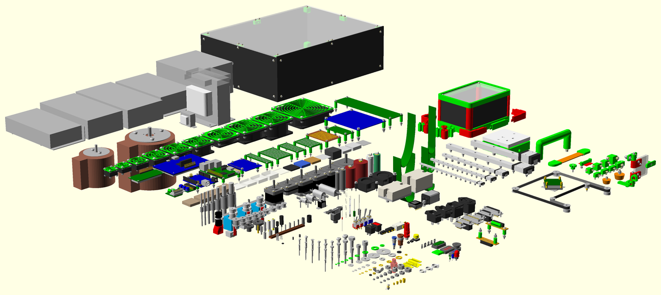

I developed a more general library from the vitamins and utilities I used
for Mendel90. I use it for all my projects in OpenSCAD. It generates, STL
files, renders of all the parts, bills of materials, assembly views, etc
and I am working on generating assembly instructions at the moment.
I will be releasing it on GitHub under GPL so I can publish complete
projects on my Blog, but it could be used as a library for other people's
projects. It has an ever growing collection of vitamins and modules to make
enclosures.
[image: libtest.png]

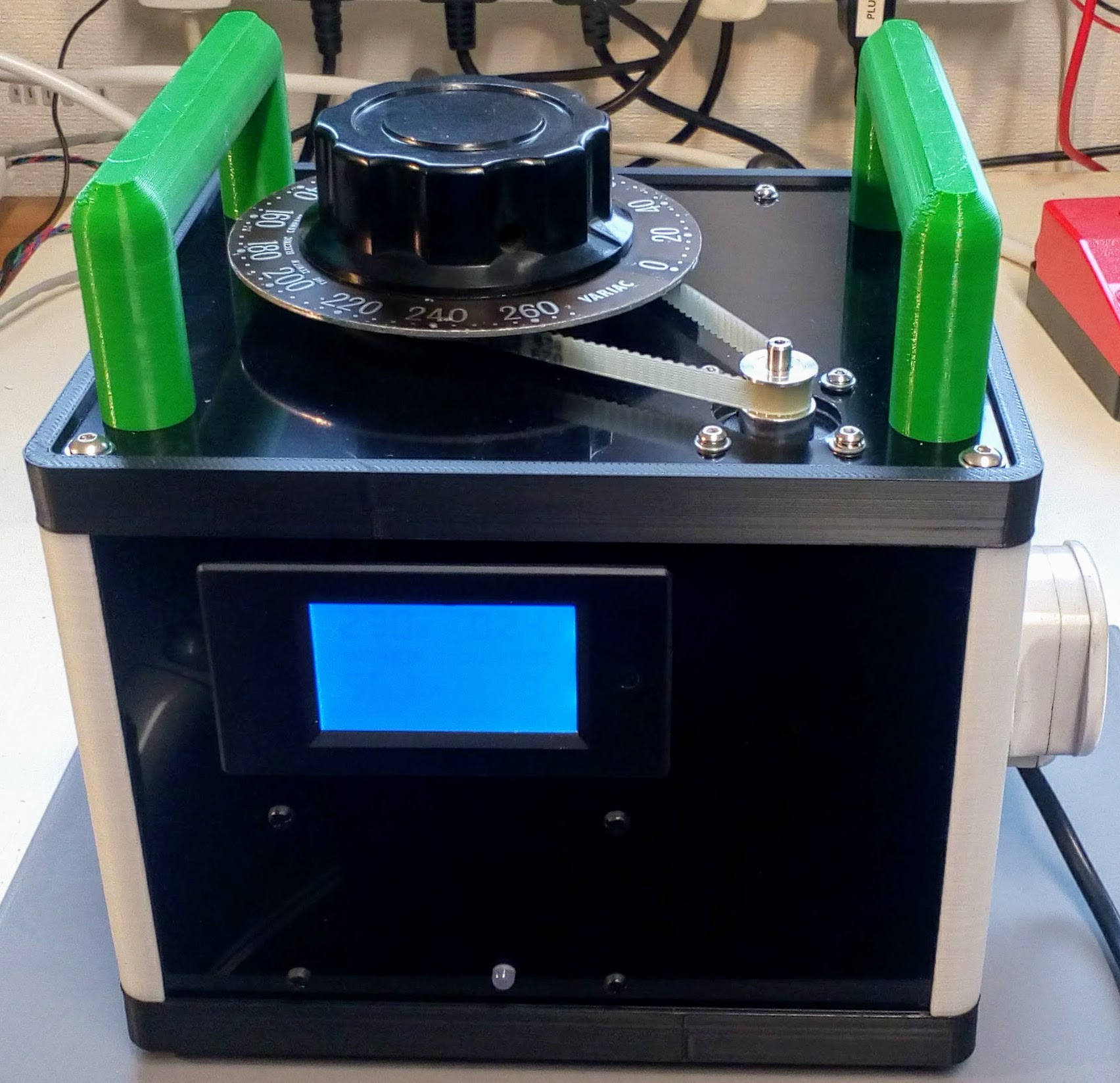

As well as 3D printers I make a lot of electronic bench instruments.
[image: IMG_20180424_163454.jpg]
