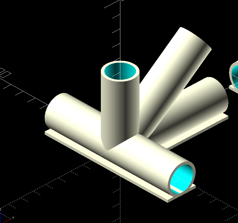

With the attached SCAD file, when I open Version 2021.01 and immediately
do F6, it runs fine:
Geometries in cache: 21
Geometry cache size in bytes: 246272
CGAL Polyhedrons in cache: 29
CGAL cache size in bytes: 80794856
Total rendering time: 0:01:53.682
Simple:        yes
Vertices:     7982
Halfedges:   24480
Edges:       12240
Halffacets:   8592
Facets:       4296
Volumes:        17
Rendering finished.
and looks like this:

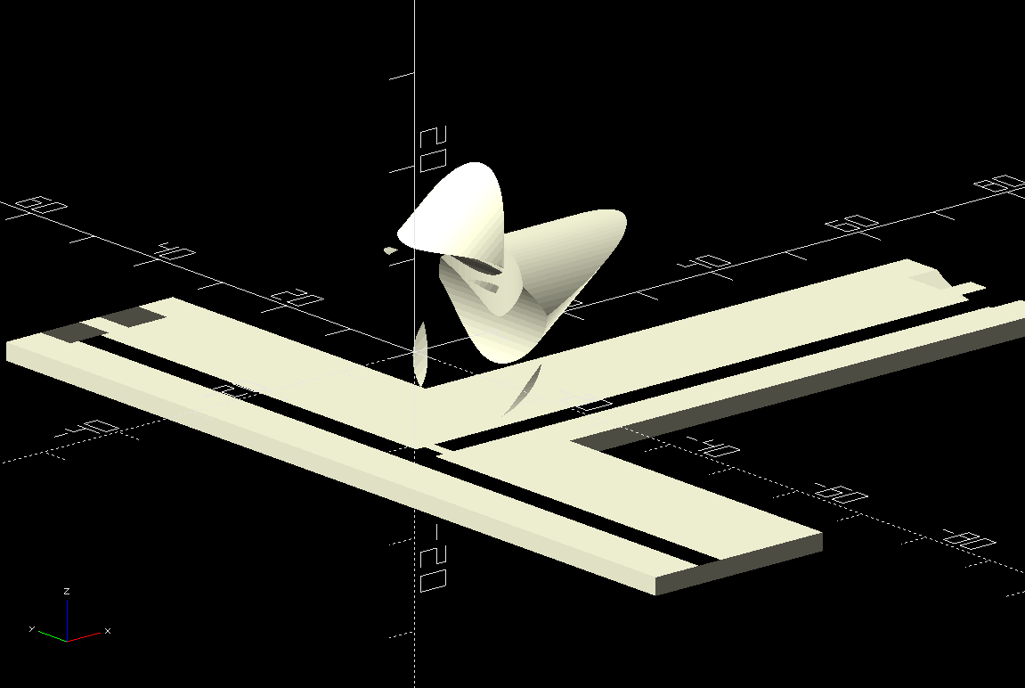

When I open version 2023.02.23 (git a23badf34) [with fast-csg and
fast-csg-trust-corefinement and lazy-unions checked] and immediately do
F6, I get this:
WARNING: Warning: mesh is not closed!
Geometries in cache: 22
Geometry cache size in bytes: 2222488
CGAL Polyhedrons in cache: 28
CGAL cache size in bytes: 11545512
Total rendering time: 0:02:52.772
Facets: 25812
Rendering finished.
And it looks like this:
do F6, I get this:
How is it with the fast-csg and lazy unions options turned off?

Fri, Mar 17, 2023 9:39 PM
works fine!
CGAL cache size in bytes: 79977704
Total rendering time: 0:01:06.915
Simple: yes
Vertices: 7830
Halfedges: 24024
Edges: 12012
Halffacets: 8440
Facets: 4220
Volumes: 17
Rendering finished.

Fri, Mar 17, 2023 9:55 PM
On 3/17/2023 2:39 PM, jon wrote:
works fine!
This suggests that the problem is with the fast-csg feature or the lazy
union feature.
I suggest that you:
  • Try each of the three options separately to see which one causes the
    problem.
  • Simplify the problematic OpenSCAD program as much as possible, to
    the minimum required to demonstrate the problem.  For instance,
    based on a quick skim it looks like "Everything" is not used in the
    case you're demonstrating, so delete it.  Then, does "Bottom" alone
    demonstrate the problem?  "Top" alone?  "Back" alone?  If so, delete
    everything else.  Et cetera.  It's usually possible to get a problem
    like this down to two or three primitives and a couple of other
    operations.
  • File a GitHub issue, supplying the simplified program and the exact
    OpenSCAD options that demonstrate the problem.  Additional
    information about variations that do not cause the problem, like
    turning a particular option on or off, or removing a component from
    the model, is also helpful.
Going through this exercise will both help to get somebody's attention
on the problem and may you to understand it so that you can work around
it or, in some cases, discover that it's actually a problem with your model.
In this particular case it does seem likely to be a bug, since the same
model works with some OpenSCAD options and not with others.
