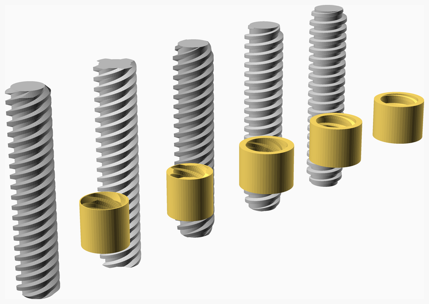

Hi everyone,
I'm currently working on some 3D-Objects that can be mounted on a PCB Chip.
So there is one component that has some sort of screw thread on it. How can
I achieve it? Is there more than one way to do it?
Thanks again God Bless

Consider one of the many OpenSCAD thread libraries on Thingiverse and other locations. One can specify metric or Imperial threads, inside or outside, lead-in and lead-out and other features.
Unless you like complex coding, the library route beats the ground-up method any day.

If you want a more generic spiral extrude, see this:
https://www.thingiverse.com/thing:1958354
There are a few others on Thingiverse with different features, but this one
is mine.
Unfortunately, there is no way to do this cleanly in OpenSCAD, and until
someone implements it directly in OpenSCAD, or OpenSCAD gives access to the
lists of points of an object, all of these things can at best be
approximations.

Not sure why threads are any more approximations than anything in OpenSCAD.
I.e. there are no true curves, all straight line approximations, but you
can have as many facets as you want to make them look smooth. See
https://github.com/nophead/NopSCADlib#Thread
