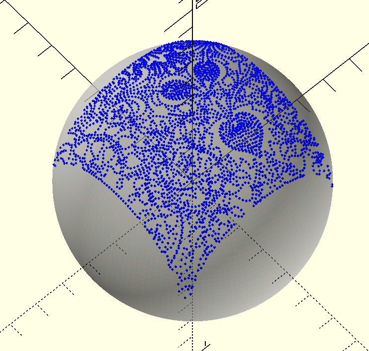

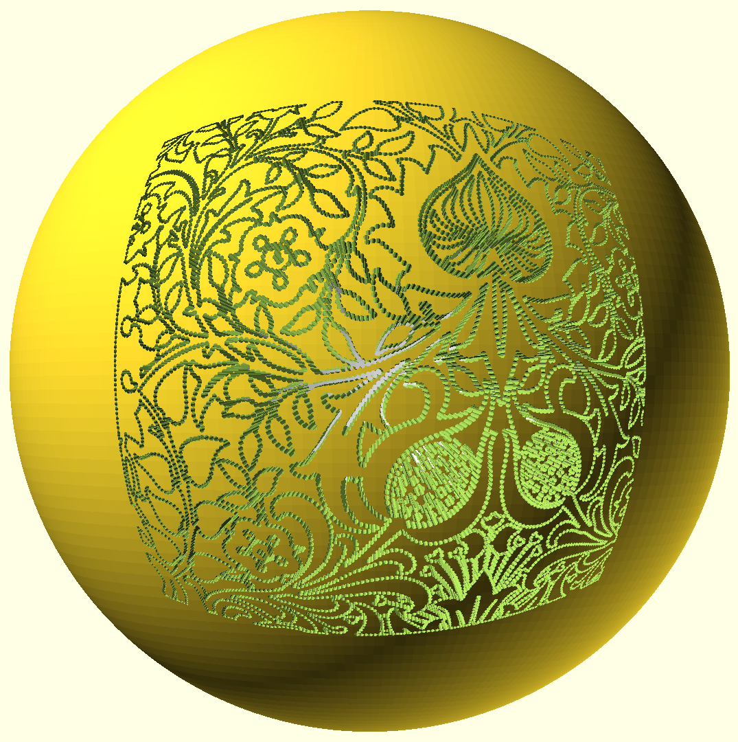

tried it today once again, just to cover a larger area of sphere:
file can be downloaded from here:
https://github.com/sprabhakar2006/openSCAD/blob/main/points_on_sphere_rev1.scad
[image: Screenshot 2024-06-03 at 8.59.06 PM.png]
On Sun, 2 Jun 2024 at 06:16, Sanjeev Prabhakar sprabhakar2006@gmail.com
Main idea is to be able to find intersection points.
Straight lines upwards are drawn from each point and then the
intersection is found.

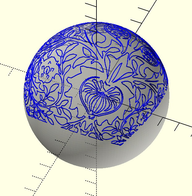

this makes a little more sense:
[image: Screenshot 2024-06-01 at 5.55.21 PM.png]

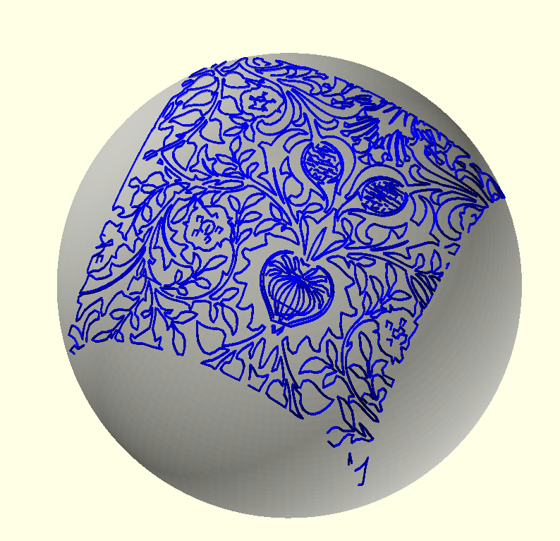

I tried this today:
https://github.com/sprabhakar2006/openSCAD/blob/main/points_on_sphere.scad
[image: Screenshot 2024-06-01 at 5.26.51 PM.png]

Depending on how you map a rectangular image to the surface of a sphere, it
may distort greatly.
If you want to be able to recreate the undistorted image in the projection,
you need to do what is called a "stereographic projection"
https://en.wikipedia.org/wiki/Stereographic_projection
There are a number of examples online of projecting grids from spheres
etc.
https://www.youtube.com/watch?v=uuewH450Nag
Note that the light source should be as close to an ideal "point
light" source, and that the projection is very sensitive to the exact
position of the light.

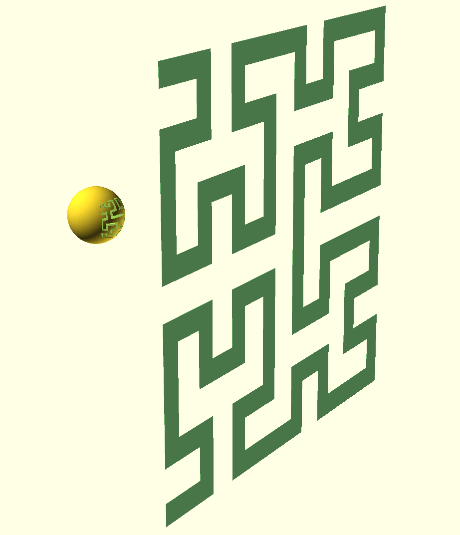

If the idea is to have a distorted image on the sphere that projects an
un-distorted image on a wall, one idea would be to assume a point light
source at the center of the sphere, project rays from there to each
pixel of the image on the wall, mathematically calculate the
intersection of the rays with the surface of the sphere, and punch holes
there. Then a point light source should project through the holes to
form the image on the wall. The clarity of the projected image might
vary because of quantum interference effects and limited transmission
efficiency, depending on the size of the holes and other factors.

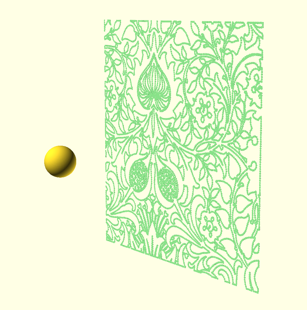

I wrote some code for this and have attached the interesting function
line_sphere_intersection(p1, p2, center, r).
For example:
The (idealized) result of projecting the phallus wallpaper from this
sphere would look like this:

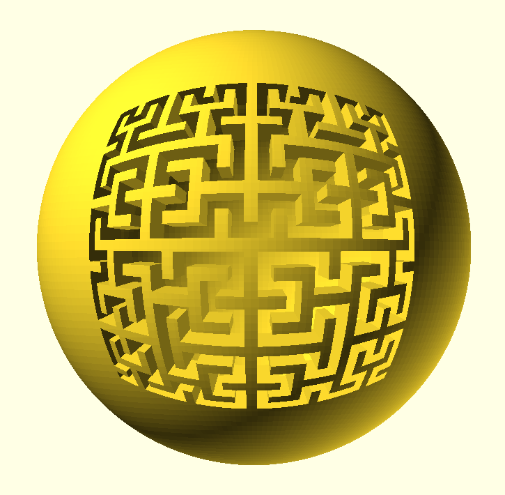

Unfortunately OpenSCAD F6 cannot render this sphere. It takes days or
weeks using CGAL, and with Manifold it quickly consumes gigabytes of
memory until the process gets killed (maybe it's a similar problem to
#5069 https://github.com/openscad/openscad/issues/5069?) It seems like
it would be really hard to 3D print anyway.
This one is simpler but maybe also hard to 3D print:
Manifold can handle it easily:
Regards,
