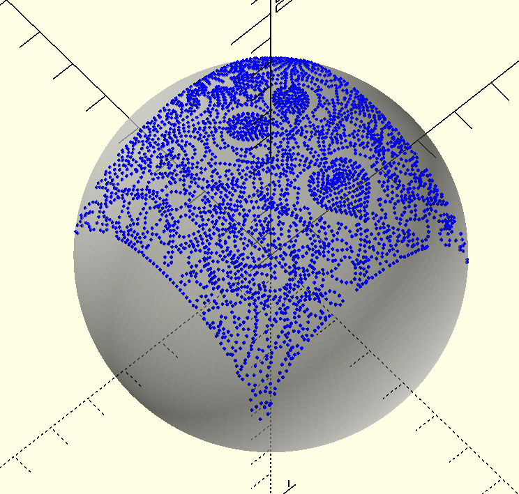

Sat, Jun 1, 2024 11:59 AM
I tried this today:
file can be downloaded from here:
https://github.com/sprabhakar2006/openSCAD/blob/main/points_on_sphere.scad
[image: Screenshot 2024-06-01 at 5.26.51 PM.png]

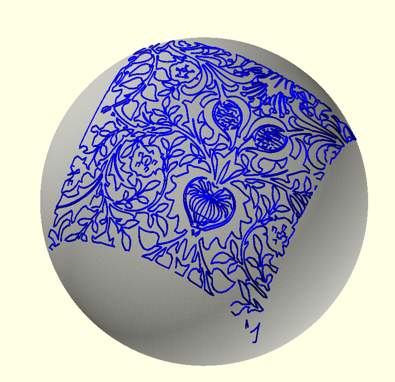

Sat, Jun 1, 2024 12:27 PM
this makes a little more sense:
[image: Screenshot 2024-06-01 at 5.55.21 PM.png]

Sat, Jun 1, 2024 8:53 PM
Instead of getting just coordinates, it would be interesting to learn, how
you map the coordinates onto the sphere.

Sun, Jun 2, 2024 12:46 AM
Main idea is to be able to find intersection points.
Straight lines upwards are drawn from each point and then the intersection
is found.

Sun, Jun 2, 2024 8:27 AM
That is what my earlier code snippet did, except my openscad would not
handle op's .SVG file. However, a more precise method would be to
'paint' the pattern on the walls and ceiling, position the led where you
want it, then ray-trace from that point to the pattern, and intersect
whatever shape of 'lamp shade' you wanted (figuratively speaking). I
can't do that in 'pure' openscad.

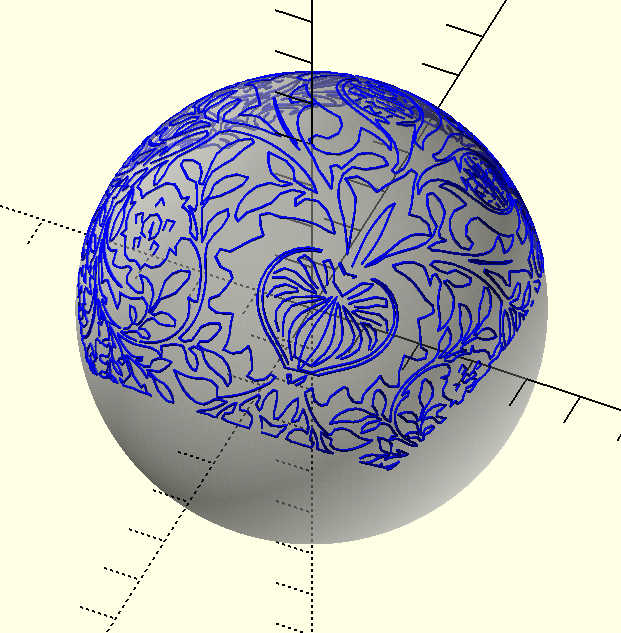

Mon, Jun 3, 2024 3:34 PM
tried it today once again, just to cover a larger area of sphere:
https://github.com/sprabhakar2006/openSCAD/blob/main/points_on_sphere_rev1.scad
[image: Screenshot 2024-06-03 at 8.59.06 PM.png]
