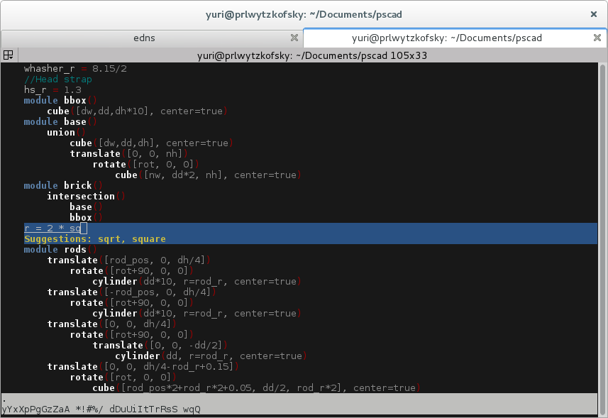

As a hobby project of mine in the last few weeks I made an alternative
editor for scad files. Its main goal is to allow for quicker model
building and to provide more context help. I made it to scratch my own
itch, but it is in a state that it might even be interesting for someone
else.
Especially if you are a terminal junky I think it can make you happy.
See attached file for a screenshot.

Its main features are:
  • automatically write file so OpenSCAD can monitor for changes and
    render live.
  • One key document tree editing (eg press 'I' to encapsulate current
    selection in 'intersection() {...})
  • Copy/paste mechanism
  • Undo/redo
  • syntax highlighting
  • formatting aid
  • (limited) syntax checking
  • Indentation as part of syntax
  • tab completion
  • VI inspired key combinations
future goals:
  • provide default arguments for various statements.
  • context help for arguments
  • help screen
non-goals:
  • Does not know about semantics (it can write silly scad files if you
    ask it to, but they will always be syntactically correct)
  • Does not mimic VI key combinations completely.
