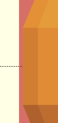

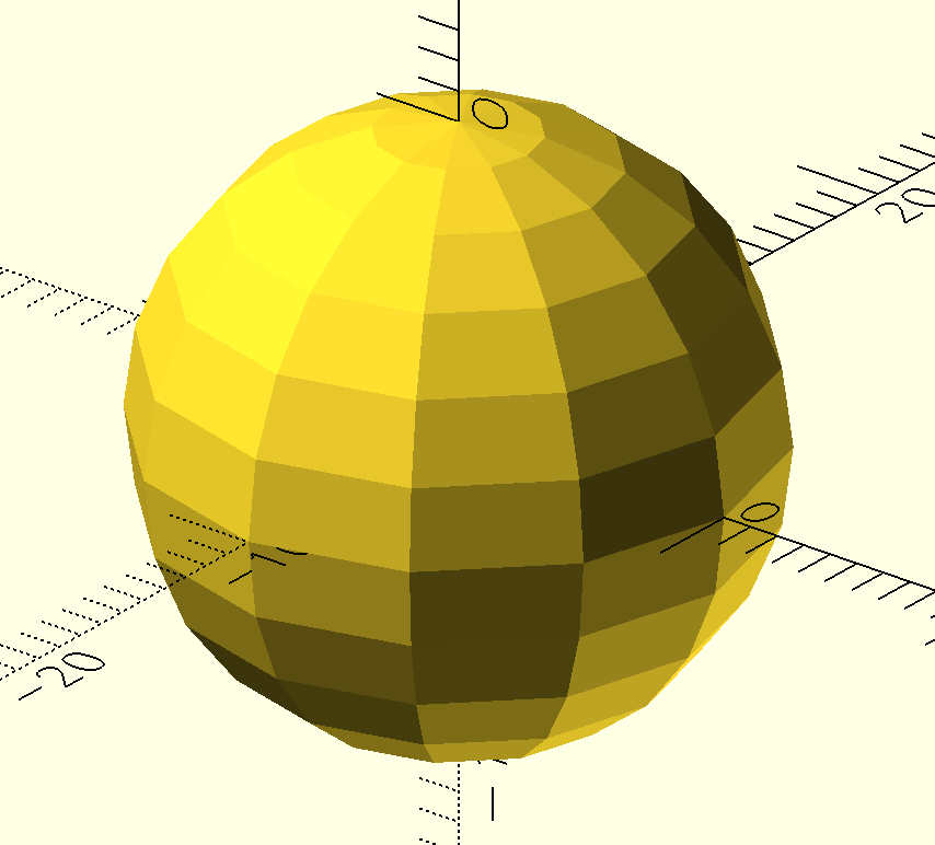

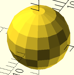

A picture is worth a thousand words.  These are deliberately fairly
low-poly to make the difference clear.
I think the "octa" spheres are just plain prettier, but they have
several technical advantages:

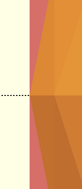

Vertexes at the poles.  Original-style spheres do not have vertexes at
the north and south poles, and usually do not have them at on the other
two axes either.  This means that their bounding box is rarely the
specified size, and that can sometimes be a problem.  It's subtle, but
look at this closeup of the left side of a sphere.  The pink is a
highlighted cube with its size the same as the sphere diameter.

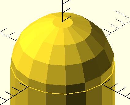

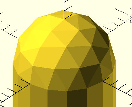

Axis-aligned great circles have the same vertexes as a circle or
cylinder of the same size and number of sides.  This means that you can
attach an octa sphere to a cylinder or other round thing, and everything
lines up.  In the original on the left, notice the little lip where the
sphere meets the cylinder, and how it isn't there with the octa sphere
on the right.  This works on all three axes.  (But note:  this is only
convenient with $fn, and maybe in the future with $fe, because octa
spheres always use a multiple of four sides, and the $fs/$fa
calculations don't so cylinders won't.)
