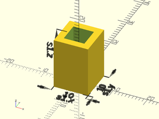

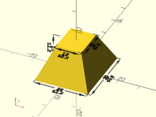

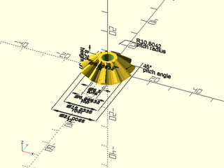

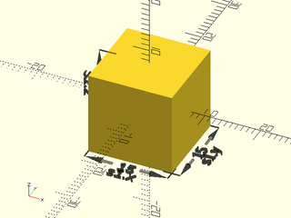

I had to construct exactly this for a large project, and work it into a
dimensioning module that leverages BOSL2's $parent_geom[1] to present
available dimensions for simple 3D primitives. For more complex shapes,
like custom gears, it can accept a structure-like element to produce
measurements that aren't managed (or really, exposed today) by BOSL2.
I was going to put it out as part of that project, but it probably would do
better as part of BOSL2, or at the least, as a standalone module library;
I'm largely indifferent which. Revar, if this is something you're
interested in, let's talk.
do better as part of BOSL2, or at the least, as a standalone module
library; I'm largely indifferent which. Revar, if this is something you're
[image: measure.png]
[image: measure_2.png]
[image: measure_4.png]
[image: measure_15.png]
[1]: probably not the safest thing to depend on, but it works for me
