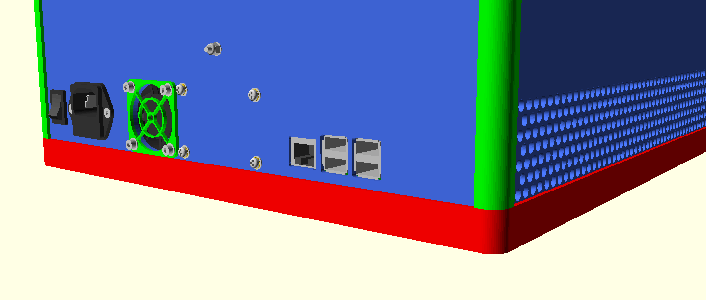

No it is work in progress at the moment. I am designing a 3D printer and a
separate library of vitamins and utilities that it uses. I only added PCBs
and the RPI model a few days ago.
If the printer works well I will publish it. I intend to use the library
for all my future OpenSCAD projects, so I will publish that separately.
On 15 February 2017 at 23:12, Rob Ward rl.ward@bigpond.com wrote:
Wow, really nice Pi project!!  Have you published the full project
anywhere??
Rob
On 15/02/17 23:26, nop head wrote:
Another DRY technique I use is my connector modules take a cutout flag.
When it is true instead of drawing the connector they define the shape of
the panel cutout needed for it to be panel mounted. I then have a
pcb_components module that either draws all the connectors in the correct
positions or produces all the cutouts that can be subtracted from a panel
or case. E.g.
