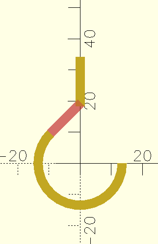

Here is a hook with a lower curved part and an upper straight part.  How
can I calculate the proper dimension/position of the middle connecting
part?  In this sample I visually positioned it by trial and error, but I
would like to learn how to calculate this.
Pure SCAD, or a pointer to other code that might solve the geometry
appreciated.  I am as interested in learning the general solution/principle
as I am in the practical solution to the problem.
// looped lower portion of hook
circle(d=30);
circle(d=24);
square(30);
rotate(45) square(30);
// visually drawn mid-portion of hook
#rotate(45) translate([0,12]) square([14,3]);
// straight upper portion of hook
translate([-3/2,18.25]) square([3,16]);

It is a tangent from a point to a circle.
https://en.wikipedia.org/wiki/Tangent_lines_to_circles

Probably best to work with points, and generate the polygon for the mid
section. You know the rh point at bottom of top piece ((3/2, 18.25) you
can use trig  (sin & cos) to get the inner point of the 45 degree cut.
You can calculate the length of the middle section, (Pythagoras?) and
the width will be 3. You can generate the four points for the middle
rectangle (or a square based on the calculated length and 3) and
calculate its position. ( you have already found the two points needed.
(atan2 and translate). You do not need the lh, bottom point of the upper
piece, (-3/2,18.25) since if you use that you will get a tapered middle
section, unless you do another calculation to get one of the corners of
the middle piece.
You could write a generic script, where you enter the width and radius
and length of straight section, and produce the shape in whatever size
you want, merely by adjusting those three values. (or set the width and
length as a function of the radius, and then you only need to enter the
radius)

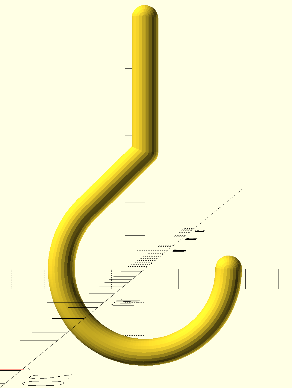

As it happens, I did exactly this a couple of years ago.  It looks like
I was planning to put it on Thingiverse but never got around to it,
because I commented extensively on the math involved, complete with
diagrams... though it looks like I didn't really re-read it, because
I'm not following it all that well today.  In particular, it doesn't
have an overall diagram of the object being created.  Ah well, take a
look, and if you need explanation we can figure it out together.
Here's what I was building:
And here's the program.  Note that the bottom part, pipe_polygon, is a
generic-ish sweep-oid module that would perhaps be better replaced by a
real sweep.

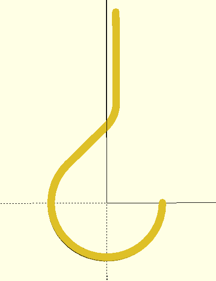

real sweep.

a = 60;
// The first 180 degrees is easy, and then we go another
// a degrees to complete the loop.
poly11 = circle(r, n=30, a=180+a);
// ... which ends at poly11end.
// Here's a diagram illustrating the trig that gets us there.
// Here's the first half of the curve:
// [-r, 0]    [0,0]
// v              v
//          r
// .    |    (a .
//    .  | .  r
//      poly11end
// Considering the right triangle between the [0,0], the end
// point, and the cross-point above the end point, and remembering
// that cosine is the adjacent side over the hypotenuse, the
// x-distance between [0,0] and the end point is rcos(a).
// (The x-distance between the start point and the end point is r
// minus that, or either r-r
cos(a) or r*(1-cos(a)).  We don't need
// that yet, but we will.)
// Remembering that sine is opposite over hypotenuse, the
// y-distance between the start and the end (the length of
// the vertical bar) is rsin(a).
poly11end = [-r
cos(a), -rsin(a)];
// Poly12 is the reverse curve (and the connection between
// poly11 and poly12 is the straight segment.  We know we
// want the reverse curve to end at x=0, and so remembering
// that this curve is symmetric with the curve above, and
// remembering the x-distance between the start and end of that
// curve, it starts at x = -r
(1-cos(a)).
// Now, what's the y distance between the poly11end and poly12start?
// Here's another diagram:
//        .a.
//        y.    .
//            x
// We know that the total x-distance between the start of the first
// curve and the end of the reverse curve is r.  We know that the
// x-distance for each curve is r*(1-cos(a)).  Thus the remaining
// x-distance that the straight segment must cover, x in the diagram
// above, is r-2r(1-cos(a)).
// Remembering that tangent is opposite over adjacent, or in this
// diagram x/y, and that we have x and want y, tan(a)=x/y, ytan(a)=x,
// y = x/tan(a).  Thus the y-distance of the straight segment is
// (r-2
r*(1-cos(a)))/tan(a).  We add that to the end of the previous
// curve to get the start of the reverse curve.
// (We don't actually use p12start.x, but what the heck, let's be
// complete.)
poly12start = [-r*(1-cos(a)), poly11end.y - (r-2r(1-cos(a)))/tan(a)];
// We know that the reverse curve ends at x=0, and we know that the
// y-distance of one of these curves is rsin(a), so here's the end
// point of the reverse curve.
poly12end = [0, poly12start.y - r
sin(a)];
// But... the circular arcs have their origin at the center of the
// circle, so we need to offset by r.
center12 = poly12end - [r, 0];
poly12 = translate(circle(r, n=30, a=-a, start=a), center12);
// And add on the vertical segment to reach the end point.
p13 = poly12end - [0, vertical];
poly13 = [p13];
// Here's the full line of the body of the hook:  The initial
// counter-clockwise curve, the clockwise curve to get back to
// vertical, and the final vertical segment.
poly1 = concat(poly11, poly12, poly13);
circle(d=30);
circle(d=24);
square(30);

I've ignored what has gone before, and have this, pretty well
parametric. Wrt a practical hook, then this design fails, it is merely
an example of stringing together a list of points to get a solid shape,
with some variation.
// Function to generate points on a circle's circumference
function pointcircle(d, a1, a2, s) = let(
    radius = d / 2,
    // Calculate the angular step and handle direction
    angle_diff = (a2 - a1 + (a2 >= a1 ? 0 : 360)),
    num_points = ceil(abs(angle_diff) / (360 / s))
) [for (i = [0 : num_points - 1])
    let(angle = a1 + i * angle_diff / (num_points - 1))
    [radius * cos(angle), radius * sin(angle), 0]
module pointshull(list){
  for(k=[0:1:len(list)-2]){
     hull(){
        translate(list[k])sphere(w/2);
        translate(list[k+1])sphere(w/2);
module shape(){
    round=pointcircle(diam,sa,ea,res);
    straight= [[0,es],[0,ss]];
      all= concat(straight,round);
      pointshull(all);
shape();
diam = 50;  // diam of 'hook'
sa = 135;   // start angle
ea = 0;     // end angle
res = 200;  // resolution for circle
ss = 35;    // start of straight
w = 8;      // diameter of 'wire'
es = ss+40; // end of straight
$fn = res/8;// smaller = quicker
If you want a square cross section, so you can easily fdm print, then do
it as 2d, and linear extrude. Using a $fn=4 or similar distorts the
cross section around the curve, since 'the cube' does not rotate as it
follows the path, so to speak.

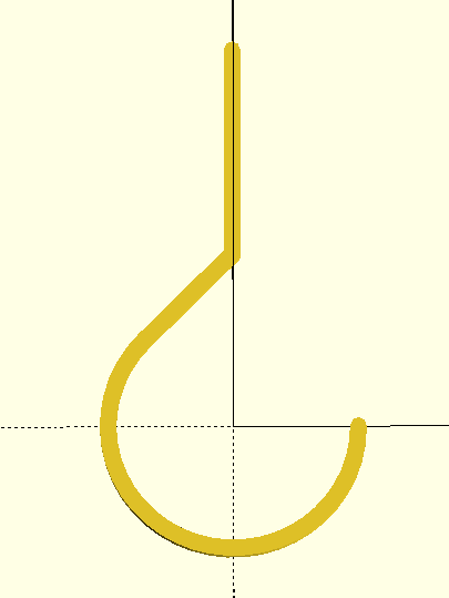

BOSL2's turtle command also has lines and arcs in one command.  You can
pass the result to path_sweep with the profile of your choice.
include<BOSL2/std.scad>
r=15;
stem=25;
angle=45;
path = turtle(["right", 90,
"arcright", r, 180+angle,
"untilx", 0,
"left", angle,
//              "arcleft", 9, angle,
"move", stem], [r,0]);
stroke(path,width=2);
It's easy to eliminate the sharp corner, though it does misalign the stem
with the center of the hook circle.
On Sat, Mar 8, 2025 at 8:40 AM Guenther Sohler via Discuss <
