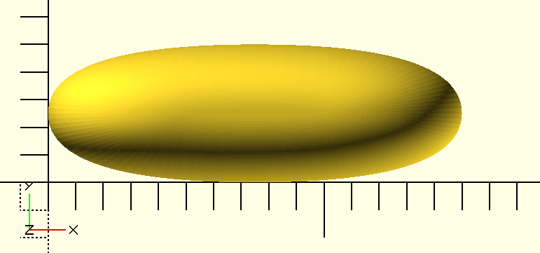

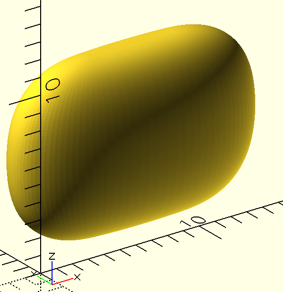

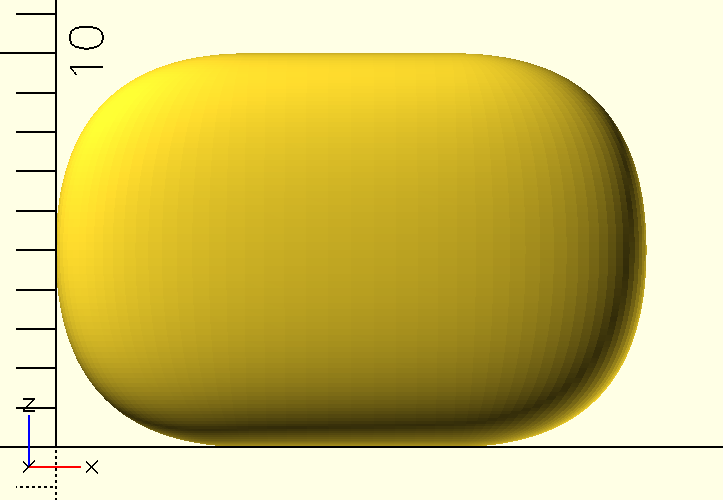

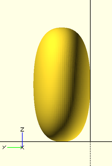

Being a simplistic sort of person, I'd approximate that with  a hull of
four ellipsoids, i.e. take a sphere stretched in two axes to make an
ellipsoid, repeat that for each of the corners and make a hull from those
four.
I doubt that's the most efficient way to do it though.
$fn=64;
translate([0,-20,0]) ellipsoid(5);
ellipsoid_array();
translate([0,20,0]) hull() ellipsoid_array();
module ellipsoid_array()
translate([0,0,0]) ellipsoid(5);
translate([16,0,0]) ellipsoid(5);
translate([16,0,5]) ellipsoid(5);
translate([0,0,5]) ellipsoid(5);
module ellipsoid(radius)
scale ([1.75,1,1.75]) sphere (r=radius);
