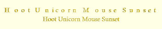

By using the spacing parameter, I've tried to make some text have bigger
gaps between letters but it doesn't give the result that I expected. In
the example below when I use spacing greater than 1, the lowercase
letters seem to space out okay but the gap after uppercase letters seems
a bit too wide, like after the H, U and M (and after i the spacing seems
relatively small. From a few tests, it seems that the 'wrong' gaps show
up only after certain letters, and they seem to be more noticeable when
there is a change of case in a word. I realise that rules for letter
spacing are complicated so perhaps those in the know would expect this
result, but to me it is unexpected.
translate([0,  10]) text("Hoot Unicorn Mouse Sunset", font = "Calisto MT", size = 10, halign = "center", valign = "center", spacing = 2); // test case
translate([0, -10]) text("Hoot Unicorn Mouse Sunset", font = "Calisto MT", size = 10, halign = "center", valign = "center", spacing = 1); // normal spacing
For my present project, an adequate circumvention involves using normal
spacing with space characters added between letters, but I'd still like
to know: is the issue a bug, or just a feature of the way these things work?
The answer is unfortunately really simple:  Don't.
See issue #3859 https://github.com/openscad/openscad/issues/3859 for
examples and a partial workaround.

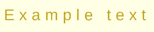

If you want a workaround, you can use BOSL2's path_text with a straight
path in a dev version that has textmetrics, e.g.,
include<BOSL2/std.scad>
path_text([[0,0],[80,0]], "Example text", size=5, textmetrics=true, kern=2);
