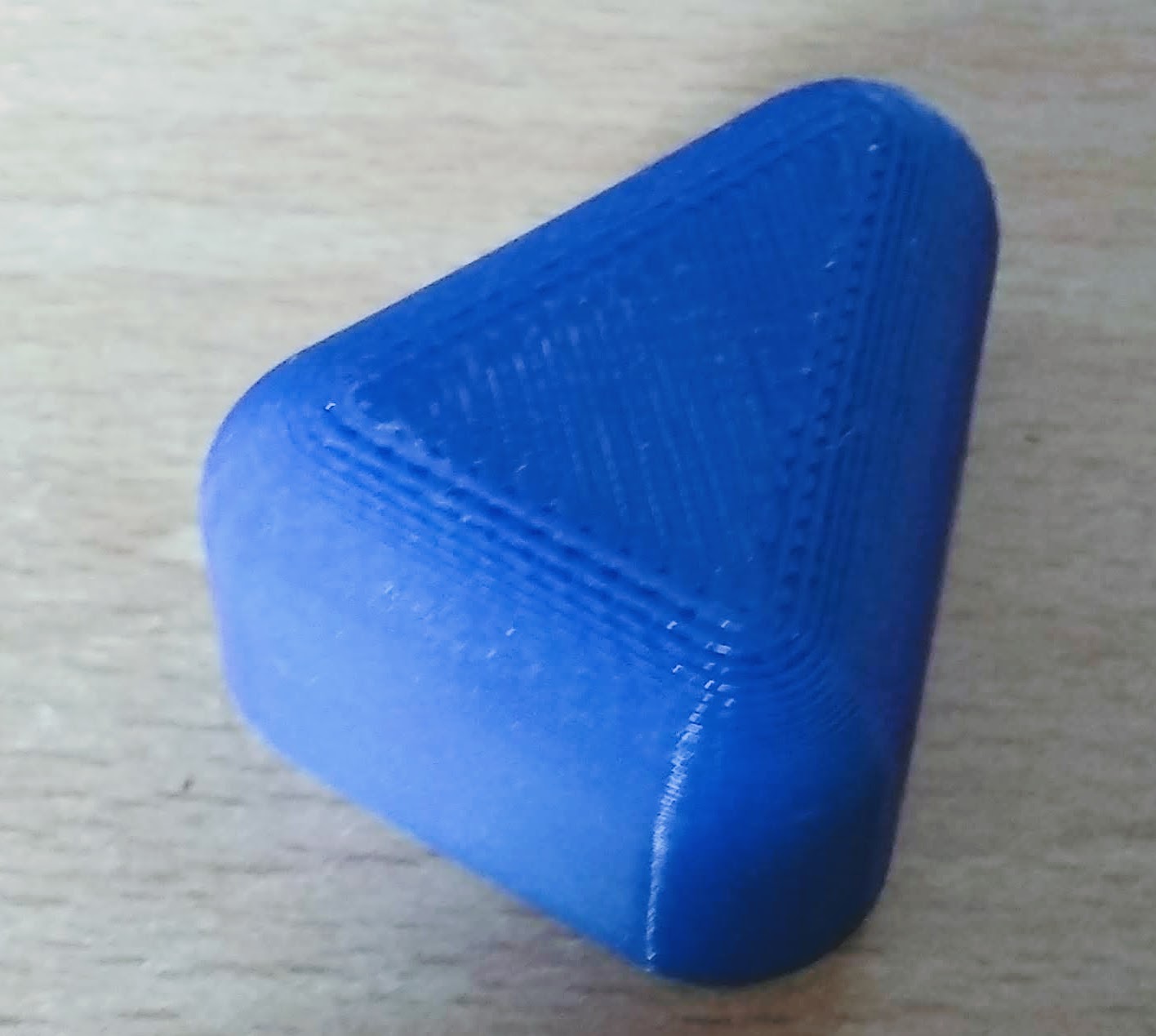

Isn't TPU another name for that?
No TPU is like rubber. Polypropylene is what some food container lids are
made from, e.g. Tupperware. Unlike TPU it is quite slippery, like
polyethylene, and it can't be glued easily.
To print it I used a sticky back PP sheet stuck to a sheet of glass as it
only really sticks to itself. This is a cap I made for a triangular tube
that held my glasses on my belt.
[image: IMG_20210630_141207417.jpg]
I have a chopping board made from PP that I will try printing on next time
as the sheet got welded to the part and ripped up. The trick is to do the
first layer a bit high to reduce adhesion.

nophead:
Can you reduce post-printing part adhesion through use of hair spray or
glue stick?  Sometimes the parts pop off after the bed cools; if not,
then a quick rinse under water can dissolve the hair spray or glue
between the part and the bed.

Wed, Jun 30, 2021 1:54 PM
Not sure if PP would stick to glue stick because it is one of those plastic
that you can't glue. However, the sticky back film must use a glue that
sticks to it.
TPU is totally unsuitable for a spline because it is an elastomer, so it
stretches and squashes. I saw a video from Jame Bruton where he made a
harmonic drive from it but it was very lossy and easily slipped. You want
something hard that will bend like spring steel.
Most hard plastics will bend when thin but they will break if you flex them
backwards and forwards hundreds of times. PP will flex forever I think and
doesn't stretch or squash like TPU. It isn't particularly hard though, so
might wear away at the teeth. It should be low friction though, which will
mitigate that.

Gene Heskett
Wed, Jun 30, 2021 7:30 PM
are made from, e.g. Tupperware. Unlike TPU it is quite slippery, like
Sounds like it might be worth looking into so I ordered a roll and its
matching glue stick from MatterHackers.
it only really sticks to itself. This is a cap I made for a triangular
tube that held my glasses on my belt.
I wasn't able to find one of those, this CR-10S Pro V2 has the dark grey
textured, sorta like polycarbonate cover on a heavy alu sheet. BLT scans
it in 25 places before every print. And that part works really well.
Thanks nop head.
