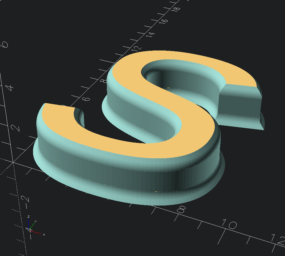

I use BOSL2's offset_sweep() and path_sweep() often when I can work with
paths from functions.  When working with modules the closest tool is
convex_offset_extrude() but text() and projection() often aren't convex.
So I slightly tweaked it to make offset_extrude() using roof() instead of
hull() on pairs of linear_extrude().  I think this could be worthy of
submission to BOSL2's github but thought it could benefit from additional
eyes and some use.
Here's an example:
offset_extrude(height=2, top=os_teardrop(r=0.5),
bottom=os_teardrop(r=-0.5), steps=8, offset="delta", $fn=128)
text("S", font="Liberation Sans:style=Bold Italic");
[image: offset_extrude_test.png]

I eliminated some redundant code and the layers[][] stuff which I don't
think is helpful with slices produced by roof().
Here's my latest offset_extrude():
