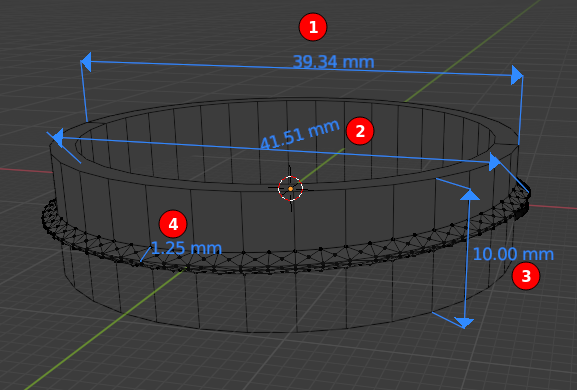

I'm having trouble getting my thread "depth" to match up I'm trying to get
it to be 2.16mm (#4) but when measured (Using Blender it's 1.25mm)
Here's my process:
Measure Original bottle top:
  1. Measure OUTSIDE of bottle top (no Threads)
    • 39.34mm*
  2. Measure OUTSIDE of Bottle top (include all Threads)
    41.5mm
  3. Measure bottle top height
    10mm
  4. Minus Threads number from no Threads number gets the length of thread
    41.5-39.34 = 2.16mm thread length (note this number doesn't match
    when imported into blender)

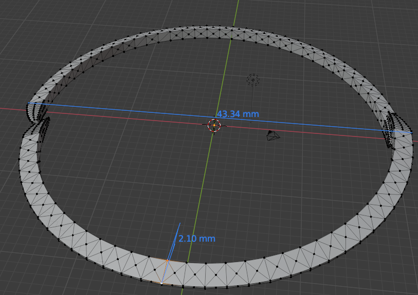

Mon, Aug 9, 2021 5:39 PM
The outer diameter including threads should be 41.51mm Setting the
depth_a to 2.16mm as you suggest would make the outer diameter with
threads increasing to 43.34mm that's the issue.  I can't figure out a way
to get the outer diameter (including threads of
2.16mm
) to be
41.51mm there's
some strange math issue going on I can't figure out.
See image of setting depth_a to 2.16mm

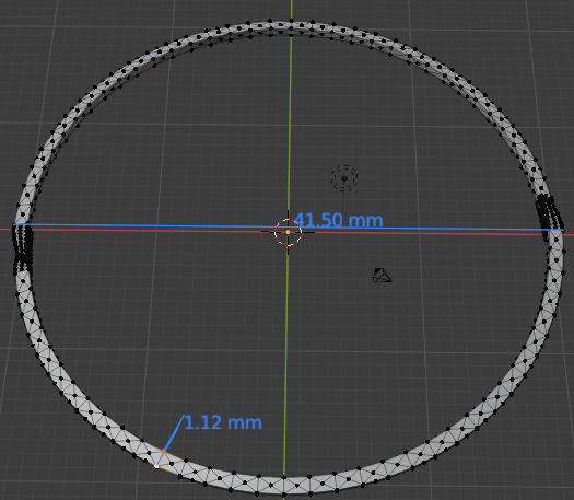

Mon, Aug 9, 2021 6:06 PM
Sorry, I didn't look at this close enough.
So, you measured the two diameters and the difference is 2.16mm, which is
the amount of space the threads take up. Right?
So, by measuring diameters, 2.16 is the space that TWO threads (one on each
side of the cylinder) take up.
So, the actual thread depth is 0.5*2.16 = 1.08mm.
so, set
depth_a = 1.08;
...and see what happens?
get it to be 2.16mm (#4) but when measured (Using Blender it's
1.25mm)
Here's my process:
    • 39.34mm*
    41.5mm
    10mm
    thread
way to get the outer diameter (including threads of
2.16mm
) to be
41.51mm there's some strange math issue going on I can't figure out.
[image: screenshot-2021-08-09-13-26-44.png]

The diameter is correct 41.5mm but the original problem is back, the
depth of the thread is still not 2.16mm it's now 1.12mm
I tried
include <BOSL2/threading.scad>
pitch = (2.16.5); //pitch Distance between threads. Default: 2mm/thread
depth_a = 2.16.5
; // adjust thread length
thread_helix(d=39.34, pitch=pitch, thread_depth=depth_a, starts=2,
twist=190, higbee=3, $fn=72);
and
pitch = (2.16); //pitch Distance between threads. Default: 2mm/thread
depth_a = 2.16.5*; // adjust thread length
[image: issue.png]
each side of the cylinder) take up.
so, set
depth_a = 1.08;

Yep, that's the thread depth that you will get with those constraints,
because there are threads on BOTH sides of the cylinder.
Let's look at it from another point of view.  Let's consider radius instead
of diameter.
The radius of the bottle is 0.5 * 39.34 = 19.67mm.
The radius of the cap is 0.5 * 41.5 = 20.75mm.
The thread height is then 20.75 - 19.67 = 1.08mm.
is the amount of space the threads take up. Right?
so, set
depth_a = 1.08;
On Mon, Aug 9, 2021 at 12:39 PM Stillpoint X stillpointx@gmail.com
a way to get the outer diameter (including threads of
2.16mm
) to be

Using BOSL2 and getting the thread "depth" to match.
to get it to be 2.16mm (#4) but when measured (Using Blender
it's 1.25mm)
Here's my process:
    • 39.34mm*
    41.5mm
    10mm
    thread
    match when imported into blender)
2mm/thread (2.28)
depth_a = pitch * cos(30)*5/8;
// d Inside base diameter of threads. Default: 10
thread_helix(d=39.34, starts=2, twist=190,profile = [
[-5/16, 0          ],
[-1/16, depth_a/pitch ],
[ 1/16, depth_a/pitch ],
[ 6/16, 0          ],
], higbee=3, $fn=72);
An idea how to fix this correctly?
