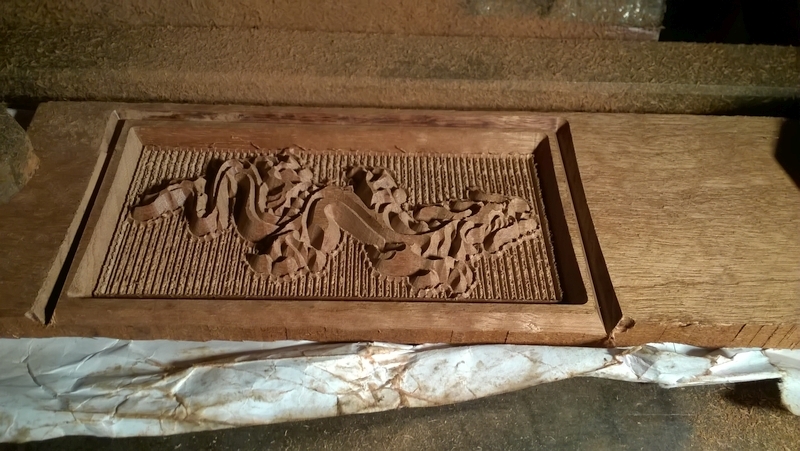

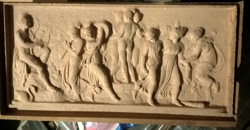

Oh, and if sign making may be a thing for you, then the guy at
http://www.scorchworks.com/ has some very useful software, written in
Python, so you can fiddle with it yourself. I've attached an image of a
lump of wood, gcode generated by scorche's software, and cut with a 60
deg trend router bit (dragon.jpg) and the other .jpg  gcode was
generated by the free desk proto, using the tapered cutter I referred to
earlier, with 0.25mm radius ball end, using about 0.35mm stepover- it
took a while. but unlike 3d printing, it rarely fails in the middle of a
job. A lighter machine would use a smaller cutter, and may need two or
more passes. You can fake that by offsetting the z axis, or run it with
a larger diameter tool before doing the final cut. You need to try it
and see. A useful source of free stl files for this sort of thing is
sketchfab, a number of museum artefacts are being digitised. You may
need to pass them through meshlab, to straighten them out, and find the
errors.

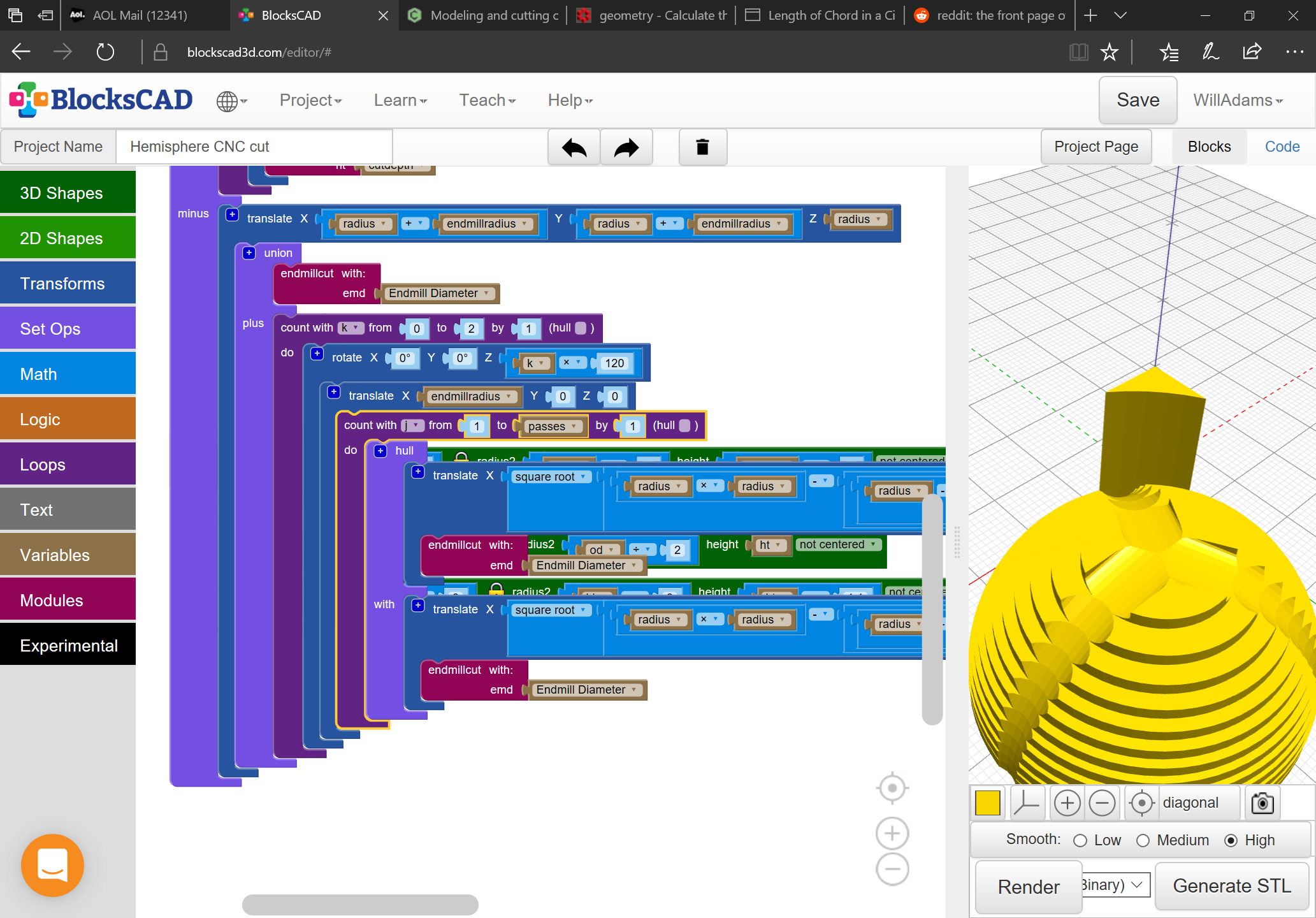

Well, the longitudinal hemisphere cuts work:
Except performance begins to really bog down.
I'll try switching to my MacBook and OpenSCAD to finish this off --- is there any prospect of performance in OpenSCAD improving?
Well, the longitudinal hemisphere cuts work: Except performance begins to really bog down. I'll try switching to my MacBook and OpenSCAD to finish this off --- is there any prospect of performance in OpenSCAD improving? William
