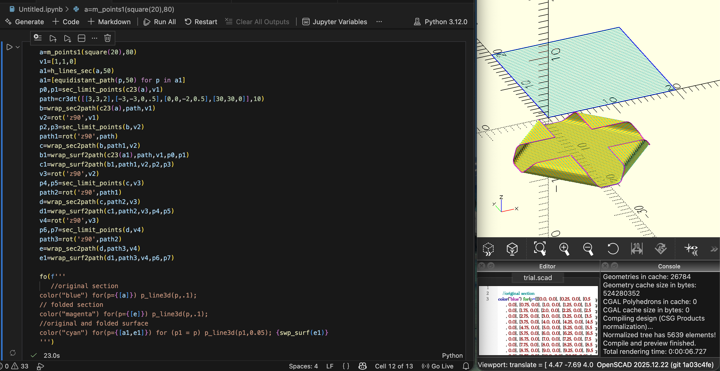

Here is another video with voice over on how to model a mobile stand
https://youtu.be/UHjuwfc3WX8?si=4R6OQ1FeACphIgMk
On Sun, 28 Dec, 2025, 12:22 pm Sanjeev Prabhakar, sprabhakar2006@gmail.com
an example of creating surface with 4 lines enclosure and creating a solid
https://youtu.be/Hj3rDfStsJY
On Wed, 24 Dec 2025 at 21:28, Sanjeev Prabhakar sprabhakar2006@gmail.com
I have been working on openscad with python for a few years now.
I use Jupyter Lab to write my python code and it is working well for me.
But simply writing openscad code in python is not very useful. You need
to learn first to work with points list instead of openscad primitives.
I have written various examples for this approach and here is a small
video for a starting point in case you are interested:
https://youtu.be/kBshJ0CQCS0

Fri, Jan 16, 2026 7:02 AM
example of folding  surfaces based on a path. Complex but works
consistently:
[image: Screenshot 2026-01-16 at 7.59.24 AM.png]
