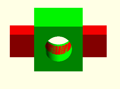

When an object is differenced, (Note the red and green objects are not
unioned in this example, they are imagined as two objects in the same 3d
space) then the cut faces take the vertices from the main object, giving
the impression of a solid colored object. My earlier post of 30/12/2025
showed the result of that, (image below the ply file that I attached
back then, can be viewed with color, in meshlab.)
if the objects were booleaned in any way, the result would be a new
object, and as an object it would need it's own color assigned.
The argument is complicated, if half the time we are thinking in 2d, but
the physical world is 3d (and analogue). fdm color printing is in 3d,
and so is a film of paint. So, face color really needs a separate
colored solid object for each face, which is perfectly feasible using
manifold.

Sat, Jan 3, 2026 6:01 PM
On 1/3/2026 4:36 AM, Raymond West via Discuss wrote:
[ gradient colors ]
Yes, I occasionally think about those and about UV mapping
https://en.wikipedia.org/wiki/UV_mapping.  But they are pretty deep in
the weeds for us.
3d space) then the cut faces take the vertices from the main object,
giving the impression of a solid colored object. My earlier post of
30/12/2025 showed the result of that, (image below the ply file that I
attached back then, can be viewed with color, in meshlab.)
What's the OpenSCAD source for that model?
Absent lazy union, OpenSCAD is simply incapable of putting two objects
into the universe without unioning them.  It doesn't have a way to say
that.  In a preview there may be artifacts like this, but they are
preview issues and do not represent the geometry.
