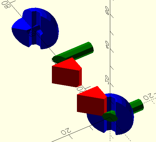

Today's OpenSCAD color processing does face coloring.  It is perfectly
possible to have the six faces of a cube have six different colors, and
if you union two shapes of different colors there's nothing known about
the color of the overlap area.
That scheme is fine, more or less, for visualization, but it doesn't
work well for actual 3D printing where you need to know what color (or
material) the interior of a shape is to be.
What you need is volumetric color, so that there are no overlapping
shapes and you always know what color the interior of a shape is.
I mentioned this need as part of a discussion of color semantics, and
one of the responses was that we didn't know how to do volumetric
color.  I'd done an OpenSCAD demonstration of volumetric color and was
pretty sure that it was straightforward to come up with appropriate
processing, so I said I'd recreate that proof-of-concept for discussion.
And here it is.
Note:  this is not the most efficient possible implementation.  It
re-evaluates the model many times, when it really only needs to be
evaluated once.  There should probably be a few more render()s scattered
around to try to get subtrees to be cached.  But it looks like it works.
Implementations of hull(), minkowski(), et cetera, and of the 2D
operations, left as an exercise for the reader.
Here's the result of this particular model, both in assembled form and
exploded by color:

// The model.  A couple of unions, a difference, and an intersection
// to do a cutaway so that you can see the internal colors.
module main() {
int() {
uni() {
col("green") rotate([90,0,0]) cylinder(h=30, d=5, center=true);
dif() {
uni() {
col("red") cube(10);
col("blue") sphere(10);
rotate(-45) translate([0,-20,-20]) cube([40,40,40]);
// And now the infrastructure...
// Set the color of the children, like color().
// In this POC, this really operates by skipping anything that
// isn't the desired color, and then coloring during the per-color
// pass at the end, but there are other variations.
module col(c) {
union() {  // work around #6456.
// $color=undef means that we want all colors - in particular,
// for the second-and-later children of dif() and int().
if (is_undef($color) || c == $color) {
// Union the children.
// What this does is to draw the first child, then draw the second child
// less the first child, then the third less the first and second, and
// so on.  Note that the negative components have $color=undef so that
// the entire subassembly, of all colors, gets subtracted out.
module uni() {
for (i=[0:1:$children-1]) {
// Add this child, less the children before it.  Note that
// because of col() processing this might be only part
// of the logical subtree, but that's OK; what's important
// is that we mask it all colors of the previous children.
children(i);
children([0:1:i-1], $color=undef);
// Difference the children.
// The only novel thing that this does is to set $color=undef
// for the second-and-later children, so that all colors are
// subtracted away from the first child.  Again, because of
// col() processing the first child might only be a fraction of
// the logical subtree; it'll all get reassembled in the final
// multiple passes.
module dif() {
children(0);
children([1:$children-1], $color=undef);
// Intersect the children.
// Think of this as taking the first child, and subtracting
// parts of it that are not in common with the later children.
// That neatly answers the question of what color the result
// should be, and makes everything consistent:  the first child's
// color wins.
module int() {
intersection_for(i=[0:1:$children-1]) {
if (i == 0) {
children(i);
} else {
$color = undef;
children(i);
// As noted above, this list of colors needs to be
// known in advance; in a built-in implementation (or even
// in a script-driven userspace implementation) this list
// would be dynamically derived.
colors = [ "red", "green", "blue" ];
// Build the model.
for (c = colors) {
$color=c;
color(c) render() main();
// Build an exploded set so that you can see
// what the individual colored parts look like.
for (i = [ 0:len(colors)-1 ]) {
c = colors[i];
$color=c;
translate([20+i*20,0,0]) color(c) render() main();
module uni() {
children(i);
// multiple passes.
module dif() {
children(0);
// color wins.
module int() {
if (i == 0) {
children(i);
} else {
$color = undef;
children(i);
// Build the model.
for (c = colors) {
$color=c;
c = colors[i];
$color=c;

// Volumetric color proof of concept
// Jordan Brown, openscad@jordan.maileater.net
// There are four relevant modules in this POC:
// col - replacement for color()
// uni - replacement for union()
// dif - replacement for difference()
// int - replacement for intersection()
// In this POC, the list of possible colors needs to be known in
advance;
// in a built-in implementation it would either be collected during the
// evaluation phase or managed entirely dynamically.  It would be
// straightforward to build a version of this POC that would be
// driven by an external script that would first run it in a
// "list colors" mode and would then run it once for each color.
// Similarly, in this POC the model is encapsulated in a module main(),
// while in a built-in implementation the final "step through the
colors"
// loop would be implied and the model could be at the top level.
// This POC steps through the colors, generating the parts for one
color,
// then the next, then the next.  A built-in implementation could do
// that, or could do roughly the same operations across all colors at
once.
module main() {
     int() {
         uni() {
center=true);
             dif() {
                 uni() {
module col(c) {
module uni() {
             children(i);
// multiple passes.
module dif() {
         children(0);
// color wins.
module int() {
         if (i == 0) {
             children(i);
         } else {
             $color = undef;
             children(i);
// Build the model.
for (c = colors) {
     $color=c;
     c = colors[i];
     $color=c;
exploded by color:
module main() {
     int() {
         uni() {
center=true);
             dif() {
                 uni() {

  1. I think it will be better to do it in openscad or maybe think about
    how to do it in Manifold, we can cache and optimize stuff better.
  2. I think 3MF does have its standard for multi-material/color. Probably
    just multiple meshes with metadata. Whether all slicers support that is
    another story.

How do you think this improves on colorscad?
I haven’t used colorscad; I’ve only just now read its README. Looking at it, it looks like it’s actually almost exactly the stuff I said you could wrap around this implementation to make it actually useful.
But it doesn’t do the stuff that I consider truly interesting. Consider this paragraph from its README:
Let's avoid weird geometry such as overlapping color volumes... Avoid using multiple colors in an intersection() or difference(), if unavoidable then just wrap it in a color() statement.
If you’re willing to live with those restrictions, well, OK, but it sure seems like the example that I gave would be much harder to build if you have to live within them. I want something where color (“red”) cube(10); color(“blue”) sphere(10); does something sensible and predictable, without me having to do the work to avoid the overlap. Similarly, I want to be able to take a multicolor object and cut it in half with a difference or intersection and have it just work. (Which I suspect it will, with colorscad, but the documentation isn’t encouraging.)
As an exercise, you could demonstrate creating my sample model using colorscad’s restrictions; it would be interesting to see the comparison. (Remember that “my sample model” is only the stuff inside the “main” module; the rest is infrastructure.)
You made a number of choices regarding what union/difference/intersection mean, but are those useful and efficient in creating actual shapes versus i.e. BOSL2's coloring?
I haven’t noticed similar support in BOSL2, but I haven’t looked. It wouldn’t surprise me if they had something similar, because what I did is a lot like what they do with their diff() operator.
But that would only make my point, which is that it is possible to define volumetric color.
Are the definitions I picked useful? I have no practical experience with them, since I don’t have a multicolor printer. However, since they’re a superset of the capabilities of colorscad’s design capabilities - if you avoid overlaps, it’ll generate the same results that colorscad produces - they’re at least as useful as it is. (Again noting that it does the automation that wraps around this geometry processing to step through the colors, which wasn’t the point of this exercise.)
I’ve been thinking about the definitions on and off for a long time. Difference is easy; the colors of the first child must remain unchanged as you cut away parts of it. Intersection and the overlapping part of union, which are in a sense the same thing, kind of need to be either first-wins or last-wins, and the two strategies seems equivalent, so I picked first-wins because that’s what difference needs. Hull and the others need some answer, but I doubt that what the answer is matters.
Are they efficient? First, I don’t care. Getting a useful and understandable result is the critical piece; a scheme that is ten times faster and requires the model to be ten times as complicated (or even twice as complicated) is in my mind a losing proposition. Second… as implemented, absolutely not. There’s at least a couple of optimizations that could be made even in an OpenSCAD-language implementation, and there’s several more that can be made if you can work directly with the CSG tree. (Geometry values from PR#4478 would help there.) Third, I expect that a multicolor scheme is always going to be slower than a single-color scheme, because there’s just more geometry processing to do.
