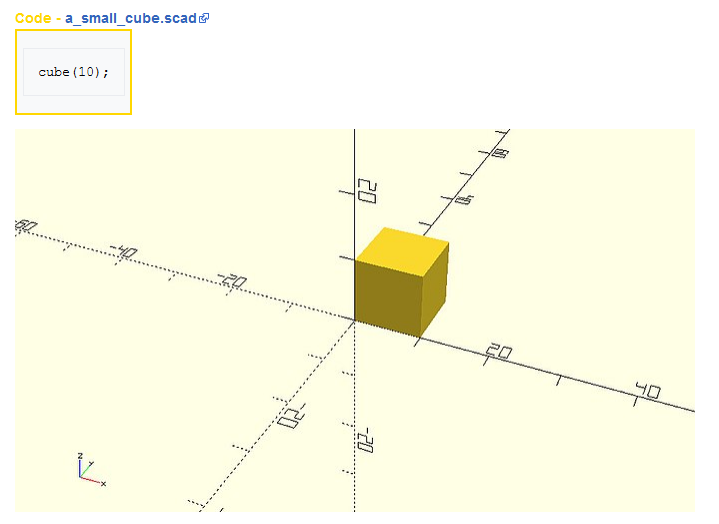

[ This is a discussion of how the tutorial might be improved to avoid
this confusion. ]
On 4/15/2021 3:19 PM, Mendalski wrote:
The code to enter is:
a_small_cube.scad
cube(size=10);
This is indeed confusing.  I went to go see if I could fix the tutorial,
but this pattern is used throughout so it's not a simple point fix.
Here's what it looks like:
Knowing the language and that there's an issue here, it's easy to see
that "a_small_cube.scad" is in italics, and the cube() invocation is in
a different font, in a box, but (a) files haven't been covered yet, (b)
the inner box is subtle, and (c) it's easy to miss the font change.
So what should it look like?
Maybe make the file name be more distinct?
Maybe move it into the title?
(But note the double box, which is kind of strange.  The inner box is
how Wikibooks is styling <pre>.)
Wikipedia programming language samples look like
or
but do not have a title ("Code") or file name ("a_small_cube.scad").
Or something else?
My suggestion:
  • Do not include the file name in the example.  (If there's an example
    where the file name is important, as for example a discussion of
    "use <name.scad>", include it in a comment.)
  • Include the file name in a Wikibooks comment (invisible to the
    reader); it looks like there's an intent to match up file names to
    the resulting images.
  • Use the Wikipedia numbered style.
  • Use lang="text".  Although others, like lang="C", will produce some
    syntax highlighting, I doubt any of them are exactly right for
    OpenSCAD.  Or maybe lang="C" until we find a case where it doesn't
    look good.
Any thoughts?

Here's a structure that is in some ways convenient.
I created a template {{User:Jordan Brown/sandbox/tmpl}}.  Its simplest
invocation is
{{User:Jordan Brown/sandbox/OpenSCADExample|name=a_small_cube}}
which generates:
You can see this live at
https://en.wikibooks.org/wiki/User:Jordan_Brown/sandbox/demo .
What it does, in this simple invocation, with a name FOO, is:
So the idea is that you put this simple reference into the main
document, and you create a page FOO with the OpenSCAD program, and an
image file FOO.jpg, and the template takes care of putting them together
into the preferred form.

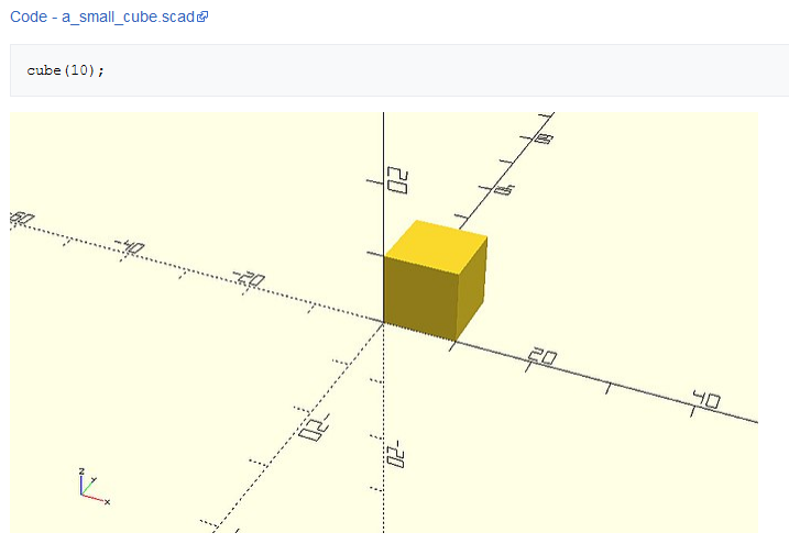

I also put together a slightly different template OpenSCADExample2, that
produces this, which I like a little better:
... but I'm not entirely happy with the title format.
