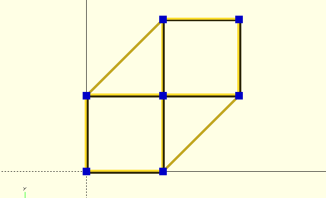

To illustrate the impossibility of finding a winding order for some cases,
consider the following section of the facets of a polyhedron:
where all the facets (except the top and bottom ones) are parallel to the Z
axis and have equal heights.​
> > So how possible would it be to build a system (which might consist of a > CAD program like OpenSCAD and a slicer) that would not care if you got the > winding direction wrong or if you let objects touch one another? > If an object is built by boolean operations of any primitives except polyhedron, the winding order will be consistent even if the result is not a manifold. For polyhedron, a consistent winding order is user responsability. A polyhedron is a soup of (possibly triangulated) facets so it is possible to define non-orientable, non-manifold, self-intersecting freaks with polyhedron. When the polyhedron call defines an *orientable* manifold it is possible to find a consistent winding order to the facets by traversing all the facets. If this traversing is unable to find a consistent winding order than it is possible to conclude that the polyhedron skin is non-orientable or a non-manifold. Self-intersection are harder to detect because it requires comparing all facet pairs. To illustrate the impossibility of finding a winding order for some cases, consider the following section of the facets of a polyhedron: where all the facets (except the top and bottom ones) are parallel to the Z axis and have equal heights.​ ​ > >
I'm having a hard time understanding what I'm looking at.  I don't see
how it can be a polyhedron, because two of the vertices seem to have
only two edges connected to them.
On 3/5/2018 12:08 PM, Ronaldo Persiano wrote: > To illustrate the impossibility of finding a winding order for some > cases, consider the following section of the facets of a polyhedron: > > > where all the facets (except the top and bottom ones) are parallel to > the Z axis and have equal heights.​ I'm having a hard time understanding what I'm looking at.  I don't see how it can be a polyhedron, because two of the vertices seem to have only two edges connected to them.

The traditional examples of a non-orientable surface are Klein bottles and
Moebius strips.  You can't color one of those with blue on one side and red
on the other.
http://forum.openscad.org/file/t2140/kleinbottle.scad

Sure.  I would consider the ability to model impossible figures[*] to be
very much secondary to making it easy to model possible figures.  I
would not be bothered in the slightest if OpenSCAD rejected a Klein
bottle as a self-intersecting polyhedron.
[*] A Möbius strip is an impossible 2-dimensional figure.  As a
three-dimensional figure with thickness it is completely possible,
but then it also isn't, well, impossible; it has a well-defined
inside and outside.
