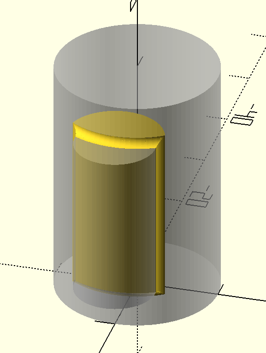

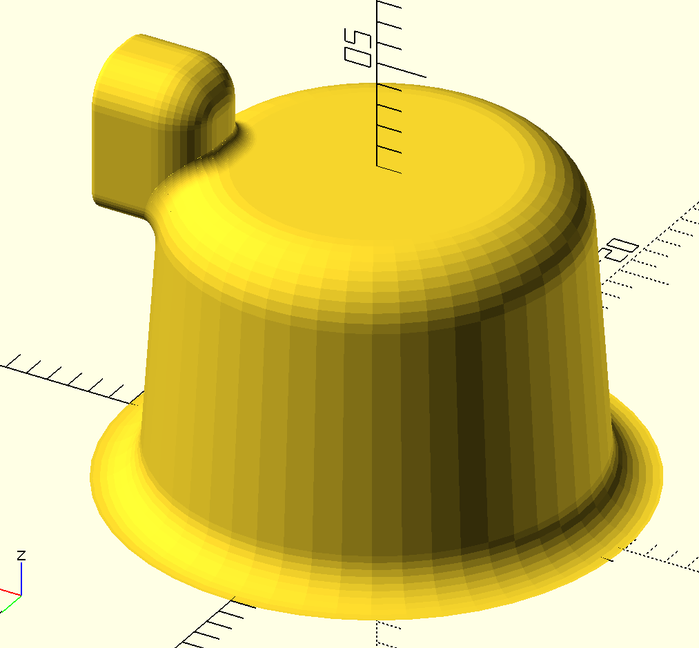

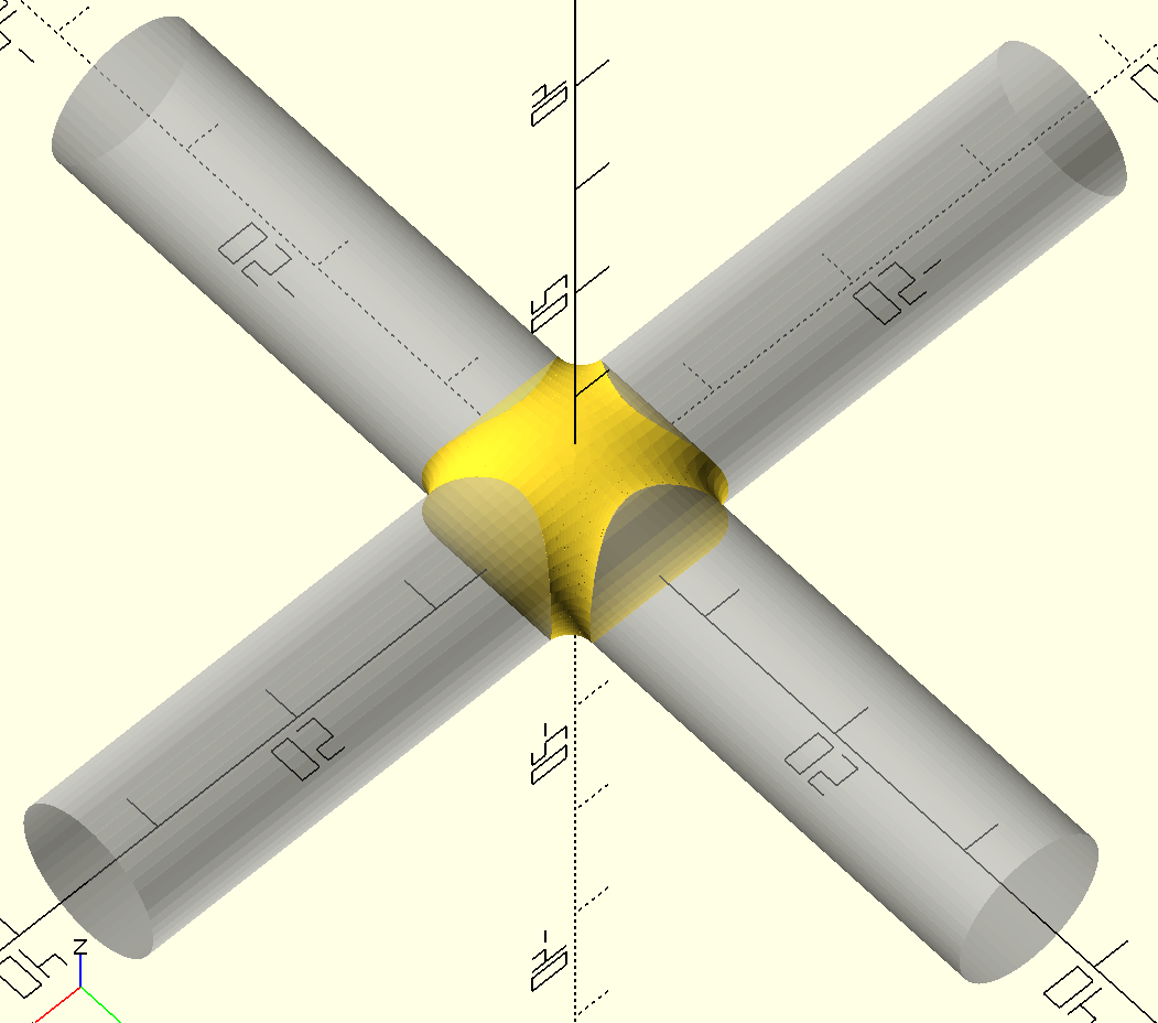

generic method of rounding
Fri, Mar 10, 2023 11:30 PM
First of all 3d objects/ solids/ prisms, whatever you may call them, have
to be made through the list of points.
There are in most of the cases 3 ways I make solids and most likely you
also i.e. through a
  • path_extrude method, when the path is curved or anything
  • Linear extrude method
  • offset method from path, where x-coordinates of the path is used to
    offset the section and y-coordinate of the path is used to translate the
    offsetted section to z-coordinate.
for the offset method, which i call function prism, 3d resize function can
give the offset of the solid, at whatever location it is placed. for
resizing what you need is the 3d bounding box dimensions, of the prism. To
that bounding box dimension, add 2 times the offset amount and an offsetted
solid can be achieved.
for other 2 methods i.e. path_extrude and linear extrude(in case it is
twisted) a function needs to be written to offset the solid at their
original location.
The way I do that is following:
find normal of each section in the path_extrude (you have it already when
you know the path)
with the help of normals, transform the section points to x-y plane,
convert to 2d points, offset the section and then revert the offsetted
points to their original location.
So, once you can offset the solids at their original locations, you can do
the filleting by the intersection method.
You can check the following main functions I have written:
prism(sec,path)
path_extrude(sec,path)
rsz3dc(prism,rsz) - basically this resizes the 'prism'  to dimensions
defined in 'rsz' keeping the same center of mass.
offset_sol(sol,d,o=0): function to calculate offset of a 3d object by
distance 'd'. option 'o' can be set to '0' or '1' depending on the shape of
the object.In case the shape of the 3d object is twisted,option should be
set to '1'. in few special cases this function may not work.
I hope i could clarify to some extent

and i think this can be achieved in pure openscad, although i have
done this through python.
This is done with 3d resizing the intersecting solids and that's all.

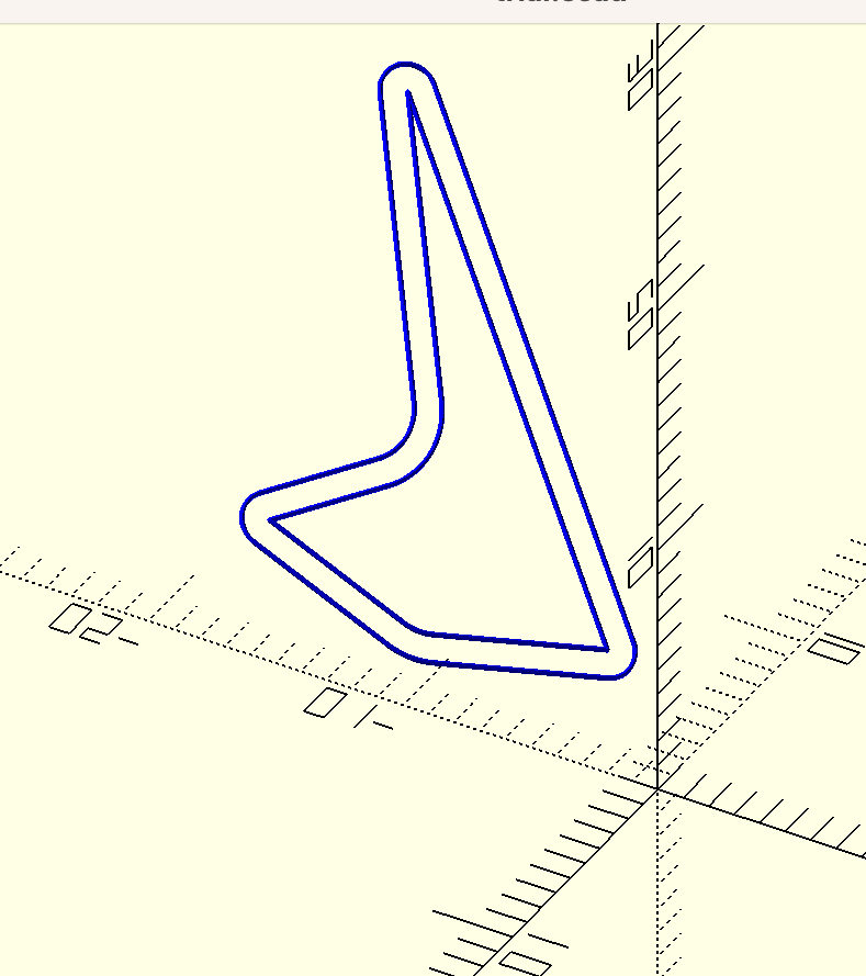

Fri, Mar 10, 2023 11:44 PM
offset_sol function is based on the function offset_3d which offsets any
section at it's original 3d location
