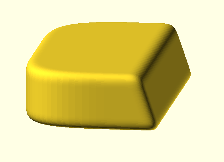

Here's a way to do this in BOSL2 with a single command (though a
limitation that the number of facets is the same on all the
roundovers).  If you want the bottom not rounded that's easily
accomplished as well.
See here:
https://github.com/revarbat/BOSL2/wiki/rounding.scad#functionmodule-rounded_prism
include<BOSL2/std.scad>
include<BOSL2/rounding.scad>
ra = 15;
wi = 55.6;
ht = 12;
de = 30;
jra = 20;
jother = 3;
rounded_prism(square([wi,de]), square([wi,de-ht*sin(20)]), height=ht,
joint_sides=[jra,jra,jother,jother],
joint_bot=jother, joint_top=jother, splinesteps=25);
