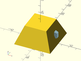

Let's start with a simple example from
https://github.com/BelfrySCAD/BOSL2/wiki/attachments.scad:
prismoid(50,30,25)
align(RIGHT)
color("lightblue")prismoid([10,5],[7,4],height=4,orient=RIGHT);
[image: align_10.png]
BOSL2 provides good tools for positioning and aligning basic 3d shapes.

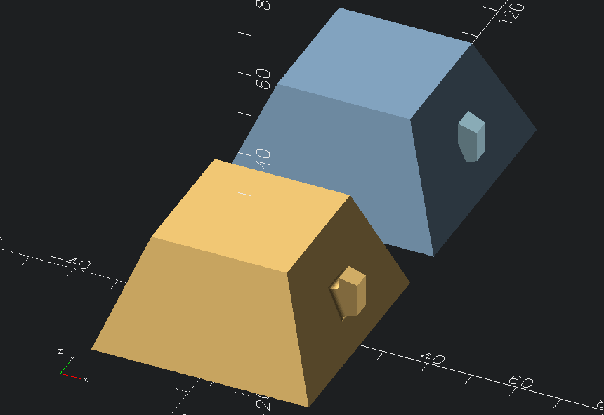

But some things are still hard such as filleting the joint of the above
example.
We can fillet it in PythonSCAD by taking advantage of its offset() function
which when used with a negative offset to shrink a 3d object
fillets concave edges.  I made a file bosl2_example.scad containing:
module prismoids(oversize) {
os2 = oversize * 2;
down(oversize) prismoid(50+os2,30+os2,25+os2)
left(oversize) align(RIGHT)
color("lightblue")prismoid([10+os2,5+os2],[7+os2,4+os2],height=4+os2,
orient=RIGHT);
And a file fillet.py in the same directory containing:
from openscad import *
example = osinclude("bosl2_example.scad")
original = example.prismoids(oversize=0)
delta = 1.0
oversized = example.prismoids(oversize=delta)
filleted = oversized.offset(-delta, fa=10)
show([filleted,original.back(60)])
Preview of fillet.py in PythonSCAD:
[image: filleted_align_10.png]
The coloration did not pass from OpenSCAD into PythonSCAD properly and I've
stumbled on other issues suggesting PythonSCAD is less polished than
OpenSCAD but I'm excited enough by the potential that I plan on doing my
next project in PythonSCAD as it has other powerful capabilities such as
edges() and faces() which I expect will enable amazing new possibilities.
Currently OpenSCAD does not give one access to generated geometry and being
able to access and manipulate could be a game changer.

Thank you for the nice demonstration.
Please let us know where there are the biggest stumbling blocks so we can
set priorities correctly.
the lightblue color is not visible in the offset result, because offset
does a difference internally. green is the difference color.

Just note, that there exists an experimental windows installer which can do
colored 2D rendering. It basically works, but it will require  some more
brain power to get all crests clean.
You can trick it a little bit by making the shapes 100% translucent and get
nice shapes::
https://imgur.com/a/gu3xmms
But actually 2D in openscad/pythonscad should be non-intersecting.
prismoid(50,30,25)
align(RIGHT)
example.
function which when used with a negative offset to shrink a 3d object
os2 = oversize * 2;
orient=RIGHT);
delta = 1.0
I've stumbled on other issues suggesting PythonSCAD is less polished than
> the lightblue color is not visible in the offset result, because offset does a difference internally. green is the difference color. Thanks, I was also thinking the parent prismoid was being affected by the blue color of the child prismoid although I now see it is just the default color (which is different from the default yellow of the .scad) and it stays the same no matter what color is set for the child. I will follow up soon with some other issues after I've spent a bit more time looking at them to hopefully avoid reporting ones caused by my misconceptions. On Wed, May 7, 2025 at 1:33 PM Guenther Sohler via Discuss < discuss@lists.openscad.org> wrote: > Thank you for the nice demonstration. > Please let us know where there are the biggest stumbling blocks so we can > set priorities correctly. > > the lightblue color is not visible in the offset result, because offset > does a difference internally. green is the difference color. > > > > > > > On Wed, May 7, 2025 at 8:12 PM Todd Allen via Discuss < > discuss@lists.openscad.org> wrote: > >> The new python-engine feature of recent development builds of OpenSCAD >> motivated me to download PythonSCAD from >> https://pythonscad.org/download.php. Python-engine in OpenSCAD >> incorporates PythonSCAD but less complete than PythonSCAD's incorporation >> of OpenSCAD. Running the following example needs a PythonSCAD build but >> perhaps soon will also work directly in OpenSCAD. >> >> Let's start with a simple example from >> https://github.com/BelfrySCAD/BOSL2/wiki/attachments.scad: >> include <BOSL2/std.scad> >> prismoid(50,30,25) >> align(RIGHT) >> color("lightblue")prismoid([10,5],[7,4],height=4,orient=RIGHT); >> [image: align_10.png] >> >> BOSL2 provides good tools for positioning and aligning basic 3d shapes. >> But some things are still hard such as filleting the joint of the above >> example. >> >> We can fillet it in PythonSCAD by taking advantage of its offset() >> function which when used with a negative offset to shrink a 3d object >> fillets concave edges. I made a file bosl2_example.scad containing: >> include <BOSL2/std.scad> >> module prismoids(oversize) { >> os2 = oversize * 2; >> down(oversize) prismoid(50+os2,30+os2,25+os2) >> left(oversize) align(RIGHT) >> color("lightblue")prismoid([10+os2,5+os2],[7+os2,4+os2],height=4+os2, >> orient=RIGHT); >> } >> >> And a file fillet.py in the same directory containing: >> from openscad import * >> example = osinclude("bosl2_example.scad") >> original = example.prismoids(oversize=0) >> delta = 1.0 >> oversized = example.prismoids(oversize=delta) >> filleted = oversized.offset(-delta, fa=10) >> show([filleted,original.back(60)]) >> >> Preview of fillet.py in PythonSCAD: >> [image: filleted_align_10.png] >> The coloration did not pass from OpenSCAD into PythonSCAD properly and >> I've stumbled on other issues suggesting PythonSCAD is less polished than >> OpenSCAD but I'm excited enough by the potential that I plan on doing my >> next project in PythonSCAD as it has other powerful capabilities such as >> edges() and faces() which I expect will enable amazing new possibilities. >> Currently OpenSCAD does not give one access to generated geometry and being >> able to access and manipulate could be a game changer. >> _______________________________________________ >> OpenSCAD mailing list >> To unsubscribe send an email to discuss-leave@lists.openscad.org >> > _______________________________________________ > OpenSCAD mailing list > To unsubscribe send an email to discuss-leave@lists.openscad.org >
TA
Todd Allen
Fri, May 9, 2025 4:36 PM
I would be most helped by improved documentation.  This page
https://pythonscad.org/tutorial/site/python_new/ lists several functions
new to PythonSCAD but doesn't say much about them.  I would like to know
about the parameters and return values of each function and ideally
examples of using them.  I find some of that here
https://raw.githubusercontent.com/pythonscad/pythonscad/refs/heads/master/libraries/python/openscad.pyi
but I am still struggling to figure out how to make use of these
functions.  For instance I would like to use the function faces().  It
gives me a list of edges.  I have not found documentation of an edge or how
to use it.
I downloaded source code from https://github.com/pythonscad/pythonscad.  It
looks like most of the new functions available in PythonSCAD are
implemented in src/geometry in .cc files.  This limits accessibility to
developers.  Those of us who want to be users might be better served by
features implemented in python as libraries which we could inspect, learn
from and perhaps adapt to our needs.
