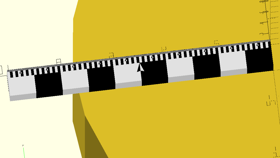

Many people have written rulers.  You can probably easily find a few with
google.  Also there's one in BOSL2:
include<BOSL2/std.scad>
cylinder(h=10,r=7.5,$fn=25);
ruler(10);
Of course, this ruler is part of your model, not something you can lay down
over your mode as you view it.
To the original poster I'd ask why you want to measure a distance.  What
are you planning to do with the result?  There may be some simple way to
achieve your end goal that doesn't require measuring.
with google.  Also there's one in BOSL2:
ruler(10);
down over your mode as you view it.
What are you planning to do with the result?  There may be some simple
way to achieve your end goal that doesn't require measuring.

I am working on a little sign in two parts, the sign itself and a support bracket.  I want to make sure that the connectors are the same distance apart and that the are far enough apart to fit over a bracket holding my monitor. -- Bob Truth is stranger than fiction because fiction has to make sense. On 8/28/21 7:41 AM, Adrian Mariano wrote: > Many people have written rulers.  You can probably easily find a few > with google.  Also there's one in BOSL2: > > include<BOSL2/std.scad> > cylinder(h=10,r=7.5,$fn=25); > ruler(10); > > Of course, this ruler is part of your model, not something you can lay > down over your mode as you view it. > > To the original poster I'd ask why you want to measure a distance.  > What are you planning to do with the result?  There may be some simple > way to achieve your end goal that doesn't require measuring. > > On Sat, Aug 28, 2021 at 2:32 AM Gene Heskett <gheskett@shentel.net > <mailto:gheskett@shentel.net>> wrote: > > On Friday 27 August 2021 22:18:03 Jordan Brown wrote: > > > On 8/27/2021 1:22 PM, Bob Ewart wrote: > > > If you have something like: > > > > > > translate([a,b,c]) { > > >     rotate([d,e,f]) { > > >         translate([g,h,i]) { > > > > > > OpenSCAD has to be keeping track of where you are. > > > > You might think so.  And it could.  But no, it doesn't. > > > > Turning the example into a concrete one: > > > >     translate([1,2,3]) { > >         rotate([4,5,6]) { > >             translate([7,8,9]) { > >                 cube(); > >             } > >         } > >     } > > > > the result of executing the OpenSCAD program is this CSG tree: > > > >     multmatrix([[1, 0, 0, 1], [0, 1, 0, 2], [0, 0, 1, 3], [0, 0, 0, > > 1]]) { multmatrix([[0.990737, -0.0982275, 0.0937587, 0], [0.104131, > > 0.992735, -0.0602863, 0], [-0.0871557, 0.069491, 0.993768, 0], > [0, 0, > > 0, 1]]) { multmatrix([[1, 0, 0, 7], [0, 1, 0, 8], [0, 0, 1, 9], > [0, 0, > > 0, 1]]) { cube(size = [1, 1, 1], center = false); > >         } > >       } > >     } > > > > It is a later stage, after the execution is done, after the program > > has any control, that actually does the geometric work. > > > > As nophead says, it's possible to do something equivalent in the > > OpenSCAD program, by carrying redefining the various transformations > > and using $ variables to pass down the accumulated transformation. > > > > Here's a thread that discusses some experiments in doing that: > > > https://forum.openscad.org/Some-thoughts-on-deriving-world-coordinates > <https://forum.openscad.org/Some-thoughts-on-deriving-world-coordinates> > >-for-objects-td30377.html > > > > Perhaps it would be a worthwhile project to make that capability > > available using the built-in transforms. > > > > > Even better would be to have /Point1 = [$X,$Y,$Z]; /A simple > > > function could calculate the distance between two such points. > > > > norm(p1-p2) will give you the distance between two points.  > But:  even > > with the $-variable trickery above, the "physics" of the OpenSCAD > > universe constrain what you can do.  OpenSCAD modules are black > holes; > > you cannot get information out of them.  Thus, if you have > > > >     ... some sequence of transforms ... { > >         A(); > >     } > >     ... some other sequence of transforms ... { > >         B(); > >     } > > > > although A() could maybe know where it is, and B() could maybe know > > where it is, nothing can know where *both* A() *and* B() are, > because > > there is no way to get the information out of the stack of > > transforms.  (Except via echo() or text(), but the information > is not > > then available to the OpenSCAD program.) > > > > > Angles could also be determined with three points. > > > > Yes, with some appropriate use of atan2(), but with the same physics > > limitations. > > I know I'd sure like to have the ruler thats located at 0,0,0 in the > display, made portable so its available to lay across a part to > find out > how big it is. That would be handier than the turn button on the > outhouse door at a family reunion. I'm also aware thats one very tall > order to do in 3d space. But the need is there. > > Cheers, Gene Heskett > -- > "There are four boxes to be used in defense of liberty: >  soap, ballot, jury, and ammo. Please use in that order." > -Ed Howdershelt (Author) > If we desire respect for the law, we must first make the law > respectable. >  - Louis D. Brandeis > Genes Web page <http://geneslinuxbox.net:6309/gene > <http://geneslinuxbox.net:6309/gene>> > _______________________________________________ > OpenSCAD mailing list > To unsubscribe send an email to discuss-leave@lists.openscad.org > <mailto:discuss-leave@lists.openscad.org> > > > _______________________________________________ > OpenSCAD mailing list > To unsubscribe send an email to discuss-leave@lists.openscad.org
