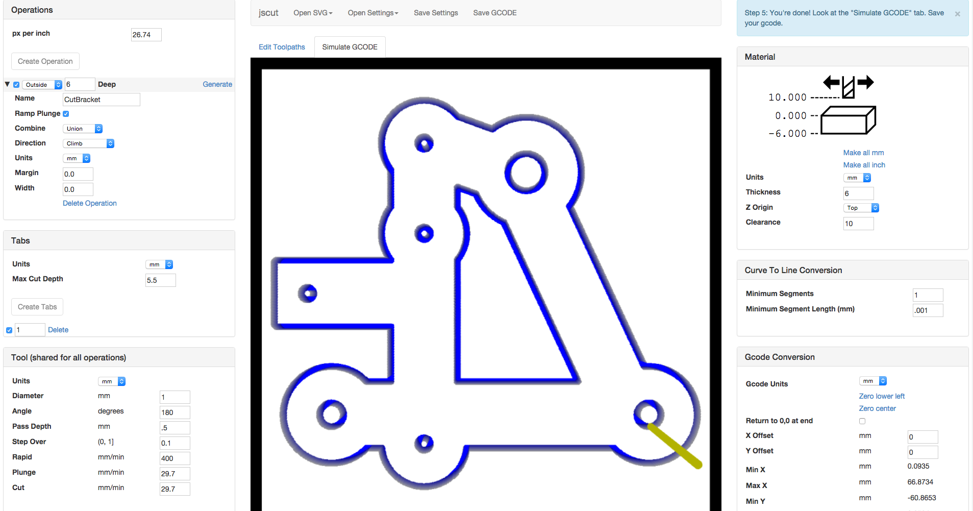

px to inch.
I just created my first part for CNC, using openscad, been using it for 3d
printing for a long time.
To get accurage parts using a openscad->svg->jscut->chillipeppr I found I
needed to set a px to inch in
jscut to a magic number of 26.74 which is a very different value.
Is this settable somewhere in openscad?
https://github.com/glennswest/metalcar.git
CNC Workflow:
Create part in openscad - Finish with a projection, and export to svg
open JScut in your web browser (http://jscut.org)
Setup your tool sizes (I use a 1mm bit)
Setup your PX to Inch to 26.74
Setup how thick you want to cut (6mm for dibond for me)
Select the object
Generate a outside cut
Save to ChilliPeppr via gdrive
Switch to http://chilipeppr.com/tinyg
Load the gcode using the jscut via gdrive
Preview to make sure it looks right
Start Cutting

I export DXF from OpenScad and use PyCam to make gcode tool paths. It all
works in mm, so no conversion factors needed.
