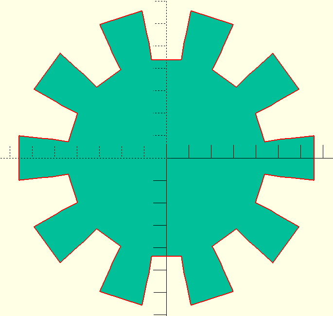

Using the code
include <MCAD/gears.scad>
gear(number_of_teeth=10,circular_pitch=200);
I get the picture as enclosed, where the teeth do no show a nice curve, and even seem to be larger at the tip than at the bottom.
What did I make wrong? Shouldn't it look like the involute at Wikipedia, i.e. like

Perhaps you want involute_gear_tooth()?

Well, the function/module gear() uses involute_gear_tooth() to create the tooth, and I think this is a more or less internal subroutine.
The module test_gears() just uses gear(), but the gears produced look also not encouraging.
So my question is if someone has already successfully created nice working gears with the library, and how this is done.

Perhaps you want MCAD\involute_gears.scad

I think that is a good idea. I used it some time ago with success, see
example at
http://arnholm.org/printing-3d-gears/
I found that the terminology of gears is somewhat (completely?)
inconsistent and depending on "who you talk to". It makes it hard if you
have not done this before as was the case for me.
In the example on that page I managed to print a gear that successfully
replaced a stripped plastic gear in a car ventilation system. It still
works :-)

Here's my replacement shredder gear, scad included:
http://www.thingiverse.com/thing:343602/
It uses the gear from MCAD/gears/involute_gears.scad from the dev branch, but
<MCAD/involute_gears.scad> from the latest MCAD release should work just as
well.
The most confusing thing about the involute_gears.scad module is that gear()'s
circular pitch is defined in terms of actual circular pitch / PI * 180, so you
need to flip that around. For convenience's sake, and to preserve the meaning of
circular_pitch so that older designs may continue working, I have created a
function called convertcp() that handles this for you.
