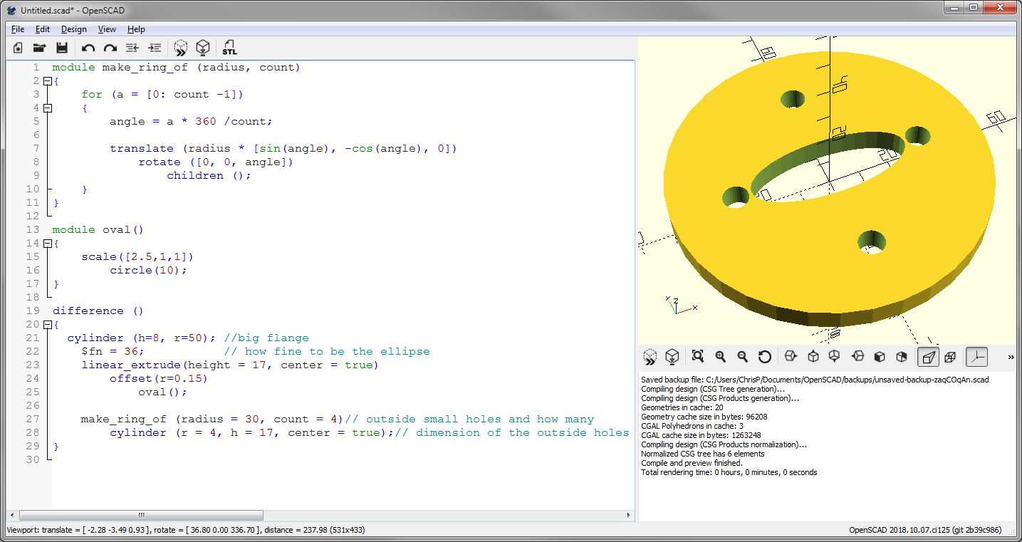

Hi. I need help with this code for a flange-- looks like is empty inside( i
need to be full) and is not totally through the ellipse and holes. Or a
better code for such a flange?

Is this what you are looking for?
There were lots of issues, center spelt wrong for OpenSCAD, translate and
difference with semicolon after them do nothing. Mixing 2D and 3D objects.
Passing h to offset.

Yes,nophead.Like yours is what i need.Can i have the code? Thank you.

Yes of course. Here is a slightly simplified version:
module make_ring_of (radius, count)
for (a = [0: count - 1])
rotate(a * 360 /count)
translate ([radius, 0])
children ();
module oval()
scale([2.5, 1])
circle(10);
difference () {
cylinder (h=8, r=50); //big flange
$fn = 36;          // how fine to be the ellipse AND the holes
linear_extrude(height = 17, center = true)
offset(r = 0.15)
oval();
make_ring_of (radius = 30, count = 4)// outside small holes and how many
    cylinder (r = 4, h = 17, center = true);// dimension of the outside
holes
Rather than translate to a point on a circle and then rotate the child I
have just translated along the radius and then rotated the translated
child.
I am not sure why you offset the oval. You could just pass the expanded size
