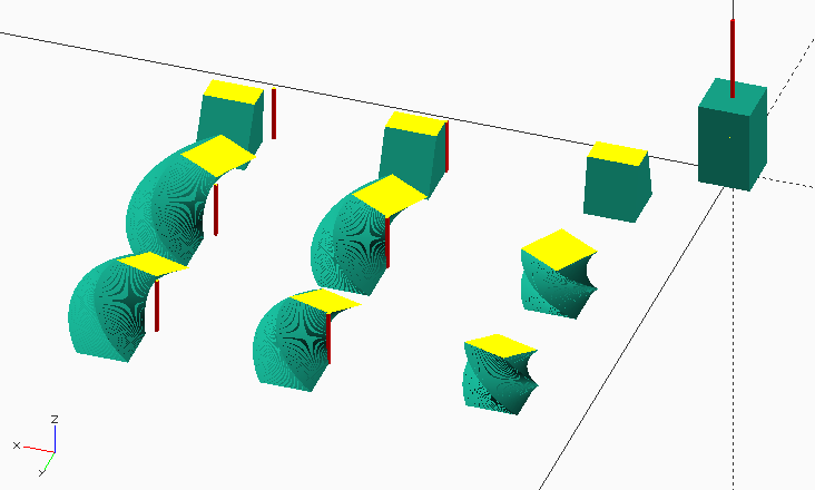

The really strange behavior of linear_extrude has not been considered here
yet. As many people has said, the scale in linear_extrude is taken relative
to the origin and that is true even for non-uniform scales. The same
happens with the twist which is essentially a continuous rotation along the
straight up path: the intermediate sections are rotations about the origin.
All that seems natural to me.
What is strange to me is the behavior when both a non-uniform scale and
twist are used in the same linear_extrude. As the picture bellow shows, the
intermediate sections of the linear_extrude of a square with non-uniform
scale and twist will not be a rectangle as might be expected. In the
picture, the intermediate sections (obtained by cutting the shapes at some
level) are displayed in yellow.
[image: linear_extrude_cases.PNG]

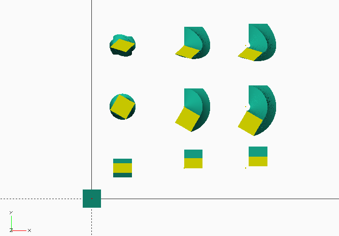

Top view:
[image: linear_extrude_top_view.PNG]
In the top view, the lower line has a scale and no twist, the second just
twist and, in the third, both are set. I would expect that the intermediate
sections in the third line be rotations of the scaled base square, and so,
it would be a rectangle. However, it is the scale of the rotated base
square. This order of applying the transforms deforms the shape in an
unexpected unreasonable way. That seems a bad choice and should be
considered a bug to be corrected.
I have written a code in user's space to linear extrude a polygon expressed
by its vertices that applies the rotation after the scale and published it
in another thread (
http://forum.openscad.org/Weird-intersection-results-tp28232p28253.html).
h  = 5;      // linear_extrude height
a  = 180;    // twist angle
s  = [1,0.3]; // scale
cut = 2/3;    // height level cut
tower(1,0,[0,0,0]); // at the origin
union(){
translate([5, 5,0])  triplet(s,0);
translate([5,15,0])  triplet(1,a);
translate([5,25,0])  triplet(s,a);
color("yellow")
cube([1000,1000,2*h*cut],center=true);
module axis()
color("red")
translate([-0.1,-0.1,0])
  cube([0.2,0.2,10.1]);
module tower(s,t,c) {
linear_extrude(h, scale=s, twist=t, slices=100, convexity=4)
translate(c)
  square(3,center=true);
axis();
module triplet(s=1,t=0)
translate([ 0,0,0]) tower(s,t,[0,0,0]);
translate([10,0,0]) tower(s,t,[1.5,1.5,0]);
translate([20,0,0]) tower(s,t,[2,2,0]);
The really strange behavior of linear_extrude has not been considered here yet. As many people has said, the scale in linear_extrude is taken relative to the origin and that is true even for non-uniform scales. The same happens with the twist which is essentially a continuous rotation along the straight up path: the intermediate sections are rotations about the origin. All that seems natural to me. What is strange to me is the behavior when both a non-uniform scale and twist are used in the same linear_extrude. As the picture bellow shows, the intermediate sections of the linear_extrude of a square with non-uniform scale and twist will not be a rectangle as might be expected. In the picture, the intermediate sections (obtained by cutting the shapes at some level) are displayed in yellow. [image: linear_extrude_cases.PNG] Top view: [image: linear_extrude_top_view.PNG] In the top view, the lower line has a scale and no twist, the second just twist and, in the third, both are set. I would expect that the intermediate sections in the third line be rotations of the scaled base square, and so, it would be a rectangle. However, it is the scale of the rotated base square. This order of applying the transforms deforms the shape in an unexpected unreasonable way. That seems a bad choice and should be considered a bug to be corrected. I have written a code in user's space to linear extrude a polygon expressed by its vertices that applies the rotation after the scale and published it in another thread ( http://forum.openscad.org/Weird-intersection-results-tp28232p28253.html). h = 5; // linear_extrude height a = 180; // twist angle s = [1,0.3]; // scale cut = 2/3; // height level cut tower(1,0,[0,0,0]); // at the origin intersection() { union(){ translate([5, 5,0]) triplet(s,0); translate([5,15,0]) triplet(1,a); translate([5,25,0]) triplet(s,a); } color("yellow") cube([1000,1000,2*h*cut],center=true); } module axis() color("red") translate([-0.1,-0.1,0]) cube([0.2,0.2,10.1]); module tower(s,t,c) { linear_extrude(h, scale=s, twist=t, slices=100, convexity=4) translate(c) square(3,center=true); axis(); } module triplet(s=1,t=0) { translate([ 0,0,0]) tower(s,t,[0,0,0]); translate([10,0,0]) tower(s,t,[1.5,1.5,0]); translate([20,0,0]) tower(s,t,[2,2,0]); }
