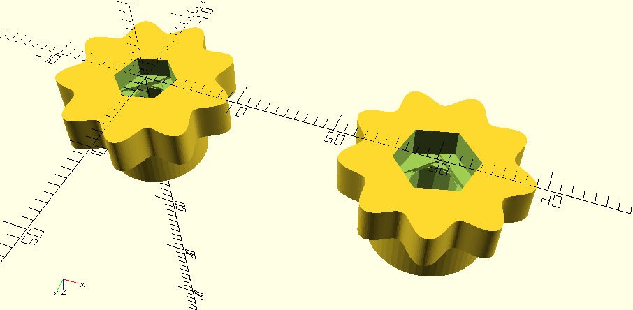

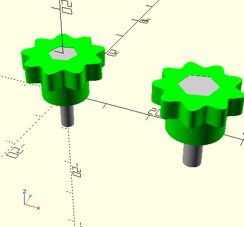

Here is simple example. I have these printed knobs that take a hex screw.
They are printed upside down with a complicated hanging hole that can be
printed without support material.  See
http://hydraraptor.blogspot.com/2014/03/buried-nuts-and-hanging-holes.html
They were taking six seconds to preview when wrapped with render() because
the hole is being subtracted from a complex shape in 3D. This was the
original code

To make it faster I now have this:
module screw_knob(screw) {
stl(str("screw_knob_M", screw_radius(screw) * 20));
 knob_stem_r = nut_trap_radius(screw_nut(screw)) + knob_wall;
 function wave(a) = knob_r + sin(a * knob_waves) * knob_wave;
     render() difference() {
         cylinder(r = knob_stem_r, h = knob_thickness + knob_stem_h);
         hanging_hole(knob_nut_trap_depth(screw),
screw_clearance_radius(screw))
rotate(45)
circle(r = nut_trap_radius(screw_nut(screw)), $fn = 6);
linear_extrude(height = knob_thickness, convexity = 3)
polygon(points = [for(a = [0 : 359]) [wave(a) * sin(a),
wave(a) * cos(a)]]);
             circle(knob_stem_r - eps);

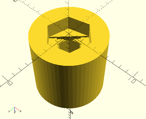

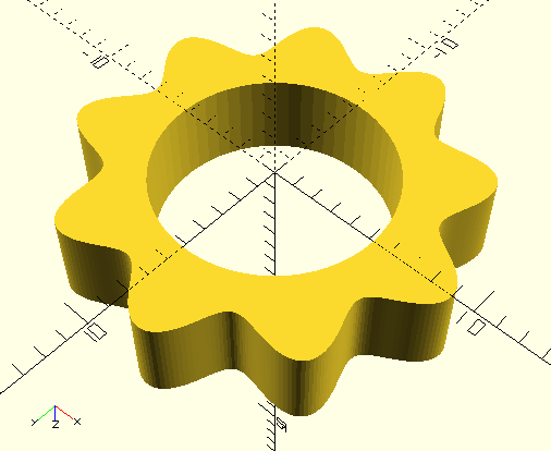

The differences is now a on a plain cylinder, so is a lot faster because
there are less vertices and CGAL slows with the square of the vertices I
think.
I then union with the outer bit, which I make with a slightly smaller
hole in the middle. That is very fast because it is an extruded 2D shape
and I don't need to use CGAL when previewing unions.
So my test which draws two difference sizes goes from 6 seconds, to 0
seconds.

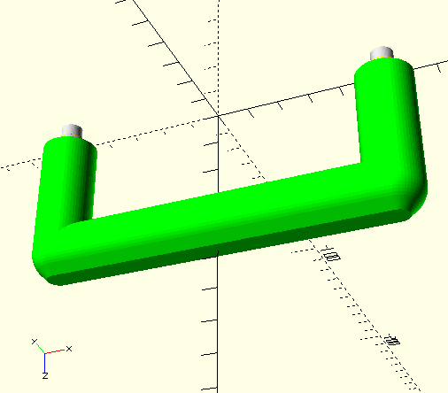

E.g. This handle which also prints without support material was very slow
module handle_stl() {
stl("handle");
     translate_z(dia / 2)
             hull()
                 handle_screw_positions()
                     rotate_extrude()
                             rotate(180)
                                 teardrop_2D(r = dia / 2);
                             translate([0, - (dia + 1) / 2])
                                 square([dia / 2 + 1, dia + 1]);
                 cylinder(d = dia, h = height + dia / 2);
         translate_z(dia + height) {
             insert_hole(insert);
             poly_cylinder(r = screw_clearance_radius(screw), h =
(insert_length(insert) + 6) * 2, center = true);
I got it down to a couple of seconds like this:
stl("handle");
 module end(end)
     translate([end * pitch / 2, 0])
         rotate_extrude()
                 rotate(180)
                     teardrop(r = dia / 2, h = 0);
         hull() {
             end(-1);
             end(1);
                 h =  height + dia / 2;
                 cylinder(d = dia, h = h);
                 translate_z(h)
                     insert_hole(insert, 6);
Again moving the subtraction to a simple cylinder and placing the ends in
the hull with repetition instead of a loop to avoid unioning two objects
with a lot of vertices before the hull is taken.

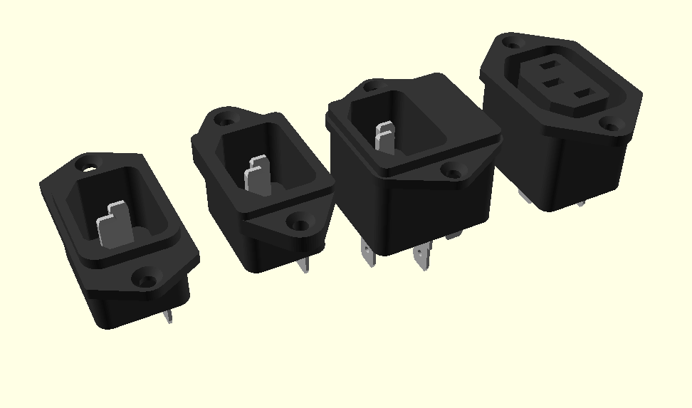

I have been going through all my objects rewriting them to be unions of
extruded 2D objects to avoid as many 3D differences and  intersections as I
can. By doing that I have reduced the time to draw all my objects from 972
seconds to 194.
I have learned a few tricks on the way to make things that look
inescapably 3D out unions of extruded 2D. For example these draw in 0
seconds. I think they used to take about 17.
I previously made the cavities by subtracting two linear extrudes. That
takes ages because I render all differences with CGAL to avoid clashes
between negative objects and the curved cavities have lots of vertices. I
now linear extrude the difference to make the walls of the cavity and then
fill in the back with another linear extrude.
The countersinks are creative because on the face of it you need to
subtract 3D shapes. What I actually do is put some slightly bigger straight
holes in the linear_extrude() of the flange by subtracting circles. I then
rotate_extrude a cylinder with the counter sunk hole in it and union those
into the holes in the flange. Union is free in preview because it just
draws both parts and there is never any z-fighting if they are the same
colour.
I did the opposite thing with countersunk, pan and dome screw heads.
I rotate extrude the basic shape of the head with a cylinder missing
where the slots go and the linear extrude a circle with the slot cut in it
and inlay it into the head.
It has taken me weeks because I have had to re-code everything, moving
all the differences and intersections into 2D.
rotate(45)
6);
think.
seconds.
stl("handle");
             hull()
                     rotate_extrude()
                             rotate(180)
stl("handle");
 module end(end)
         rotate_extrude()
                 rotate(180)
         hull() {
             end(-1);
             end(1);
                 translate_z(h)
seconds to 194.

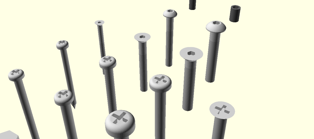

colour.
