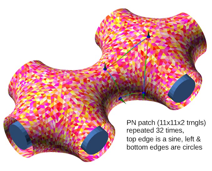

  • xing_test
    Input: Four points with simple and intuitive unit normals.
    *Output: *The quad patch is interpolated and replicated 32 times.
    This gives a system of sprues with perfectly circular cross sections
    and with perfectly sine-shaped longitudinal cuts. The sprues form
    perfectly circular holes.

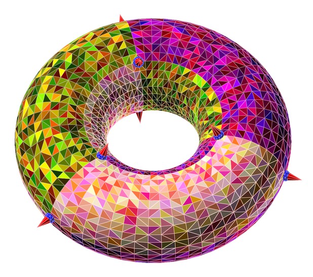

  • torus_test_3x3
    *Input: *3x3 points with normals, regularly placed on a torus.
    Output: The nine patches interpolate to a perfect torus.

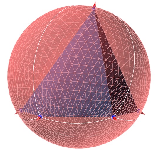

  • pyramid_test
    *Input: *An irregular pyramid made of four triangles and a quad. All
    of its corners are on a sphere and the unit normals are taken
    directly from the points.
    Output: The pyramid interpolates to a perfect sphere.

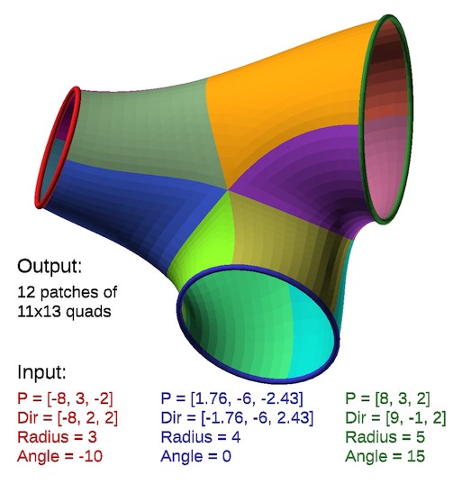

  • tripod_from_PDRAs
    *Input: *Three points with unit directions, radii and (negative or
    positive) opening angles.
    *Output: *A smooth bordered surface spanned by the given pod ends.
    By the way, symmetric, parallel, diverging pods with other lengs of
    legs work as well.
