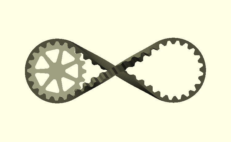

I believe the twist deforms the belt teeth (by shear).  You may want to
focus on what you really want the belt to do and start simpler and then
move towards more complex.  The example is a little silly, since you
wouldn't want a belt to turn inside-out.

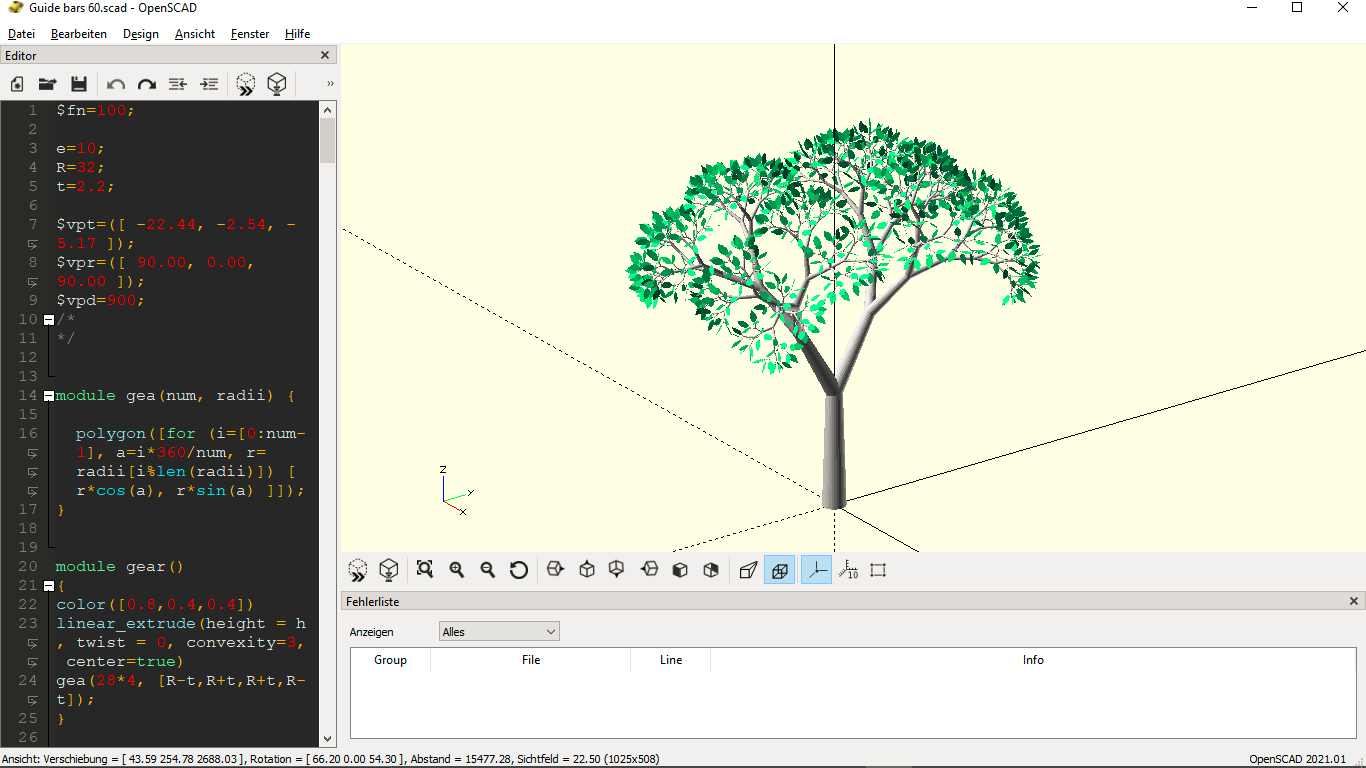

A beautiful tree and no error messages. 2021.01 did the trick, thanks for
the tip.
The belt looks interesting, the twist could be useful. Will try to
re-engineer the code to my requirements, but hope I will not find myself
out of my depth. I only need it for one project, but maybe I can learn
something.

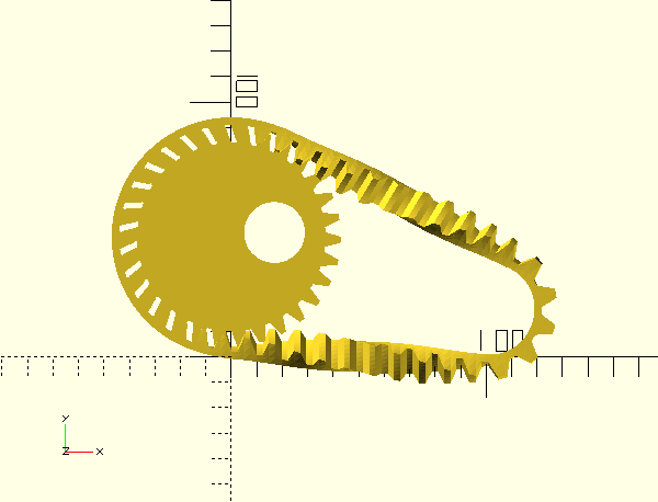

True, but twist is acceptable if the belt is long enough.
The example is not so silly if the straight runs cross over as per my attempt (animation) earlier in this thread - then both ends are the right way round. It is not ideal for the straight runs to rub against each other in the middle, even if only back-to-back, but OK in a low-power (hand-operated) application.
What I am after ultimately is a better version of that animation that can be combined with other moving parts in a way that makes sense. But OpenSCAD has limits on what can be done with animation anyway. In the animation I did, all the teeth only move back and forth one position (slow forward, instantaneous back) giving the illusion of continuous motion. Also only the straight runs are actual “belt”. The curved sections are only stationary black semicircles behind the cogs.
What I imagine is required is some kind of flexible polygon, or a means of sending each belt tooth around a defined path. The speeds of the belt and the cogs obviously need to reflect the number of teeth on each. The more I think about it and the more I look at the Toothed belt.scad code, the more I think it can’t be done, unfortunately.
Adrian Mariano wrote: > I believe the twist deforms the belt teeth (by shear). You may want to > focus on what you really want the belt to do and start simpler and then > move towards more complex. The example is a little silly, since you > wouldn't want a belt to turn inside-out. True, but twist is acceptable if the belt is long enough. The example is not so silly if the straight runs cross over as per my attempt (animation) earlier in this thread - then both ends are the right way round. It is not ideal for the straight runs to rub against each other in the middle, even if only back-to-back, but OK in a low-power (hand-operated) application. What I am after ultimately is a better version of that animation that can be combined with other moving parts in a way that makes sense. But OpenSCAD has limits on what can be done with animation anyway. In the animation I did, all the teeth only move back and forth one position (slow forward, instantaneous back) giving the illusion of continuous motion. Also only the straight runs are actual “belt”. The curved sections are only stationary black semicircles behind the cogs. What I imagine is required is some kind of flexible polygon, or a means of sending each belt tooth around a defined path. The speeds of the belt and the cogs obviously need to reflect the number of teeth on each. The more I think about it and the more I look at the Toothed belt.scad code, the more I think it can’t be done, unfortunately.

It's not that the belt twists but that the teeth themselves deform
into a shear-transformed shape.  Actual twist of a real belt
presumably twists only the belt and not the teeth.
Your requirements seem fairly simple, so I'm not sure why you think it
can't be done.  Very complicated things can be done, and a belt is
not really particularly complicated.  The existing belt is already
set up for animation, with steps 4.  It doesn't go very fast.  The
notion of "sending the teeth along a path" is really exactly what's
going on right now.  Notice how beltpath is computed and then used to
compute the belt, with the teeth offset controlled by $t.

I have now found the animation - I must have blinked and missed the movement the first time I looked at it.
It is indeed rather slow at $t*4, much slower than parts that have to move at $t*360 to complete full rotations or cycles, e.g. translate([0,0,x*sin($t*360)]).
In the animation below, the cogwheel is slowed to $t*180, as the eccentric hole shows, and the belt is running at $t*64, which results in it sort of doing 3 steps forward and 2 steps back, which shows in the changing interference patterns generated by the teeth. Apart from that, adjusting parameters in the belt program often produces some strange results.
How can the speeds of the belt and cogwheel (together with other parts) be matched so that a mechanism runs in a smooth and meaningful way?

Well, you see, I wrote that example by copying another example and the
animation stuff was already there.
I don't know what translate([asin($t360),0,0]) has to do with
anything.  You can't transform some other component in isolation.  You
need to know how the parts are going to interact.  Right now the belt
has four steps.  If you want the belt to actually complete a full
revolution for some reason you'll need 4teeth steps and then you'll
need to use teeth
$t instead of $t, or something like that.  Maybe
best to do it mod 4?  (Mod 8?)  Knowing how to include the wheel
requires knowing the teeth size on the wheel.
Jordan said $t went between 0 and 1, but I'm observing it going
between 0 and 8, which seems a little strange.  But I haven't been
able to get the belt to work with 168 steps (going all the way around)
and am not sure why...which gets back to what I said before about I
not really understanding the animation system.  It should be trivial
to make this change and for some reason it is not.
