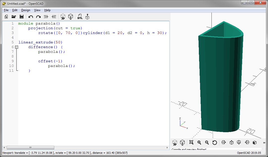

A parabola is a conic section so you could rotate a cone and use
projection(cut = true) it to get one. If you want a hollow tube you could
subtract an offset version of it and then linear_extrude it.

Tue, Apr 14, 2020 2:31 PM

What Nop Head did is not what I meant.
Think of plotting a parabola like in highschool. But now I want to 3D
print that curve, so instead of the line on the paper, I want to give
it some thickness. For my current project I don't need it hollowed
out. But if we specifiy the parabola and an R, specifying the same
parabola and R- wall_thickness you can subtract that to get a tube.

On Tue, Apr 14, 2020 at 03:39:14PM -0700, adrianv wrote:
Here's another option for sweep using BOSL2 (though be warned that BOSL2 is
under development):
https://github.com/revarbat/BOSL2/wiki/skin.scad#path_sweep
include<BOSL2/std.scad>
include<BOSL2/skin.scad>
curve = [for(x=[-2:.1:2]) [x,x*x,0]];
path_sweep(circle(r=.1, $fn=16), curve);
The result looks like this:
http://forum.openscad.org/file/t2477/parabola.png
I think this one takes the cake! As to openscad... wouldn't the "path-sweep" be something that could be considered a "core-item"? This can be accomplished in two ways. The first would be to add a path_sweep to the language and to implement linear extrude and rotate-extrude as special cases of the path_sweep from now on... On the other hand... (or maybe in any case)... ... would it be an idea to have some system scad "library" files that come with openscad so that this path-sweep might be kept there so that we can say that "path-sweep" is supported by openscad. The "in any case" situation arises when it would be chosen to implement the path-sweep as a primitive. In that case linear_extrude would become an easy small scad source to provide backward compatibility and ease-of-use for a common case.... Roger. On Tue, Apr 14, 2020 at 03:39:14PM -0700, adrianv wrote: > Here's another option for sweep using BOSL2 (though be warned that BOSL2 is > under development): > > https://github.com/revarbat/BOSL2/wiki/skin.scad#path_sweep > > include<BOSL2/std.scad> > include<BOSL2/skin.scad> > > curve = [for(x=[-2:.1:2]) [x,x*x,0]]; > path_sweep(circle(r=.1, $fn=16), curve); > > > The result looks like this: > > <http://forum.openscad.org/file/t2477/parabola.png> > > > > -- > Sent from: http://forum.openscad.org/ > > _______________________________________________ > OpenSCAD mailing list > Discuss@lists.openscad.org > http://lists.openscad.org/mailman/listinfo/discuss_lists.openscad.org > -- ** R.E.Wolff@BitWizard.nl ** https://www.BitWizard.nl/ ** +31-15-2049110 ** ** Delftechpark 11 2628 XJ Delft, The Netherlands. KVK: 27239233 ** The plan was simple, like my brother-in-law Phil. But unlike Phil, this plan just might work.
