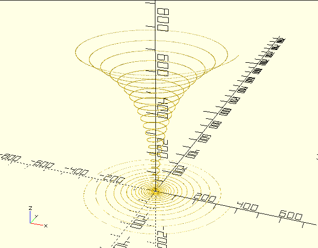

Here's something that turns that formula into OpenSCAD and draws some
lines. The next step (which I do not have time for at the moment) is to
sweep the points with a circle). But see the important caveat below.
maxPhi = 7200;
alpha = 10;
kappa = 0.0005;
stretch = 0.1;
function toRect2(p) = [
p[0] * cos(p[1]),
p[0] * sin(p[1])
function logSpiralR(phi, alpha, kappa) = alpha * exp(kappa * phi);
function logSpiral(phi, alpha, kappa) =
toRect2([logSpiralR(phi, alpha, kappa), phi]);
function logHelix(phi, alpha, kappa, stretch) = concat(
logSpiral(phi, alpha, kappa),
phi * stretch);
for (phi=[0:maxPhi]) {
translate(logSpiral(phi, alpha, kappa)) square(2, center=true);
translate(logHelix(phi, alpha, kappa, stretch)) cube(2, center=true);
My aim is to create someting like that -->
https://www.kl-angelsport.de/images/thumbnail/produkte/medium/saenger_1907050.jpg
But that function produces a shape that expands to infinity,
accelerating its expansion, as you move along it, and that's not what
this image shows. I suspect that you want a function where the key
piece is log() rather than exp(), but again I'm out of time right now.

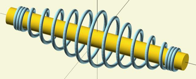

Here's my approximation. Only the stroke() command requires the BOSL2 library:
$fn = 45;
wire_d = 2;
spring_l = 100;
spring_d = 20;
rod_d = 10;
r_table = [
[0.00, 0],
[0.17, 0],
[0.50, 1],
[0.83, 0],
[1.00, 0],
l_table = [
[0.00, -0.50],
[0.17, -0.45],
[0.20, -0.42],
[0.80, +0.42],
[0.83, +0.45],
[1.00, +0.50],
loops = 17;
lsteps = 45;
tsteps = loops * lsteps;
path = [
for (i = [0:1:tsteps])
let(
u = i / tsteps,
a = u * 360 * loops,
r = lookup(u, r_table) * spring_d/2 + wire_d/2 + rod_d/2,
z = lookup(u, l_table) * spring_l,
pt = [r*cos(a), r*sin(a), z]
) pt
rotate([0,90,0]) {
color("lightblue") stroke(path, width=wire_d);
cylinder(d=rod_d, h=spring_l+10, center=true);
Very elegant, Revar, not that I am surprised.

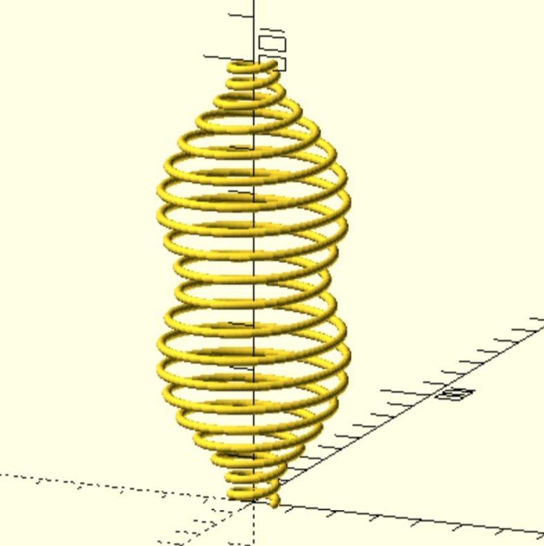

Revised code to ensure "perfect" end wrap spacing of the spring wire if you modify wire_d:
$fn = 45;
wire_d = 2;
spring_l = 100;
spring_d = 20;
rod_d = 10;
loops = 17;
tight_loops=3;
tpart = tight_loops/loops;
lpart = wire_d * tight_loops / 100;
r_table = [
[0.00, 0],
[0.17, 0],
[0.50, 1],
[0.83, 0],
[1.00, 0],
l_table = [
[0.00, -0.50],
[0+tpart, -0.5+lpart],
[1-tpart, +0.5-lpart],
[1.00, +0.50],
lsteps = 45;
path = [
let(
u = i / tsteps,
) pt
yrot(90) {
color("lightblue")
path_sweep(circle(d=wire_d), path);
