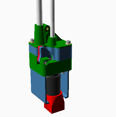

Not really. I colour printed parts in my design contrasting colours to be
able to see where one part ends and another starts. I start with RepRap
green and if there is a mating part it is coloured red and then blue, etc.
When I printed it it was all one colour but I don't even remember what it
was. Most likely black,  whatever ABS I had loaded at the time on the
machine I used to print it. It doesn't matter what colour it is, the design
will still function but it matters that it isn't PLA or TPU. I might print
the next one in transparent PC.
