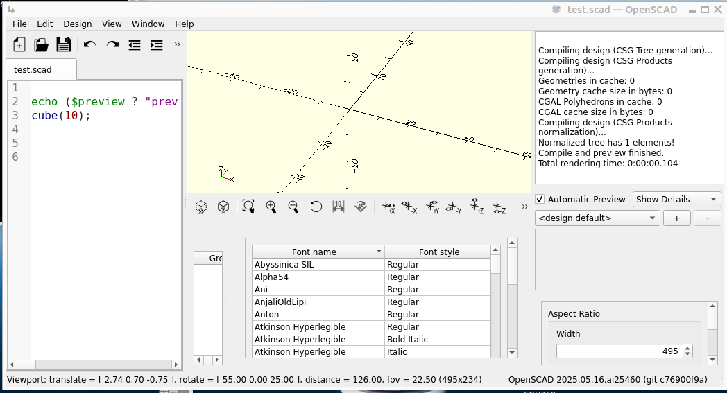

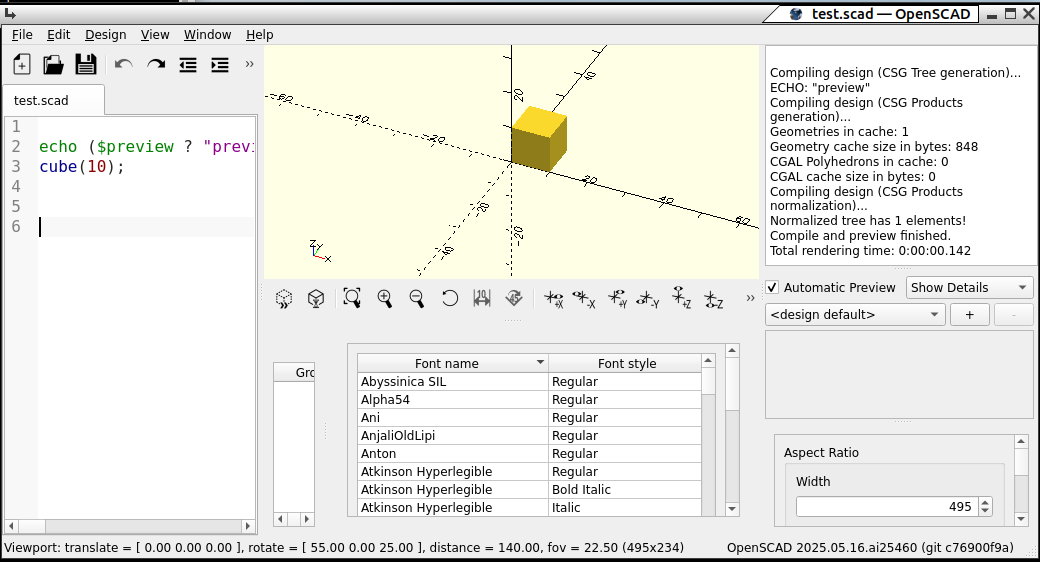

I am running OpenSCAD version 2025.05.16.ai25460 (git c76900f9a)
on Ubuntu 22.04.5 LTS.
That box was not checked. Note that previously it was a render that it
did, and not a preview. When I check that box, it will preview as soon
as it loads, which is not nearly as bad, being, in general, shorter
than a render.
I then unchecked that box, and now it still previews when I double-
click the SCAD file, but does not preview when I load OpenSCAD and
drag/drop the same file into OpenSCAD.
I'm testing with a simple cube;
echo ($preview ? "preview" : "render");
cube(10);
In both attached images, 'Automatic Reload and Preview' was NOT
checked, but double-clicking on test1.scad gave me the result in the
When I loaded OpenSCAD and drag/dropped test1.scad into it, test2.png
was the result.

On Tue, 2025-06-10 at 13:52 -0700, Jordan Brown wrote: > On 6/10/2025 1:37 PM, larry via Discuss wrote: > > Have I inadvertently set something in preferences that causes a > > render when I load a script? > Quite possibly.  Look at the Design menu, at the "Automatic Reload > and Preview" option at the top. I am running OpenSCAD version 2025.05.16.ai25460 (git c76900f9a) on Ubuntu 22.04.5 LTS. That box was not checked. Note that previously it was a render that it did, and not a preview. When I check that box, it will preview as soon as it loads, which is not nearly as bad, being, in general, shorter than a render. I then unchecked that box, and now it still previews when I double- click the SCAD file, but does not preview when I load OpenSCAD and drag/drop the same file into OpenSCAD. I'm testing with a simple cube; echo ($preview ? "preview" : "render"); cube(10); In both attached images, 'Automatic Reload and Preview' was NOT checked, but double-clicking on test1.scad gave me the result in the attached test1.png When I loaded OpenSCAD and drag/dropped test1.scad into it, test2.png was the result. > > If I run OpenSCAD and drag/drop a .scad file into it, it doesn't > > render > > it immediately. > > > > If I double-click on a .scad file, it loads, and immediately starts > > rendering. Of course I can't immediately stop it, which is a real > > time > > waster. > > > > Or is it a bug? >   >  It does seem like a bug if those two cases are handled differently. > (But my experiments have drag-and-drop previewing immediately, just > like double-click-to-open.) >   >
