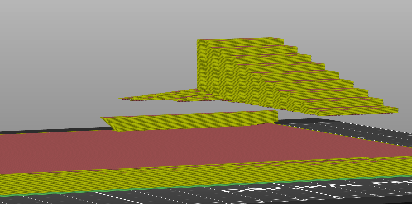

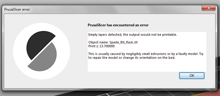

I can confirm that it errors out with Prusa Slicer but Simplify3D has no problem with it. Meshmixer doesn't find any errors either.
Prusa Slicer makes a good section of the model disappear!
I don't have the OpenSCAD skills to make suggestions how to adjust your code to remove the Prusa failure.

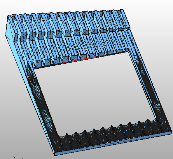

The STL has degenerate triangles and self intersections according to
NetFabb studio.
Something in the design must generate vertices too close together for
OpenSCAD.
