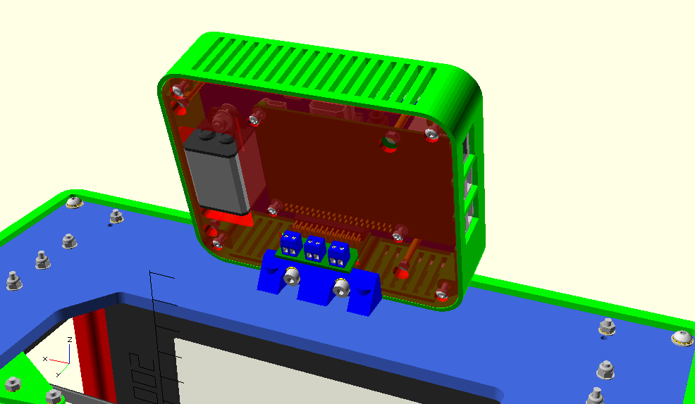

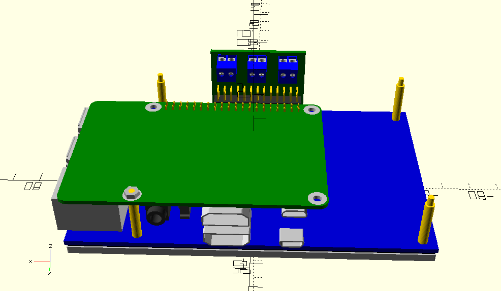

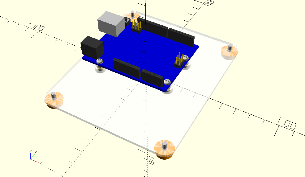

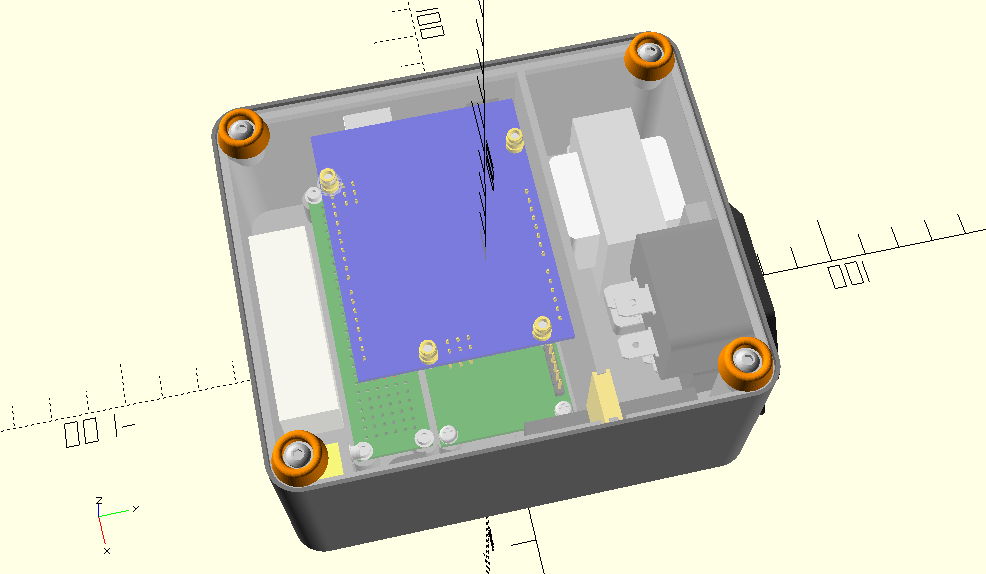

Fri, Aug 17, 2018 8:13 AM
The way I handle that is to make a module that places its children where
the holes are, relative to the PCB. I use that to make the holes in the
PCB, the mounting pillars in my case and the fasteners by calling it with
the appropriate children. I never repeat complex calculations. I always put
them in a module or a function or a variable.
Here is a little example:
module base_additions() {
translate([arduino_x, -arduino_y])
pcb_screw_positions(arduino) {
insert_boss(arduino_insert, case_height - arduino_z);
        insert_boss(arduino_insert, case_height - arduino_z - 2, 2);
module base_holes() {
module base_stl() printed_case_base() { base_additions(); base_holes(); }
module arduino_assembly() {
pcb(arduino);
    insert(arduino_insert);
    translate([0, 0, pcb_thickness(arduino)])
        screw(arduino_screw, arduino_screw_length);
module base_assembly() {
assembly("base_assembly");
feet_positions() vflip() {
    color(pp4_colour) render()
        foot_stl();
    translate([0, 0, foot_thickness(foot)])
        screw_and_washer(base_screw, base_screw_length);
translate([arduino_x, -arduino_y, case_height - arduino_z])
    arduino_assembly();
color(pp2_colour, 0.5) render() base_stl();
end("base_assembly");

The screws in this tilted display assembly have a very complicated position
in the final assembly because the RPI is stacked on the back of a LCD
display. For aesthetic reasons the display is in the centre of the tilted
box. Its PCB is offset from the display. It has mounting pillars with
positions specified relative to the PCB, one of which goes through the RPI
which is upside down.
So I have code like this to line them up by mating one pair of screw holes:
pcb_offset = [display_pcb_offset(display).x, display_pcb_offset(display).y];
mating_hole = 2;
rpi_hole = pcb_coord(rpi, pcb_holes(rpi)[1]);
lcd_hole = pcb_coord(pcb, pcb_holes(pcb)[mating_hole]) + pcb_offset;
rpi_offset = [lcd_hole.x - rpi_hole.x,
lcd_hole.y + rpi_hole.y];
But no matter how ugly it is I only ever need to write it once.
