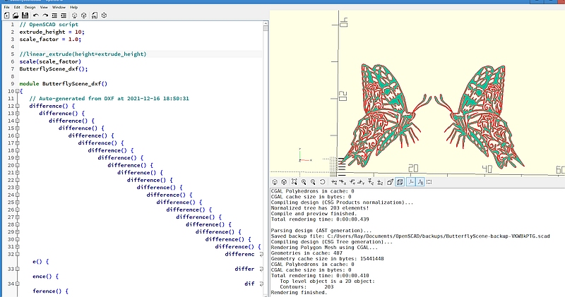

Thu, Dec 16, 2021 7:28 PM
On 16/12/2021 15:57, Carsten Arnholm wrote:
  1. Create valid .scad file from DXF, even if it contains features
    unsupported by OpenSCAD (e.g. splines).
In this case you can use the command line utility 'dxfread' that is
installed with AngelCAD, for example (assuming your PATH setting
includes the AngelCAD install folder);
C:\somedir> dxfread -scad with_splines.dxf
This creates a new file "with_splines.scad" containing a module
"with_splines_dxf()" which is accepted by OpenSCAD because it is just
a combination of booleans between polygons (the polygon discretization
can be modified using the -sectol option).
and if you want it as 2d, easy to remove the linear extrude, unlike my
suggested method that produced a polyhedron, not a polygon. In windows,
worth making a batch file - If i can remember how.
Well, I've managed to hack together a simple bat file, and gone back
through the numerous dxf files I've created/accumulated over the last 30
or so years. I've not found any that I can't use the dxfread conversion
to get a useable (albeit a ton of polygons) scad file. The drawing below
also opens by importing the dxf directly to openscad, but the solids are
holes, and the holes are solids if I tried printing that, it would be a
multitude of pieces. And, the direct import does not show the code, so
there could be a restriction on the editing that could be done.
On 16/12/2021 15:57, Carsten Arnholm wrote: > > > 2. Create valid .scad file from DXF, even if it contains features > unsupported by OpenSCAD (e.g. splines). > ================================================================ > > In this case you can use the command line utility 'dxfread' that is > installed with AngelCAD, for example (assuming your PATH setting > includes the AngelCAD install folder); > > C:\somedir> dxfread -scad with_splines.dxf > > This creates a new file "with_splines.scad" containing a module > "with_splines_dxf()" which is accepted by OpenSCAD because it is just > a combination of booleans between polygons (the polygon discretization > can be modified using the -sectol option). > > and if you want it as 2d, easy to remove the linear extrude, unlike my suggested method that produced a polyhedron, not a polygon. In windows, worth making a batch file - If i can remember how. Well, I've managed to hack together a simple bat file, and gone back through the numerous dxf files I've created/accumulated over the last 30 or so years. I've not found any that I can't use the dxfread conversion to get a useable (albeit a ton of polygons) scad file. The drawing below also opens by importing the dxf directly to openscad, but the solids are holes, and the holes are solids if I tried printing that, it would be a multitude of pieces. And, the direct import does not show the code, so there could be a restriction on the editing that could be done.
