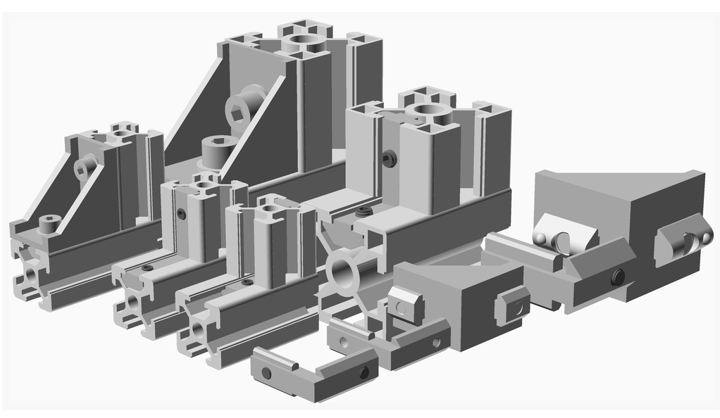

There is no concept of anchors in NopSCADlib. You can retrieve all the
properties of the extrusion using the functions documented here:
https://github.com/nophead/NopSCADlib/tree/master?tab=readme-ov-file#extrusions
extrusion_width(type) will return the width of the extrusion in this case
and there is also extrusion_height(type), which will be different if the
extrusion isn't square.
When you draw the extrusion with extrusion(type, length, center = true,
cornerHole = false) you can choose its origin to be in the centre or the
lower end, like a cylinder.

There are always functions or modules to get enough information from my
vitamins to be able to place them in a design. They wouldn't be useful
otherwise.
For example, these extrusion brackets are placed relative to extrusions and
the code for all the examples is linked to in the documentation.
https://github.com/nophead/NopSCADlib/tree/master?tab=readme-ov-file#extrusion_brackets

Sorry. It is not clear to me what some of the documentation meant/means.
Looking at the code in
https://github.com/nophead/NopSCADlib/blob/master/vitamins/extrusion_bracket.scad
it looks like what I may need is
extrusion_inner_corner_bracket_screw_offsets(type) (which for
'E20_inner_corner_bracket' returns [7, 6] and is later used with
screw_offsets.y and x to find the placement of the sliding nut). As a
note, when I read through the extrusion code I thought there would be some
function there, but see that you have functions and modules for the
brackets which I can extract some of the meaning from. I had just wondered
if there was a convenience function to provide it at the extrusion level.
Thank you for pointing me to the brackets.
otherwise.
and the code for all the examples is linked to in the documentation.
