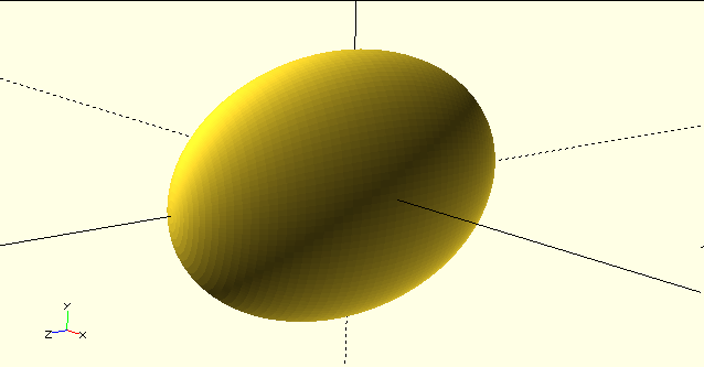

So, here is my compact code for the super ellipsoid. I used a tricky hull
to display the output. However this obviously only works for convex shapes
i.e. nx, ny, nz values >= 1
points = Superellipse(a=10, b=20, c=30, nx=2, ny=2, nz=2, step=3);
// draw point cloud (hull() works for convex shapes only)
hull() polyhedron(points, [[for(i=[0:len(points)-1]) i]]);
function Superellipse(a=1, b=1, c=1, nx=2, ny=2, nz=2, step=10) =
[ for(u=[-90:step:90], v=[0:step:360])
let(x = a*sign(cos(u)) *pow(abs(cos(u)),2/nx) *
sign(cos(v))pow(abs(cos(v)),2/ny))
let(y = b
sign(sin(v))pow(abs(sin(v)),2/ny))
let(z = c
sign(sin(u)) *pow(abs(sin(u)),2/nz))
[x,y,z]

To make it clear again: It was not at all my intention to discuss the
hack or any BOSL2 implementations of it. We all know and I think I
pointed that out that it is just a one-liner vehicle to display the
result of Superellipse() in a concise way.  My point is that
Superellipse() would be a powerful candidate for a primitive.

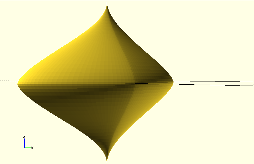

I am not a BOSL2 user, but the point cloud can also be constructed to be
easily skinable. So the following formulation of the function will allow
to display the full parameter range of super ellipsoids. (partial)
concave shapes result from nx, ny, or nz <1
include <BOSL2/skin.scad>
points = Superellipse(a=5, b=12, c=10, nx=0.5, ny=1.5, nz=1.5, step=3);
skin(points, slices =1, closed=true);
  for(v=[.5:step:359.5])
    for(u=[-90:step:90])
      let(y = b
      let(z = c
      [x,y,z]
