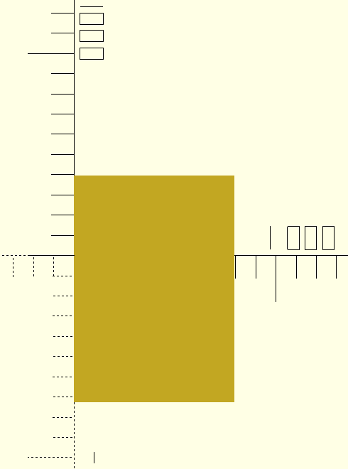

Hello,
I am currently struggling to understand the logic of object location from imported svg files.
So I draw with Inkscape an A4 (210×297mm) rectangle on an A4 document, with an A4 viewport. For the SVG file, the top left angle is at 0,0.
When imported with import(“A4.svg“), OpenScad uses pixel units as is, and millimeters from the svg file are converted to pixels at 96 dpi. So it draws a rectangle of 793.7×1122.5. But it puts the top left angle at coordinates 0,396.
I don’t understand where this y=396 come from. I should expect that the top left corner be at 0,0 or 0,1122.5. It is a real issue when you need to translate imported object to accurate locations.
Do you have any explanation of this ? I’ve read the two similar previous posts but they didn’t help.

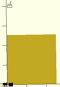

I  cannot specifically answer your 396 unit offset question.
As I understand it, Inkscape places its 0,0 point at the top-left corner
of it's current page size.
Openscad 0,0 is at the bottom-left corner, relative to Inkscape's
current page size. I hope the following illustrations will help.
(I used Inkscape version 1.1.1 for these examples and the following
OpenSCAD code: import ("square.svg", convexity=2);]
If I make an Inkscape page 50.8 mm tall and put a 96px square (path) at
its top, like the next image, it will import to OpenSCAD like the second
image. It is 20.4 units up from the x/y origin. 96 px works out to 1
inch or 25.4 mm y offset from OpenSCAD's origin.
Note that the OpenSCAD rendered square is 25.4 units (mm) above the 0,0
OpenSCAD origin.
If, however, I move the square (carefully down to place it at the bottom
of the page, the OpenSCAD imported square will render at 0.0.

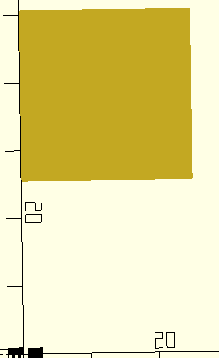

My typical "solution" is to create my desired shape in Inkscape. Then
use Document Properties to set the page size to just include the object
which will then place it so the left-lower corner of the object is at
0.0 in OpenSCAD.

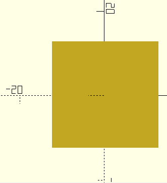

If I want to have the object centered at the origin for easier
manipulation, place the shape to be centered on the lower left corner of
that page in Inkscape. The Inkscape page size really does not matter.
The imported OpenSCAD shape will render at x=0, y=0, z=0. From there, it
is relatively easy to use translate, rotate, etc. to position it (still
needing to use linear_extrude() to get a 3D representation.
