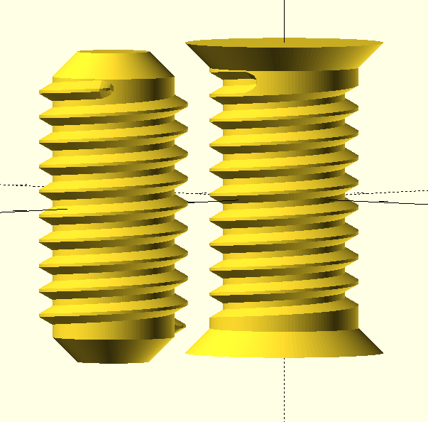

I have now unpacked yesterdays BOSL2-master.zip and removed the older
versions from /home/gene/.local/share/OpenSCAD/libraries,
then copied the unpacked BOSL2-master.zip's contents to the above
libraries path as BOSL2, so all files there are now dated today.
Then I re-arranged the file from the original post, and wrapped it as a
"module test();"
So it now looks like this:
module test(); {     include
</home/gene/.local/share/OpenSCAD/libraries/BOSL2/std.scad>     include
</home/gene/.local/share/OpenSCAD/libraries/BOSL2/threading.scad>
difference()cylinder(h=50, d=16, $fn=150);
translate([0,0,1.5])cylinder(h=32.5, d=12);
translate([0,0,34])threaded_rod(d=12, l=16, pitch=2, internal=false,
bevel=0.5); } test();
But I am still getting this error for an F5:

Gene,
Try moving the include statements above (outside) of the module definition.
Len

That worked, thank you. Is this a required rule?
But I had to modify both the z offset, and the length of the
threaded_rod by quite a bit to get it to project from the cylinder at
both ends, so that line now looks like this:
    #translate([0,0,25])threaded_rod(d=12, l=51, pitch=2,
internal=false, bevel=0.5);
And I don't believe I see any bevel.
Threading is limited to the top by the 2nd cylinder and a bit of Z
tweaking made it clean to the bottom of the hole.
I see now that the line above this one clears the bore below the threads
so the added length of threaded_rod is not needed. The correct Z
translation would work as the OP seems to have a good understanding of
but using exactly the same for both subtractions was part of he error.
So my version with the stretched rod looks like this:
include </home/gene/.local/share/OpenSCAD/libraries/BOSL2/std.scad>
include </home/gene/.local/share/OpenSCAD/libraries/BOSL2/threading.scad>
module test();
        translate([0,0,0])cylinder(h=32.5, d=12);
        translate([0,0,25])threaded_rod(d=12, l=55, pitch=2,
test();
I hope this helps, it sure has me.
In this case, yes.  The OpenSCAD docs say "use <filename> is allowed only
at the top level of a file."
...and BOLS2 color.scad contains a use statement:
color.scad:use <builtins.scad>

Because interior=false, the bevel is the wrong direction.  If you take a
rod and bevel the ends and then subtract that you're going to get a hole
with a little lip at the top.  You need to set inside=true, which reverses
the bevels.  Or you need to set a negative bevel so that it flares outward
so that it bevels the hole.
You can always try making the bevel really big, like how about 4.  You
wouldn't want such a big bevel, but you'll be able to see it!  A bevel on
a threaded rod can be subtle.
Really the threads will come out better if you use the interior argument
correctly.  In fact, I think with interior=false they won't work unless you
run the threads all the way off the end.
include<BOSL2/std.scad>
include<BOSL2/threading.scad>
threaded_rod(d=12, pitch=2, internal=true, l=25, bevel=2);
right(20)threaded_rod(d=12, pitch=2, internal=false, l=25, bevel=2);
