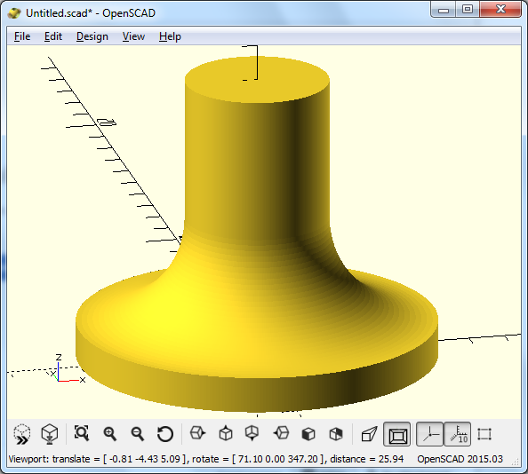

Hello I am pretty new to OpenSCAD and CAD in general, but I am working my way
through a basic stand.
It has three sections, top, middle, and bottom, and the middle section I
have curving between the top and bottom by way of a difference call with the
middle section and a torus around it.
The issue is that no matter what I set $fn to, the middle section doesn't
smooth out. I keep getting flat faces all the way around.
Here is how I am doing it:
startDiam = 37;
endDiam = 15; //diameter at top of stand
flareHeight = 12; //height of middle section
flatHeight = 3;//height of bottom section
topHeight = 10;//height of top section
layerRes = 60;//number of layers that make up middle section
nFaces = 100;//number of faces for cylinders
deltaDiam = (startDiam - endDiam) / layerRes;//change in diameter per layer
in middle section
deltaHeight = flareHeight / layerRes;//height of a layer in the middle
section
module stand()
union()
//bottom stand
cylinder(d = startDiam, h = flatHeight , $fn = nFaces);
    //middle stand
        translate([0,0,flatHeight]){
            hull()
                for(i = [0:layerRes]){
                    translate([0,0,deltaHeight*i]){
                        cylinder(d = startDiam - (deltaDiam* i), h =
deltaHeight, $fn = nFaces);
        translate([0,0,flatHeight + flareHeight]){
            #donut();
    //top stand
    translate([0,0,flatHeight + flareHeight + deltaHeight]){
        cylinder(d = endDiam, h = topHeight, $fn = nFaces);
module donut()
rotate_extrude(){
translate([(startDiam/2)+1,0,0]){
circle(r = flareHeight, $fn = nFaces);
stand();
In the render you can see the green section is not nearly as smooth as the
top and bottom.
http://forum.openscad.org/file/n20524/JgiUOwr.png

Hello Justin.
Maybe you forgot to add $fn to your rotated extrusion?
rotate_extrude($fn = nFaces)
Also, all those 3D hull() are slow. Have you considered working in 2D and
then rotate_extrude everything?

You can set $fn in the rotate_extrude to get more fragments. See
https://en.wikibooks.org/wiki/OpenSCAD_User_Manual/2D_to_3D_Extrusion#Rotate_Extrude

The middle resolution is the resolution of the rotate_extrude, that you
haven't set.
Try with:
module donut()
rotate_extrude($fn=nFaces){
Besides, you can avoid all hull and unions by defining the conic section
using linear_extrude:
    //middle stand
            linear_extrude(height = flareHeight+deltaHeight,
scale=endDiam/startDiam)
circle(r=startDiam/2,$fn=nFaces);
            #donut();
Or even using a simple cylinder instead of a cone trunk:
            cylinder(r=startDiam/2,h=flareHeight+deltaHeight);
            #donut();
But, the best solution to your model would be to define a 2D form whose
revolution with rotate_extrude generates your full stand without any 3D
boolean operation.

A simple example of what is being suggested (design in 2D and rotate
extrude):
rotate_extrude($fn=360)
offset(r=-3,$fn=360)
offset(delta=3)
union()
square([2,8]);
square([5,1]);
