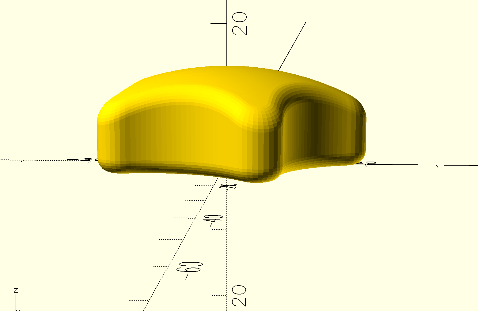

What does NOT look great in my experience is something like the gradual dome top of the knob, which tends to have a very exposed layer line step-structure with very wide and visible steps that I think look and feel pretty bad.  That will be worse the closer you are to flat---I don't know how bad it would look with the model as shown.  I printed a knob to go on my audio amp and my first version had a domed top like shown and I scratched that and went back to flat after I felt the model in hand.
The other thing that does NOT look great is a roundover printed upside down.  That needs to be a chamfer or teardrop for the best result.  So I'd probably do something like this for a flat topped model:

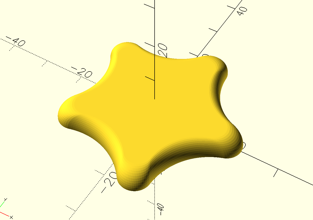

Here's what the knot from the above code looks like from the top and bottom:
<image.png>
<image.png>
Avoiding the lower angle at the bottom by switching to a chamfer will ensure good printing.

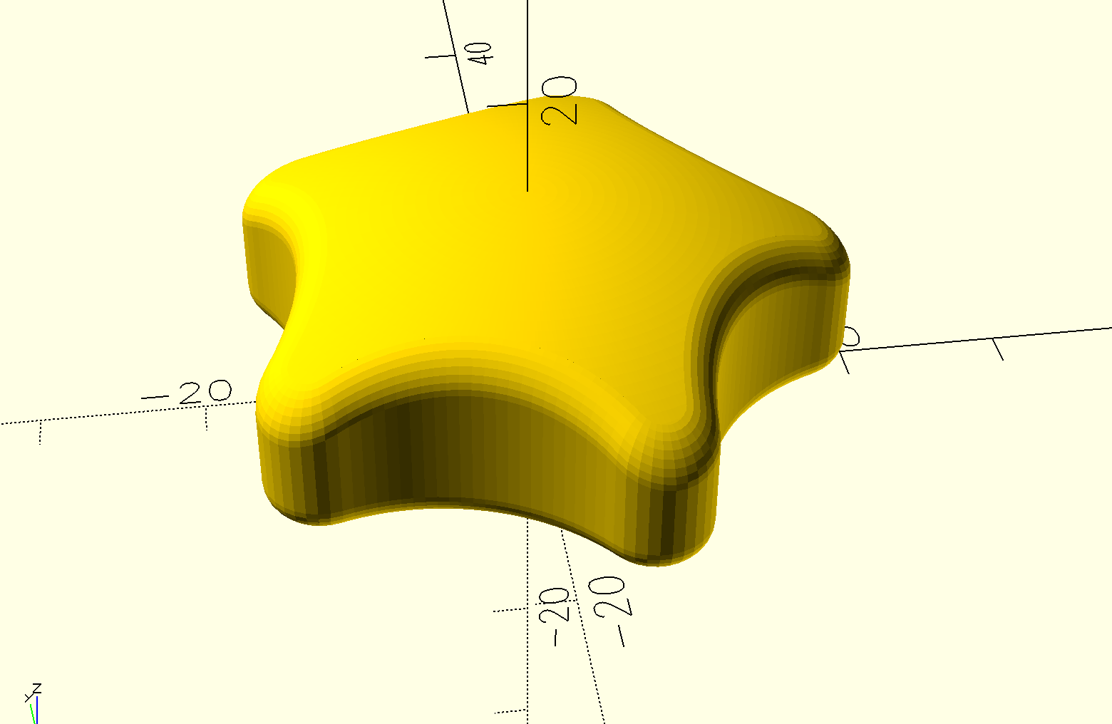

This is related to a question I asked a couple of days ago (problems with not closed mesh) but a different problem. Should I have asked in the old thread anyway?
I create star shaped knobs for hex screws (see https://www.printables.com/model/1116311-parametric-knob-for-hex-nuts-and-allen-screws-knau). The rounded top surface is achieved by subtracting from a large sphere (see prototype code below) and the rounded edges are created with the minkowski sum. Since the sphere must be large for a low rounding it needs a large $fn value (120 currently). Thus, the minkowski sum needs about 80 seconds (M3 CPU) to generate the object with manifold backend.
This is already an optimized version since I create the basic star shape analytically instead of using unions and differences. This way I was able to reduce the computing time by about 80% already.
Does someone here have an idea how I could reduce the computing time even further? The reason: I create a web based configuration tool and would like to provide the stl file in less than ten seconds.

Oh, I see. I never tested with that high values of the arm pitch. That is a stepping problem: The outline of the shape is generated in a for loop. Imagine that a beam turns counterclockwise around the z-axis in the xy plane in steps of one degree. For every step the radius of the outer shape is calculated and the corresponding point (the intersection of the beam and the outline) on the xy plane becomes part of the points array of the polygon forming the outer shape. At the positions you mention a step of one degree leads to a quite large step along the outline because at those positions the "beam" is almost parallel to the outline. If you reduce the step in the for loop from 1 to 0.1 this disappears. But that would lead to huge numbers of faces. So maybe in the future I will compensate for that with smaller steps at certain positions depending on the scalar product of the current outline and the "beam". I understand your comments. This thing has developed its own life, currently going way further than it was intended in the first place, more and more becoming an intellectual game. Nonetheless, many people in my university's fab lab are quite happy I made and shared this. Currently, I learn a lot about analytical geometry (actually re-memorizing things learnt decades ago in school) and about for me so far unknown ways to produce things in OpenSCAD. I could have let it go a long time ago, but the challenge of learning and speeding up the calculation now really appeals to me. Although the calculations may look confusing, it is mainly just the application of the sine and cosine theorems to scalene triangles. > Am 26.12.2024 um 17:57 schrieb Adrian Mariano via Discuss <discuss@lists.openscad.org>: > > Sanding well enough to produce a model that looks good is going to be a ton of work---more work than I would put forth for a model. Casting is obviously a different application, where appearance doesn't matter. But if you're planning to offer a generator to people, I would guess most people are in my camp: no interest in a bunch of post processing of the model. If I had a project with 8 knobs it would loom even larger as a nuisance. What would make sense for this is solvent smoothing...but I don't do that either. (Not really feasible with PLA.) > > Building structures analytically is generally very fast if you have a reasonably straight forward analytic approach. I can't quite understand your method to know what the result would look like---definitely post your final result. > > Regarding the corners, it's not super visible in the model as you gave it, but when I changed armPitch to 3 I got this<image.png> > > > The corner is very clear here. So if your math is producing a corner when armPitch=3 then most likely there is exactly one value of armPitch (other parameters held fixed) that generates a model where the tangents match and there is no corner. I didn't try to understand your code enough to know what's going on there. The corner is more subtle with less extreme parameter choices, but may be tactile even if not obvious in the model on screen. > > At armPitch of 3.2 there are now two obvious corners: > > <image.png> > > And these parameter values seem plausible use cases, not crazy outlier values, so if you're providing a parameterized model it seems like they should work. > > On Thu, Dec 26, 2024 at 11:26 AM Thomas Richter via Discuss <discuss@lists.openscad.org> wrote: > Thank you for your insights. I get good results printing the rounded surface upside down _and sanding_ it. You are right about the distance of the top layers, this tends to be visible the closer it gets to flat, but it's fine after sanding. Nonetheless, if you take a look at printables, there are also flat versions of the knobs. > > I don't just print the knobs but use the sanded prints to create molds for brass castings. > > The tangents of the tips and the notches actually match in both the version on printables (made with boolean operations) and the analytical version posted in this thread. The small edgy stripes between tips and notches are subject to low $fn values of the cylinders when creating the knob with boolean operations. With an analytically generated outline they don't appear at all. Could you please elaborate on the problems you experienced? > > I make good progress creating the rounded top analytically. I generate a polyhedron from several layers of outlines with the radius changing with the cosine of the current step's angle. It is fast as hell, even with 360 steps around the edge it takes less than 50 milliseconds for two layers and I expect to be fine with about ten layers for the rounded edge. I can post the solution here later if someone is interested. > > One interesting thing I noticed with the solution I posted in this thread are strangely shaped faces at the rounded edge after doing the minkowski. The Prusa Slicer finds 20 errors in the resulting stl. This will also disappear with the analytical solution. > > > > Am 26.12.2024 um 16:03 schrieb Adrian Mariano via Discuss <discuss@lists.openscad.org>: > > > > I'm not sure what Ray has against rounded edges. I use them all the time and think they look and feel great in my FDM printed models. > > > > What does NOT look great in my experience is something like the gradual dome top of the knob, which tends to have a very exposed layer line step-structure with very wide and visible steps that I think look and feel pretty bad. That will be worse the closer you are to flat---I don't know how bad it would look with the model as shown. I printed a knob to go on my audio amp and my first version had a domed top like shown and I scratched that and went back to flat after I felt the model in hand. > > > > The other thing that does NOT look great is a roundover printed upside down. That needs to be a chamfer or teardrop for the best result. So I'd probably do something like this for a flat topped model: > > > > include<BOSL2/std.scad> > > include<BOSL2/rounding.scad> > > offset_sweep(deduplicate(points,closed=true), h=20, bot=os_teardrop(r=2), top=os_circle(r=2),steps=9); > > > > to get that effect. There is another thing I'd probably try to fix, which is the corners where the tip circles meet the notch circles. For a truly beautiful knob the tangents should match so that you don't have corners there. > > > > Oh, and one other thing that will make this faster no matter how you proceed is to stop using so many points. The smallest facet is 0.22 mm in the posted version. That's unnecessarily small. > > > > I don't see an easy way to create the original shape using an analytic method. You'd need to form a grid over the top of the knob to form the polyhedral face of the top, and that seems pretty difficult to do. > > > > Here's what the knot from the above code looks like from the top and bottom: > > > > <image.png> > > > > <image.png> > > Avoiding the lower angle at the bottom by switching to a chamfer will ensure good printing. > > > > On Thu, Dec 26, 2024 at 7:21 AM Raymond West via Discuss <discuss@lists.openscad.org> wrote: > > If the knob is to be 3d fdm printed by others, then the rounded edges will look awful. Minkowski is slow, especially if $fn is large. I would suggest a redesign of the knob. I posted on here, a few weeks ago (re: bad children) some simple bevel modules. (They sliced at 0.1mm intervals, but that and the profile could be varied). It gives much faster results than using Minkowski. Basically, you could draw the profile of the knob in 2d, linear extrude it to the desired thickness, then apply the bevel/rounding modules. > > On 26/12/2024 08:12, pca006132 via Discuss wrote: > >> Another way would be to do the convex decomposition by yourself, I think it can be split into 5 convex components? > >> > >> On Thu, Dec 26, 2024, 4:07 PM Chun Kit LAM <john.lck40@gmail.com> wrote: > >> The slowness is really in the CGAL convex decomposition code path, and > >> sadly there is no plan to make a faster one for now. > >> > >> If you want this to be fast, the best way might be to do it > >> analytically, considering you already computed the knob outline > >> analytically, it may not be that hard. > >> > >> On 12/26/24 15:53, Thomas Richter via Discuss wrote: > >> > This is related to a question I asked a couple of days ago (problems with not closed mesh) but a different problem. Should I have asked in the old thread anyway? > >> > > >> > I create star shaped knobs for hex screws (see https://www.printables.com/model/1116311-parametric-knob-for-hex-nuts-and-allen-screws-knau). The rounded top surface is achieved by subtracting from a large sphere (see prototype code below) and the rounded edges are created with the minkowski sum. Since the sphere must be large for a low rounding it needs a large $fn value (120 currently). Thus, the minkowski sum needs about 80 seconds (M3 CPU) to generate the object with manifold backend. > >> > > >> > This is already an optimized version since I create the basic star shape analytically instead of using unions and differences. This way I was able to reduce the computing time by about 80% already. > >> > > >> > Does someone here have an idea how I could reduce the computing time even further? The reason: I create a web based configuration tool and would like to provide the stl file in less than ten seconds. > >> > > >> > /** > >> > * prototype code > >> > */ > >> > ARMS = 5; > >> > > >> > // knobDiameter > >> > kd = 40; > >> > rKnob = kd / 2; > >> > // armPitch > >> > ap = 2; > >> > // notchRatio > >> > nr = 3; > >> > > >> > // radius of the arm circles > >> > rK = PI * rKnob / ((ap + 1) * ARMS + PI); > >> > // radius of the notch circles > >> > rN = nr * rK; > >> > > >> > // radius of the circle to place the arms (rbk) > >> > rPosK = rKnob - rK; > >> > > >> > // angle between arm and notch (360 / ARMS / 2) > >> > alpha = 180 / ARMS; > >> > > >> > // angle between center of knob, center of notch, center of arm > >> > gamma = asin(sin(alpha) * rPosK / (rN + rK)); > >> > > >> > // angle between center of knob, center of arm, center of notch > >> > beta = 180 - alpha - gamma; > >> > > >> > // radius of the circle to place the notches (rbn) > >> > rPosN = abs(rPosK * sin(beta) / sin(gamma)); > >> > > >> > // radius of the knob's core: distance from center to touch point of arm and notch (rc) > >> > rCore = sqrt(rPosK^2 + rK^2 - 2 * rPosK * rK * cos(beta)); > >> > > >> > // angle to touch point > >> > alphaC = asin(rK * sin(beta) / rCore); > >> > > >> > armAngle = 360 / ARMS; > >> > > >> > points = [ > >> > > >> > for (phi = [0: 1: 360]) > >> > let (arm = floor(phi / armAngle)) > >> > let (phiTemp = phi - (arm * armAngle)) > >> > // only half of an arm is uniquely defined, the rest can be determined > >> > // by rotation and mirroring > >> > let (phiNorm = phiTemp > armAngle / 2 > >> > ? armAngle - phiTemp > >> > : phiTemp) > >> > let (rx = abs(phiNorm) < 1e-6 > >> > ? rKnob > >> > : abs(phiNorm - armAngle / 2) < 1e-6 > >> > ? rPosN - rN > >> > : phiNorm < alphaC > >> > ? > >> > let (gamma2 = asin(rPosK * sin(phiNorm) / rK)) > >> > let (beta2 = 180 - phiNorm - gamma2) > >> > rK * sin(beta2) / sin(phiNorm) > >> > : > >> > let (delta = alpha - phiNorm) > >> > let (epsilon = 180 - asin(rPosN * sin(delta) / rN)) > >> > let (rho = 180 - delta - epsilon) > >> > rN * sin(rho) / sin(delta) > >> > ) > >> > > >> > [rx * cos(phi), rx * sin(phi)] > >> > ]; > >> > > >> > // quick and dirty prototype for testing > >> > minkowski() { > >> > sphere(2, $fn = 36); > >> > > >> > difference() { > >> > translate([0, 0, -30]) sphere(d = 99, $fn = 120); > >> > > >> > difference () { > >> > translate([0, 0, -35]) cube(110, center = true); > >> > > >> > linear_extrude(20) polygon(points); > >> > } > >> > } > >> > } > >> > _______________________________________________ > >> > OpenSCAD mailing list > >> > To unsubscribe send an email to discuss-leave@lists.openscad.org > >> > >> _______________________________________________ > >> OpenSCAD mailing list > >> To unsubscribe send an email to discuss-leave@lists.openscad.org > >> > > _______________________________________________ > > OpenSCAD mailing list > > To unsubscribe send an email to discuss-leave@lists.openscad.org > > _______________________________________________ > > OpenSCAD mailing list > > To unsubscribe send an email to discuss-leave@lists.openscad.org > _______________________________________________ > OpenSCAD mailing list > To unsubscribe send an email to discuss-leave@lists.openscad.org > _______________________________________________ > OpenSCAD mailing list > To unsubscribe send an email to discuss-leave@lists.openscad.org
down.

You are mating two curves, one when phiNorm<alphaC and one when
phiNorm>=alphaC.  Have you designed them to have matching tangents?
But to eliminate the visual corners without going crazy on sample rate I
think you need to change your sampling method to sample the two arcs
separately and then join them.  That way the arcs can be sampled uniformly
over their length instead of sampled based on the global polar coordinate
and the sample rate will be appropriate for the curvature of each part.
This will fix the sampled problems created by using global polar
coordinates, which obviously doesn't work properly for knobs with thinner
or concave arms.  The code for what I propose is actually probably simpler
if the design is indeed two circular arcs.  (I can't tell on brief
inspection what that code is doing.)
<image.png>
should work.
bottom:
<image.png>
<image.png>
  • prototype code
    ARMS = 5;
// knobDiameter
kd = 40;
rKnob = kd / 2;
// armPitch
ap = 2;
// notchRatio
nr = 3;
rN = nr * rK;
rPosK = rKnob - rK;
alpha = 180 / ARMS;
points = [
: phiTemp)
? rKnob
? rPosN - rN
: phiNorm < alphaC
minkowski() {
      difference () {
angleC is the polar(!) angle where the two circles touch: the circle that makes the tip / arm and the circle that makes the notch. So, they are tangent at that position. I need to switch the calculation method there because they have different radii and different orientiation (the notch circles' center ist outside the knob, the arms' is inside). A couple days ago I had already made a solution using arcs instead of polar coordinates in Javascript and I will probably adapt this solution to OpenSCAD. It will make this problem disappear as you recommend. But currently I figure out the geometry of the top surface. Rounded edge works analytically already, rounded top surface is still to come. I have attached a screenshot of the current prototype. This renders in 87 milliseconds. I am very grateful for the help from all of you. > Am 26.12.2024 um 20:02 schrieb Adrian Mariano via Discuss <discuss@lists.openscad.org>: > > I tried jacking up the sample rate and indeed it looks smoother, but to my eye it appears that there is still a corner. But maybe I'm imagining it. It's a pretty subtle corner if it's real, so it probably doesn't matter. You are mating two curves, one when phiNorm<alphaC and one when phiNorm>=alphaC. Have you designed them to have matching tangents? > > But to eliminate the visual corners without going crazy on sample rate I think you need to change your sampling method to sample the two arcs separately and then join them. That way the arcs can be sampled uniformly over their length instead of sampled based on the global polar coordinate and the sample rate will be appropriate for the curvature of each part. This will fix the sampled problems created by using global polar coordinates, which obviously doesn't work properly for knobs with thinner or concave arms. The code for what I propose is actually probably simpler if the design is indeed two circular arcs. (I can't tell on brief inspection what that code is doing.) > > > > > > > > On Thu, Dec 26, 2024 at 12:31 PM Thomas Richter via Discuss <discuss@lists.openscad.org> wrote: > Oh, I see. I never tested with that high values of the arm pitch. That is a stepping problem: The outline of the shape is generated in a for loop. Imagine that a beam turns counterclockwise around the z-axis in the xy plane in steps of one degree. For every step the radius of the outer shape is calculated and the corresponding point (the intersection of the beam and the outline) on the xy plane becomes part of the points array of the polygon forming the outer shape. At the positions you mention a step of one degree leads to a quite large step along the outline because at those positions the "beam" is almost parallel to the outline. If you reduce the step in the for loop from 1 to 0.1 this disappears. But that would lead to huge numbers of faces. So maybe in the future I will compensate for that with smaller steps at certain positions depending on the scalar product of the current outline and the "beam". > > I understand your comments. This thing has developed its own life, currently going way further than it was intended in the first place, more and more becoming an intellectual game. Nonetheless, many people in my university's fab lab are quite happy I made and shared this. > > Currently, I learn a lot about analytical geometry (actually re-memorizing things learnt decades ago in school) and about for me so far unknown ways to produce things in OpenSCAD. I could have let it go a long time ago, but the challenge of learning and speeding up the calculation now really appeals to me. > > Although the calculations may look confusing, it is mainly just the application of the sine and cosine theorems to scalene triangles. > > > Am 26.12.2024 um 17:57 schrieb Adrian Mariano via Discuss <discuss@lists.openscad.org>: > > > > Sanding well enough to produce a model that looks good is going to be a ton of work---more work than I would put forth for a model. Casting is obviously a different application, where appearance doesn't matter. But if you're planning to offer a generator to people, I would guess most people are in my camp: no interest in a bunch of post processing of the model. If I had a project with 8 knobs it would loom even larger as a nuisance. What would make sense for this is solvent smoothing...but I don't do that either. (Not really feasible with PLA.) > > > > Building structures analytically is generally very fast if you have a reasonably straight forward analytic approach. I can't quite understand your method to know what the result would look like---definitely post your final result. > > > > Regarding the corners, it's not super visible in the model as you gave it, but when I changed armPitch to 3 I got this<image.png> > > > > > > The corner is very clear here. So if your math is producing a corner when armPitch=3 then most likely there is exactly one value of armPitch (other parameters held fixed) that generates a model where the tangents match and there is no corner. I didn't try to understand your code enough to know what's going on there. The corner is more subtle with less extreme parameter choices, but may be tactile even if not obvious in the model on screen. > > > > At armPitch of 3.2 there are now two obvious corners: > > > > <image.png> > > > > And these parameter values seem plausible use cases, not crazy outlier values, so if you're providing a parameterized model it seems like they should work. > > > > On Thu, Dec 26, 2024 at 11:26 AM Thomas Richter via Discuss <discuss@lists.openscad.org> wrote: > > Thank you for your insights. I get good results printing the rounded surface upside down _and sanding_ it. You are right about the distance of the top layers, this tends to be visible the closer it gets to flat, but it's fine after sanding. Nonetheless, if you take a look at printables, there are also flat versions of the knobs. > > > > I don't just print the knobs but use the sanded prints to create molds for brass castings. > > > > The tangents of the tips and the notches actually match in both the version on printables (made with boolean operations) and the analytical version posted in this thread. The small edgy stripes between tips and notches are subject to low $fn values of the cylinders when creating the knob with boolean operations. With an analytically generated outline they don't appear at all. Could you please elaborate on the problems you experienced? > > > > I make good progress creating the rounded top analytically. I generate a polyhedron from several layers of outlines with the radius changing with the cosine of the current step's angle. It is fast as hell, even with 360 steps around the edge it takes less than 50 milliseconds for two layers and I expect to be fine with about ten layers for the rounded edge. I can post the solution here later if someone is interested. > > > > One interesting thing I noticed with the solution I posted in this thread are strangely shaped faces at the rounded edge after doing the minkowski. The Prusa Slicer finds 20 errors in the resulting stl. This will also disappear with the analytical solution. > > > > > > > Am 26.12.2024 um 16:03 schrieb Adrian Mariano via Discuss <discuss@lists.openscad.org>: > > > > > > I'm not sure what Ray has against rounded edges. I use them all the time and think they look and feel great in my FDM printed models. > > > > > > What does NOT look great in my experience is something like the gradual dome top of the knob, which tends to have a very exposed layer line step-structure with very wide and visible steps that I think look and feel pretty bad. That will be worse the closer you are to flat---I don't know how bad it would look with the model as shown. I printed a knob to go on my audio amp and my first version had a domed top like shown and I scratched that and went back to flat after I felt the model in hand. > > > > > > The other thing that does NOT look great is a roundover printed upside down. That needs to be a chamfer or teardrop for the best result. So I'd probably do something like this for a flat topped model: > > > > > > include<BOSL2/std.scad> > > > include<BOSL2/rounding.scad> > > > offset_sweep(deduplicate(points,closed=true), h=20, bot=os_teardrop(r=2), top=os_circle(r=2),steps=9); > > > > > > to get that effect. There is another thing I'd probably try to fix, which is the corners where the tip circles meet the notch circles. For a truly beautiful knob the tangents should match so that you don't have corners there. > > > > > > Oh, and one other thing that will make this faster no matter how you proceed is to stop using so many points. The smallest facet is 0.22 mm in the posted version. That's unnecessarily small. > > > > > > I don't see an easy way to create the original shape using an analytic method. You'd need to form a grid over the top of the knob to form the polyhedral face of the top, and that seems pretty difficult to do. > > > > > > Here's what the knot from the above code looks like from the top and bottom: > > > > > > <image.png> > > > > > > <image.png> > > > Avoiding the lower angle at the bottom by switching to a chamfer will ensure good printing. > > > > > > On Thu, Dec 26, 2024 at 7:21 AM Raymond West via Discuss <discuss@lists.openscad.org> wrote: > > > If the knob is to be 3d fdm printed by others, then the rounded edges will look awful. Minkowski is slow, especially if $fn is large. I would suggest a redesign of the knob. I posted on here, a few weeks ago (re: bad children) some simple bevel modules. (They sliced at 0.1mm intervals, but that and the profile could be varied). It gives much faster results than using Minkowski. Basically, you could draw the profile of the knob in 2d, linear extrude it to the desired thickness, then apply the bevel/rounding modules. > > > On 26/12/2024 08:12, pca006132 via Discuss wrote: > > >> Another way would be to do the convex decomposition by yourself, I think it can be split into 5 convex components? > > >> > > >> On Thu, Dec 26, 2024, 4:07 PM Chun Kit LAM <john.lck40@gmail.com> wrote: > > >> The slowness is really in the CGAL convex decomposition code path, and > > >> sadly there is no plan to make a faster one for now. > > >> > > >> If you want this to be fast, the best way might be to do it > > >> analytically, considering you already computed the knob outline > > >> analytically, it may not be that hard. > > >> > > >> On 12/26/24 15:53, Thomas Richter via Discuss wrote: > > >> > This is related to a question I asked a couple of days ago (problems with not closed mesh) but a different problem. Should I have asked in the old thread anyway? > > >> > > > >> > I create star shaped knobs for hex screws (see https://www.printables.com/model/1116311-parametric-knob-for-hex-nuts-and-allen-screws-knau). The rounded top surface is achieved by subtracting from a large sphere (see prototype code below) and the rounded edges are created with the minkowski sum. Since the sphere must be large for a low rounding it needs a large $fn value (120 currently). Thus, the minkowski sum needs about 80 seconds (M3 CPU) to generate the object with manifold backend. > > >> > > > >> > This is already an optimized version since I create the basic star shape analytically instead of using unions and differences. This way I was able to reduce the computing time by about 80% already. > > >> > > > >> > Does someone here have an idea how I could reduce the computing time even further? The reason: I create a web based configuration tool and would like to provide the stl file in less than ten seconds. > > >> > > > >> > /** > > >> > * prototype code > > >> > */ > > >> > ARMS = 5; > > >> > > > >> > // knobDiameter > > >> > kd = 40; > > >> > rKnob = kd / 2; > > >> > // armPitch > > >> > ap = 2; > > >> > // notchRatio > > >> > nr = 3; > > >> > > > >> > // radius of the arm circles > > >> > rK = PI * rKnob / ((ap + 1) * ARMS + PI); > > >> > // radius of the notch circles > > >> > rN = nr * rK; > > >> > > > >> > // radius of the circle to place the arms (rbk) > > >> > rPosK = rKnob - rK; > > >> > > > >> > // angle between arm and notch (360 / ARMS / 2) > > >> > alpha = 180 / ARMS; > > >> > > > >> > // angle between center of knob, center of notch, center of arm > > >> > gamma = asin(sin(alpha) * rPosK / (rN + rK)); > > >> > > > >> > // angle between center of knob, center of arm, center of notch > > >> > beta = 180 - alpha - gamma; > > >> > > > >> > // radius of the circle to place the notches (rbn) > > >> > rPosN = abs(rPosK * sin(beta) / sin(gamma)); > > >> > > > >> > // radius of the knob's core: distance from center to touch point of arm and notch (rc) > > >> > rCore = sqrt(rPosK^2 + rK^2 - 2 * rPosK * rK * cos(beta)); > > >> > > > >> > // angle to touch point > > >> > alphaC = asin(rK * sin(beta) / rCore); > > >> > > > >> > armAngle = 360 / ARMS; > > >> > > > >> > points = [ > > >> > > > >> > for (phi = [0: 1: 360]) > > >> > let (arm = floor(phi / armAngle)) > > >> > let (phiTemp = phi - (arm * armAngle)) > > >> > // only half of an arm is uniquely defined, the rest can be determined > > >> > // by rotation and mirroring > > >> > let (phiNorm = phiTemp > armAngle / 2 > > >> > ? armAngle - phiTemp > > >> > : phiTemp) > > >> > let (rx = abs(phiNorm) < 1e-6 > > >> > ? rKnob > > >> > : abs(phiNorm - armAngle / 2) < 1e-6 > > >> > ? rPosN - rN > > >> > : phiNorm < alphaC > > >> > ? > > >> > let (gamma2 = asin(rPosK * sin(phiNorm) / rK)) > > >> > let (beta2 = 180 - phiNorm - gamma2) > > >> > rK * sin(beta2) / sin(phiNorm) > > >> > : > > >> > let (delta = alpha - phiNorm) > > >> > let (epsilon = 180 - asin(rPosN * sin(delta) / rN)) > > >> > let (rho = 180 - delta - epsilon) > > >> > rN * sin(rho) / sin(delta) > > >> > ) > > >> > > > >> > [rx * cos(phi), rx * sin(phi)] > > >> > ]; > > >> > > > >> > // quick and dirty prototype for testing > > >> > minkowski() { > > >> > sphere(2, $fn = 36); > > >> > > > >> > difference() { > > >> > translate([0, 0, -30]) sphere(d = 99, $fn = 120); > > >> > > > >> > difference () { > > >> > translate([0, 0, -35]) cube(110, center = true); > > >> > > > >> > linear_extrude(20) polygon(points); > > >> > } > > >> > } > > >> > } > > >> > _______________________________________________ > > >> > OpenSCAD mailing list > > >> > To unsubscribe send an email to discuss-leave@lists.openscad.org > > >> > > >> _______________________________________________ > > >> OpenSCAD mailing list > > >> To unsubscribe send an email to discuss-leave@lists.openscad.org > > >> > > > _______________________________________________ > > > OpenSCAD mailing list > > > To unsubscribe send an email to discuss-leave@lists.openscad.org > > > _______________________________________________ > > > OpenSCAD mailing list > > > To unsubscribe send an email to discuss-leave@lists.openscad.org > > _______________________________________________ > > OpenSCAD mailing list > > To unsubscribe send an email to discuss-leave@lists.openscad.org > > _______________________________________________ > > OpenSCAD mailing list > > To unsubscribe send an email to discuss-leave@lists.openscad.org > _______________________________________________ > OpenSCAD mailing list > To unsubscribe send an email to discuss-leave@lists.openscad.org > _______________________________________________ > OpenSCAD mailing list > To unsubscribe send an email to discuss-leave@lists.openscad.org

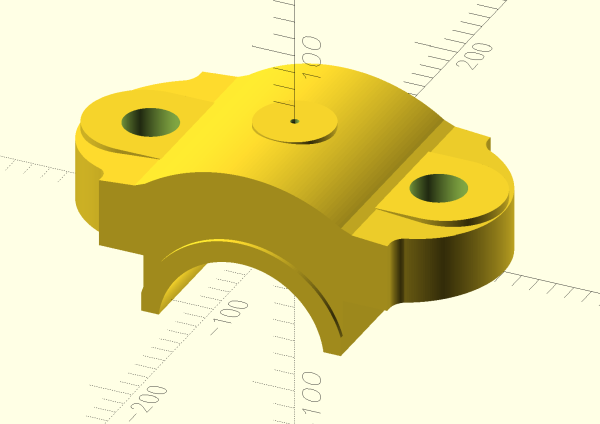

It's the rounding of edges where layer lines will show, or where
overhangs are too great. A bevel works far better in those cases, at any
size. Having to remember to set adaptive in the slicer, and the fun an
games if the roundings are at different layers, is not something I want
to do too often. I do not notice much difference in rounding over the
top of say a 3mm wide strip, compared to bevelling it, and bevels are
easier to create, at least for me. but, I'm mainly concerned with
functional prints, use a 0.6mm nozzle, print as fast as I can, with
thick layer lines.
This largish replica of a cast iron bearing cap, has a smooth curved top
surface. However, it printed flawlessly on it's side, with just a few
supports for the holes (which were oversized for the one inch bolts),
and most of the bottom (side in this view). Printing it 'right way up'
would have given a right messy result at the part that you would
immediately see. Printing with 'fuzzy skin' can also be helpful to hide
layer lines, but slows the process down.

Fri, Dec 27, 2024 4:29 PM
Although I have no requirement, having done similar before, Thomas's
original post and other comments has dragged me again into the rabbit
hole of 'scalloped knobs'. Basically, it is a disc, with circles added
around the circumference and other circles subtracted, giving a sort of
sine wave around the circumference. If both sets of circles are the same
size, then it will simplify the code. I drew something out in openscad,
and then thought,  'why stick with 5 scallops?', so I decided to go for
any number between 3 and 9 inclusive.
By eyeballing the location of the circles, it was pretty obvious there
was some sort of geometric formula between the relationship of the
various diameters and positions. Basically straight forward Pythagoras,
but there are quite a few triangles involved. Anyway, it was relatively
quick to eyeball the values.
Having done that, I asked ChatGPT to  generate the graphs and calculate
the formula, based on my eyeballed values. The code becomes much more
succinct, and the result is good enough for all practical purposes. It
falls apart for more than nine or ten scallops, but I'm pretty sure that
a few extra values, say for 30, 40 would improve the accuracy.
If it is any use to anyone, or of the slightest interest, I've attached
the script, including my commented eyeballed values, which in some
instances is better than the calculated (the values for md were more
difficult to for me to see, so errors will skew the graph).  In the
script, the 'diameter' is approxi'mate, you only need to alter that and
the value for 's'. (if you add 0.7 to the integer value for s, you also
get a sort of index pointer😉)

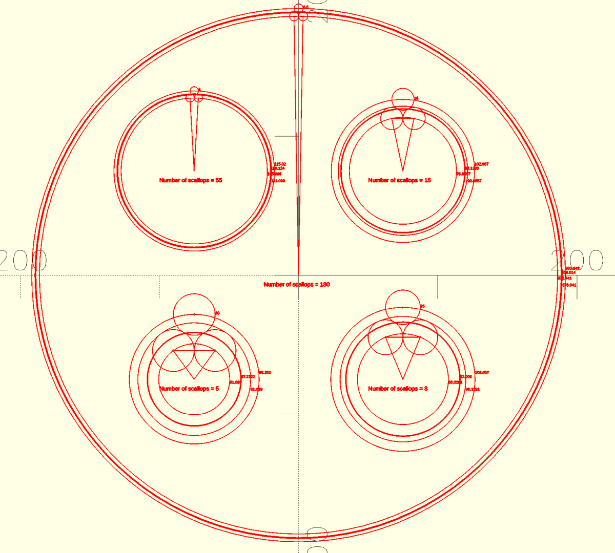

Mon, Dec 30, 2024 6:14 PM
The image shows the diameters for various circles involved in producing
scalloped circles. I gave up in trying to generate  a simple formula, as
such, and have derived the values from basic geometry. It was easiest to
view that in line drawings, so I wrote some generic modules to create
lines and basic outline shapes in openscad script. Having done that I
was able to create 2d line drawings, which made it easier to see the
relationship between the various components.
The result I achieved, works for any number of scallops, above one, up
to the limits of floating point calculations,  I guess.
The image shows the construction lines and needed dimensions for five
scalloped circles, the only values need to generate them is the number
of scallops, and the diameter of the scallops. The concentric circles
are those needed for generating the shape. The thicker line represents
the base circle. There will then be a number of circles of the same
diameter as the scallop diameter placed with their centres on the inner
circle, and unioned to that base circle There are also circles placed on
the circumference of the outer circle, and differenced. That gives a
circle with a scalloped edge, with smooth transitions. The third circle,
from the centre, is the 'diameter' of the final shape.
> The image shows the diameters for various circles involved in producing scalloped circles. I gave up in trying to generate  a simple formula, as such, and have derived the values from basic geometry. It was easiest to view that in line drawings, so I wrote some generic modules to create lines and basic outline shapes in openscad script. Having done that I was able to create 2d line drawings, which made it easier to see the relationship between the various components. The result I achieved, works for any number of scallops, above one, up to the limits of floating point calculations,  I guess. The image shows the construction lines and needed dimensions for five scalloped circles, the only values need to generate them is the number of scallops, and the diameter of the scallops. The concentric circles are those needed for generating the shape. The thicker line represents the base circle. There will then be a number of circles of the same diameter as the scallop diameter placed with their centres on the inner circle, and unioned to that base circle There are also circles placed on the circumference of the outer circle, and differenced. That gives a circle with a scalloped edge, with smooth transitions. The third circle, from the centre, is the 'diameter' of the final shape.

Mon, Jan 6, 2025 1:03 AM
There is a formula, but a bit tricky, as I said, a number of triangles
involved. The 2d line drawing I posted a few days ago gave an indication
of the construction of the basic shape. I completed it for the simple
case, where the scallop diameter equals the diameter of the 'blobs'
lying between them.
There are only four parameters required for the basic shape, for example
  • calculate(s=5,knob=48,fil=6,thick=15)  (s is number of scallops, knob
    is overall diameter, fil is radius of fillet (top and bottom), thick is
    total thickness.) It works fine now, from one scallop up to whatever. (I
    argued with myself wrt one scallop, whether or not it should produce  no
    knob, but I settled on a simple circular one - if the scallop size was
    smaller, then there would be no argument 🙂).
The more scallops, or the larger the knob, the slower the Minkowski. I
modified my bevel script, to do round-overs, I think that would be
quicker, than Minkowski, but would depend on the radius of the
round-overs. (The above values for 'calculate' takes less than ten
seconds to calculate using manifold, and 25 seconds for 25 scallops,
both using Minkowski.)
 If there are different radii for the scallops compared to the 'blobs',
then the triangles between the centres are no longer equilateral, but
Isosceles, which makes the calculations a bit different, but not much
more so,  I've not bothered with that, although it would be the generic
formula, it would introduce a couple more more parameters, unnecessary
choices when none need to made if all we are concerned with are generic
scalloped knobs for fdm printing.
