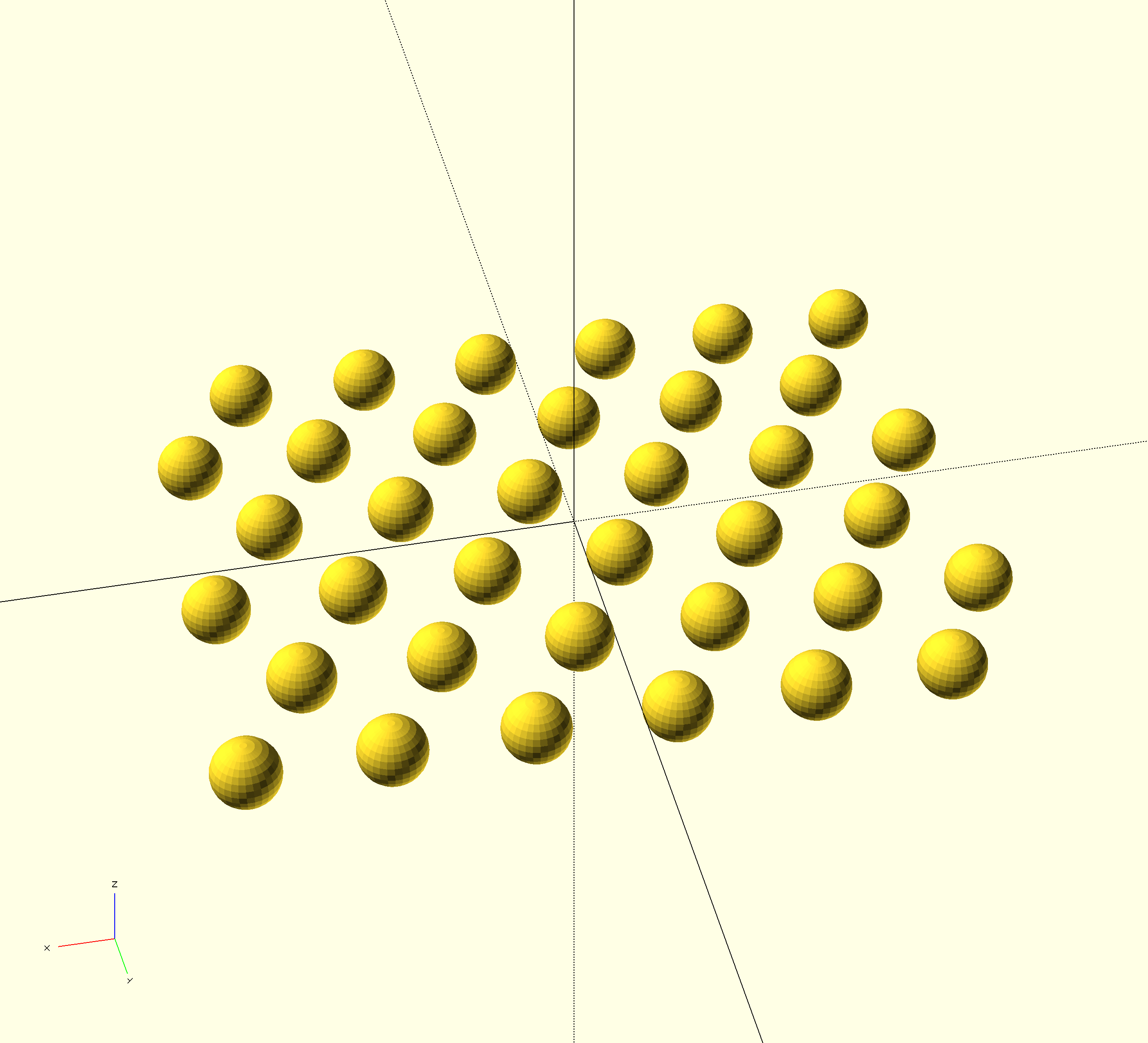

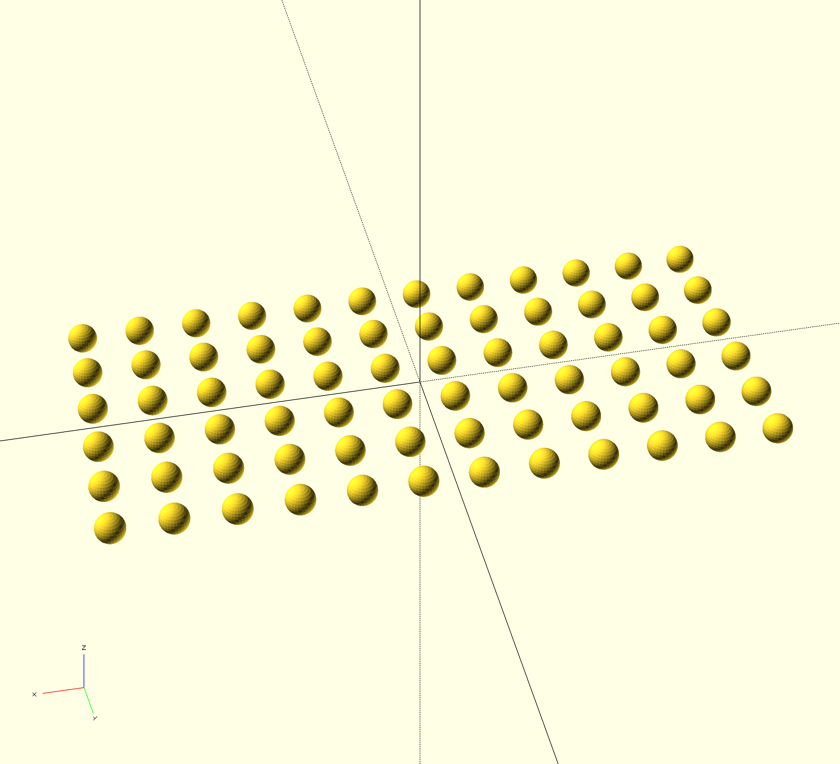

I’m working through the distributors tutorial for BOSL2.
grid_copies(20, n=[12,6], stagger=false) sphere(d=10);
produces
While
grid_copies(20, n=[12,6], stagger=true) sphere(d=10);
produces
It seems like half the objects are missing, or am I missing something?
Mark

Tue, Sep 22, 2026 12:18 AM
If you look, there are 12 unique columns and 6 rows in both un-staggered and staggered forms.  When you stagger each row halfway it ends up doubling the number of effective columns.  I seem to recall that there was some argument a number of years ago about whether the columns should be counted that way or not, and I got talked around to counting it this way.  So, it's behaving as intended.  At this point it'd break things if we changed it.
