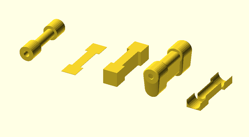

@clothbot strategy may be nicely implemented without any extension to the
last OpenSCAD version.
part_height = 50;
module up_hull(h){
minkowski(){
cylinder(r1=0,r2=h/100,h=h);
module support_mask(ph){
render(convexity=10)
linear_extrude(height=ph)
projection(cut=false)
up_hull(ph)
render(convexity = 4) part();
translate([150,0,0]) projection(cut=false) part();
translate([300,0,0]) linear_extrude(height=part_height)
translate([450,0,0]) up_hull(part_height) part();
translate([600,0,0]) support_mask(part_height) part();

@clothbot strategy may be nicely implemented without any extension to the last OpenSCAD version. ​ ​ part_height = 50; module up_hull(h){ minkowski(){ children(); cylinder(r1=0,r2=h/100,h=h); } } module support_mask(ph){ render(convexity=10) difference() { linear_extrude(height=ph) projection(cut=false) children(); up_hull(ph) children(); } } render(convexity = 4) part(); translate([150,0,0]) projection(cut=false) part(); translate([300,0,0]) linear_extrude(height=part_height) projection(cut=false) part(); translate([450,0,0]) up_hull(part_height) part(); translate([600,0,0]) support_mask(part_height) part(); 2016-03-11 20:23 GMT-03:00 Neon22 <mschafer@wireframe.biz>: > @clothbot - that is a very nice solution. looking fwd to it... > > > > -- > View this message in context: > http://forum.openscad.org/semi-on-topic-print-speed-optimized-sinus-support-material-integration-interface-possible-tp16383p16424.html > Sent from the OpenSCAD mailing list archive at Nabble.com. > > _______________________________________________ > OpenSCAD mailing list > Discuss@lists.openscad.org > http://lists.openscad.org/mailman/listinfo/discuss_lists.openscad.org >

Ronaldo nice indeed,
but how would  you implement a continuous  sinus form?
any cut through a pre-made sinus filed block will produce many
discontinuities which will slowdown the printing process  a lot.
there is no way i can think of of joining these together again in scad,
many slow prints where my support was way slower than slic3rs, and
inability to query existing geometry  were what made me turn to javascript.
it was not an easy decision.
actually i can see this this approach as a perfect complement to a an
external sinus tool.
i will just have to export the step#2 as svg,fill it with sinus with the
external tool (or half-circle which might turn out to be even faster)
then extrude the result and cut it like  your last form
Peter

The following code will create a box filled with cosine support. CGAL
rendering is almost instantaneous.
Is it what you were asking for?
http://forum.openscad.org/file/n16438/sinecomb.png
supportblock();
module supportblock(rows = 10, cols = 10, box = [100, 100, 10], thickness
= .1)
amplitude = box[1]/rows/2;
wavelength = box[0]/cols PI;
linear_extrude(height = box[2])
for(i = [0:rows-1])
Ty(i
amplitude*2)
polygon(points = sine(cols, amplitude, wavelength, i%2, thickness));
function sine(periods, amplitude, wavelength, mode, thickness = .01) =
let(amp = amplitude-thickness/1.9)
concat(
[for(i=[0:10:360periods]) [i/wavelength, ampcos(i+mode180)]],
[for(i=[360
periods:-1:0]) [i/wavelength,
ampcos(i+mode180)+thickness]]);
